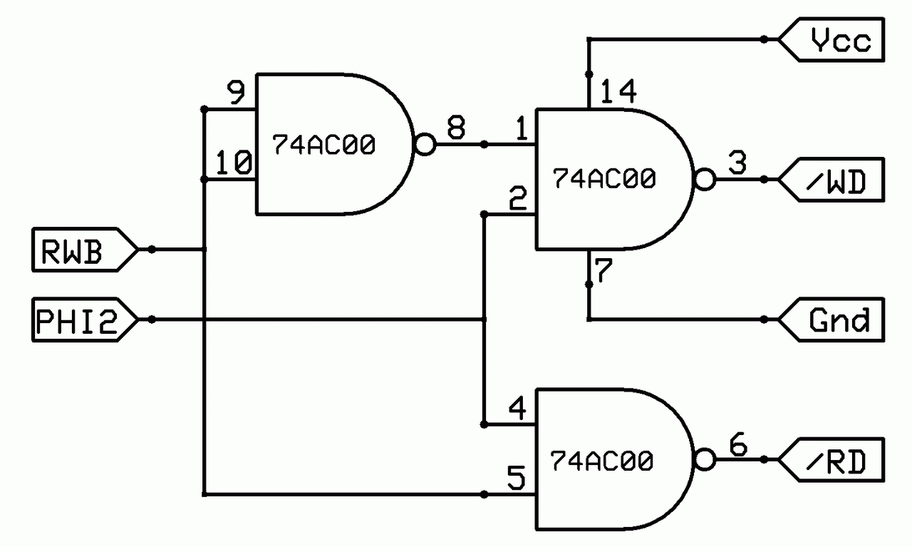

fachat wrote:
It's valid to look at the total delay time of the chain of logic from address to select line.
But it helps qualifying the RAM select or WE line in the last gate of that logic just before the RAM. That reduces the critical time delay between Phi2 and select / WE, and gives you more slack for potentially more complex select logic.
Yep! That is something I have periodically mentioned when the subject of decoding best-practices comes up. The below read/write logic adheres to what you recommend.
With the above circuit, if RAM is selected during Ø2 low, there will be only one gate delay after Ø2 goes high before /RD or /WD is asserted. Using 74AC or 74AHC logic, that delay will be in the single-digit nanosecond range.

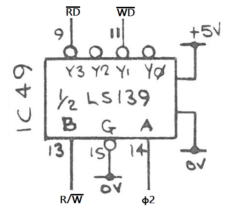

Re: Glue questions
Hello 0010 all,
If you don't want to spend ¾ 74xx00 on it, but have ½ a 74xx139 left over, this Acorn Atom solution might be the thing for you
Gr
tings, Louis
May your wires be long and your nerves be strong !

Re: Glue questions
L0uis.m wrote:
Hello 0010 all,
That works as well, although you wouldn’t (shouldn’t) be using a 74LS device in a 65C02 or 65C816 circuit. Just be aware that the 74xx139 is slower than most gates of the same logic type; e.g., a 74AC139 is about 25-30 percent slower than a 74AC00 in terms of TPD.
As it has worked out in my designs, the otherwise-unused gate in the 74AC00 doesn’t go to waste. I use it as an inverter in the reset circuit for devices that require a high-going reset.

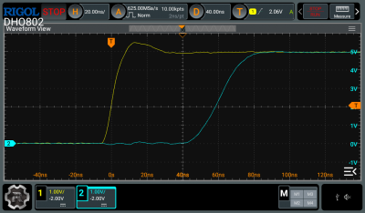

I did some testing with a Microchip PIC18F26Q10 to see if I could use it for glue, providing a clock pulse, debouncing a reset button etc. (An advantage of using a PIC this way is that you can easily change chip select signals, clock freq etc without having to change the hardware on your board. It has 8 logic "cells" (CLCs) which can easily be programmed to provide chip assert signals from various sources. The CLCs work without any "CPU time" on the PIC - it works like a small PLD (so I could then also use the PIC to handle other tasks like driving a display or KB or whatever). I was pretty disappointed with the propagation delay of the logic, and the rise/fall times of the signals. This is a screen capture:
Scope input 1 (yellow line) shows a signal from a 1MHz oscillator (MCO-1510A), and scope input 2 (blue line) shows that clock signal after it went through one of the CLCs. The propagation delay is about 60ns, and the rise time is about 30-40ns. It shows the same rise/fall times when outputting a clock signal directly from the PIC (without any CLC etc).
I was hoping for a spiffier propagation delay and (more importantly) a quicker rise/fall time, but at least digging through some docs seems to indicate propagation delay is between 30 and 70 ns. I can't find any data on rise/fall times for output pins. Hm.
I checked the forum posts, and I could not find any recent discussions about using CLCs in PICs (a few posts from 10 years ago). Anyone has any recent experiences?
-Niek.
-Niek.

Oh, that's slower than I would have guessed. And the CLCs always seemed like such a good idea.

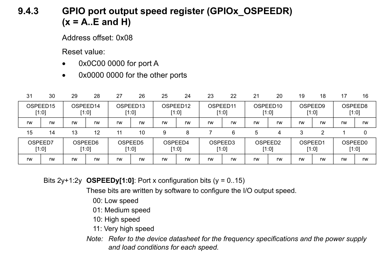

Does the PIC have an option to change the drive speed (rise/fall times) of the output like STM parts do?
Though I discovered some time ago that with the slower drive speeds, the output timing changed with temperature, which was confusing for a while (and then annoying).
The sluggish rise/fall times are particularly bad. None of the 65C02 inputs, other than NMIB, have Schmitt action. I suspect that with such slow rise/fall, stability would quickly become a problem with any attempt to speed up Ø2.
Re: Glue questions
