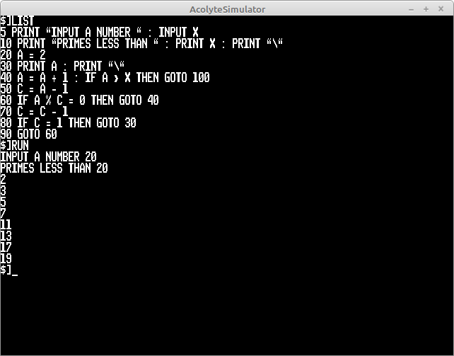

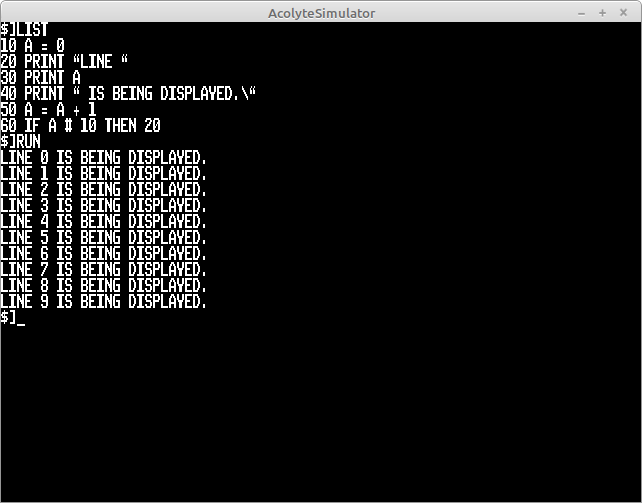

Just an update on things:
Attached is a picture of my simulator showing off some BASIC!
So far I have most of the keywords done: LIST, RUN, NEW, IF...THEN, GOTO, PRINT, and setting variables with math operators. I haven't yet got INPUT, still deciding on how to do that.
This features up to 254 line numbers possible, 8 variables (each acts like an array of 256 bytes), decimals from 0 to 255 (no support for negatives), and as of yet, has no support for variable strings. How awesome is that?! :)

I think I finished my "Acolyte BASIC". I now have all required math operators and INPUT (decimals only, no string input) as well. Fixed some bugs along the way of course. Attached is a picture of a "primes" program.
I find that doing:
PRINT "This " : PRINT X : PRINT ". That.\"
kind of annoying. I'd rather have:
PRINT "This ", X, ". That.\"
I might work on that soon, it wouldn't be the hardest thing to implement. We will see.
So, if you are reading this, can I get some suggestions? I want to have a dozen or so basic programs that do something fun. Finding prime numbers was a good example. Anything else that could show off my BASIC and still be simple overall? Wasn't there a Hammurabi game that was pretty easy to create? I'm not looking for code from you, just ideas like, "Find prime numbers!" or something.
Thanks everyone!
