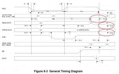

(My apologies in advance for my rather unprecise terminology)
To me it looks like the timing diagram in the W65C02S datasheet could be made more clear. If I see such a diagram and try to understand it, I try to figure out the durations by matching up left and right arrows. It looks like the left arrow for tDSR, tDHR and tDHW are missing. From the (excellent) post and diagrams by Jeff the left arrow for tDSR should be the end of tACC, and the left arrows for tDHR and tDHW should be at the falling edge of PHI2. In the case of tDSR, you could argue that the left arrow is at the same time as the right arrow for tACC, but it would be more clear if drawn like tAH. (see attached)
For a newbie trying to grok this all by reading datasheets (which should be the way to do it), this is somewhat annoying.
Another thing (not an issue with the timing diagram, but just a complete lack of understanding on my part) is that the diagram shows tMDS (write data delay time). This should be the maximum time it takes the MPU to produce valid data to write to some peripheral and the datasheet I have says 25ns. If I use φ2 in my glue to qualify the SRAM, and both glue and SRAM are fast enough, it could be that invalid data is initially presented to SRAM. Am I correct in assuming that if the data is still in flux before tMDS is reached, the "new" data after tMDS will be what is ultimately written to SRAM? If so, I assume the SRAM will "commit" the data after some set time or signal. If that cut-off is forced by φ2 going low, the glue logic would signal that to the SRAM. Isn't there a timing issue there as well? Should the glue be faster than tDHW (write data hold time - set at minimum of 10ns)? Or is there another signal (or time limit) that tells the SRAM the write should be committed and stop paying attention to the data bus? Maybe /WE?
Thanks as always for looking into these (likely trivial) questions.
-Niek.

Re: Glue questions
The data can be in flux after the SRAM's write cycle starts; but if things are designed right, the data will be valid and stable in time for the SRAM to lock it in when you "close its door," so to speak.
It looks like the corresponding left arrow (pointing right) for tDHR and tDHW is supposed to be the same one as for tAH.
Yah, but what exactly initiate the "close the door"? If it is φ2 going low, there will be a delay of the glue signalling the SRAM. If that delay is greater than tDHW, the data bus might show invalid data before the SRAM is signalled.
I agree, but a datasheet should not need to be read with any "it looks like ... supposed to be" thoughts, especially for someone like me who is advised to "read the datasheets for all the info you need" (of course this is by no means directed at you or anyone here, it is just a bit of frustration with some of these datasheets trying to figure it out by myself without having to ask these basic questions - I truly appreciate all replies and advice).
-Niek.
On the '02 (but not the '816), the data bus goes high-impedance during φ1, and bus capacitance, small as it is (like 20pF per line), multiplied by the negligible leakage of CMOS inputs, makes for a time constant that will hold the data for even milliseconds (not just nanoseconds or even microseconds) while nothing is driving the bus.  You don't have to worry about the data going invalid in that time.
WDC's data sheets have had quite a lot of problems over the decades, but gradually most (not all) of them have gotten fixed as we have pointed them out to WDC, which is why there have been so many, many versions.  It's not that the hardware has changed that much, but rather only that WDC puts out a new data sheet every time another bug is pointed out and fixed.
I'm sorry, I don't want to be argumentative, but in reading a lot of the primer and the posts by Jeff, people keep hammering on the fact one should design a setup with all these timing constraints in mind. It is not that I am worrying, but from what I am reading and what you are implying, a situation where the SRAM would be deselected after tDHW could technically be out of spec. I do understand that it won't be a problem (and in my case my setup is running at 1MHz, so even more leeway), but I am getting mixed signals here. Should I just ignore this (theoretical?) issue, or am I missing something else that prevents the SRAM from seeing bad data?
(I am trying to get from "Johnny Gunslinger with his badly out-of-spec 555 clock and Arduino monitoring" in my first thread to someone who can understand and build a 65C02 setup that is technically sound. This stuff is confusing the heck out of me.)
-Niek.
No kidding!  First time I saw a WDC 65C02 timing diagram, my reaction was what in Sam Hill am I looking at?  :roll:  Jeff’s “re-imagining” of the timing diagram puts it into scale, which does simplify understanding it.  However, in scale or not, the timing diagram and WDC data sheet together tell “lies.”
Several forumites, notably Bill Chen (plasmo), have greatly overclocked the 65C02 (the 0.6µ TSMC versions) into the 30 MHz range (I think Bill got one running at ~36 MHz).  The fact that the C02 can be cranked up to that speed, especially when what is inferred by the FMAX vs VDD curve published on page 24 of the current data sheet is considered, implies that some of what is depicted in the timing diagram, as well as some of the specs listed in the AC characteristics table on page 24 in the data sheet, is mostly malarkey.
For example, the tADS spec is listed as 30ns maximum when VDD is 5 volts.  If that were the case, the C02 would die above 14 MHz.  I dunno about the C02, but testing I’ve done on several 0.6µ 65C816s indicates that tADS is 12ns—that was very consistent from one MPU to another.  I suspect that tADS for the C02 is a little faster, as it has less stuff to do to get set up for the next cycle.
In fact, all of those numbers are suspect when one considers that if one extrapolates the FMAX vs VDD curve to intersect with 5 volts, FMAX works out to 24-25 MHz.  Also, WDC tests all production parts at 20 MHz on 5 volts.  So their own test regimen is at odds with what the data sheet says.  :roll:
We all feel your pain on this.  WDC’s less-than-stellar documentation has resulted in a lot of discussion around here about how things work.  Fortunately, their MPUs perform significantly better than the data sheets suggest, which says to me the timing details in their data sheets have not kept up with the gains in fabrication technology that have been realized in the last 25-or-so years (also, there is an undocumented hardware bug in the 65C02).  It’s pretty clear that TSMC’s 0.6µ fabrication performs significantly better than Sanyo’s 0.8µ did (I have 65C816s of both types and cannot get the Sanyo ones past 15 MHz).
Another thing...the diagram shows tMDS (write data delay time)....If I use φ2 in my glue to qualify the SRAM, and both glue and SRAM are fast enough, it could be that invalid data is initially presented to SRAM.
You need to qualify(!) what you mean by “If I use φ2 in my glue to qualify the SRAM”.  Qualify what: /CS or /WE?
Let’s start off by making it clear the SRAM knows nothing about clocks—it has no clock input.  The SRAM is an asynchronous device.  What it knows about is how long it takes for it to react to changes to /CS, /OE and /WE.  That the SRAM is asynchronous is one of the reasons why you need to qualify /WE with Ø2.  As the MPU always controls the bus (it is a “bus master”), it is necessary to tell the SRAM when it is okay to connect to the data bus.
As Garth notes, during Ø2 low, the MPU floats the data bus, but parasitic capacitance tends to keep the bus in the state it was in while the MPU or a device was driving it.  The SRAM will latch whatever is on the data bus when /WE makes the transition from asserted to de-asserted.  There may be a refractory period after /WE is de-asserted in which the SRAM’s data pins must remain stable.  That period of time is customarily referred to as tDH (data hold time) on timing diagrams and on the faster SRAMs, may be zero.  If not zero and the data pins change before tDH expires, the SRAM may latch incorrect data.  Given the nature of the 65C02’s bus cycle and the fact that it floats the bus during Ø2 low, if you use /WE to gate writes to the SRAM and qualify /WE so it is asserted only when Ø2 is high, things will work out without you having to obsess over it.
See above and please be clear about what you mean when you say “glue.”  Are you referring to address decoding, read/write control, or what?
BTW, there is a reason /WE is called “Write Enable.”  :D

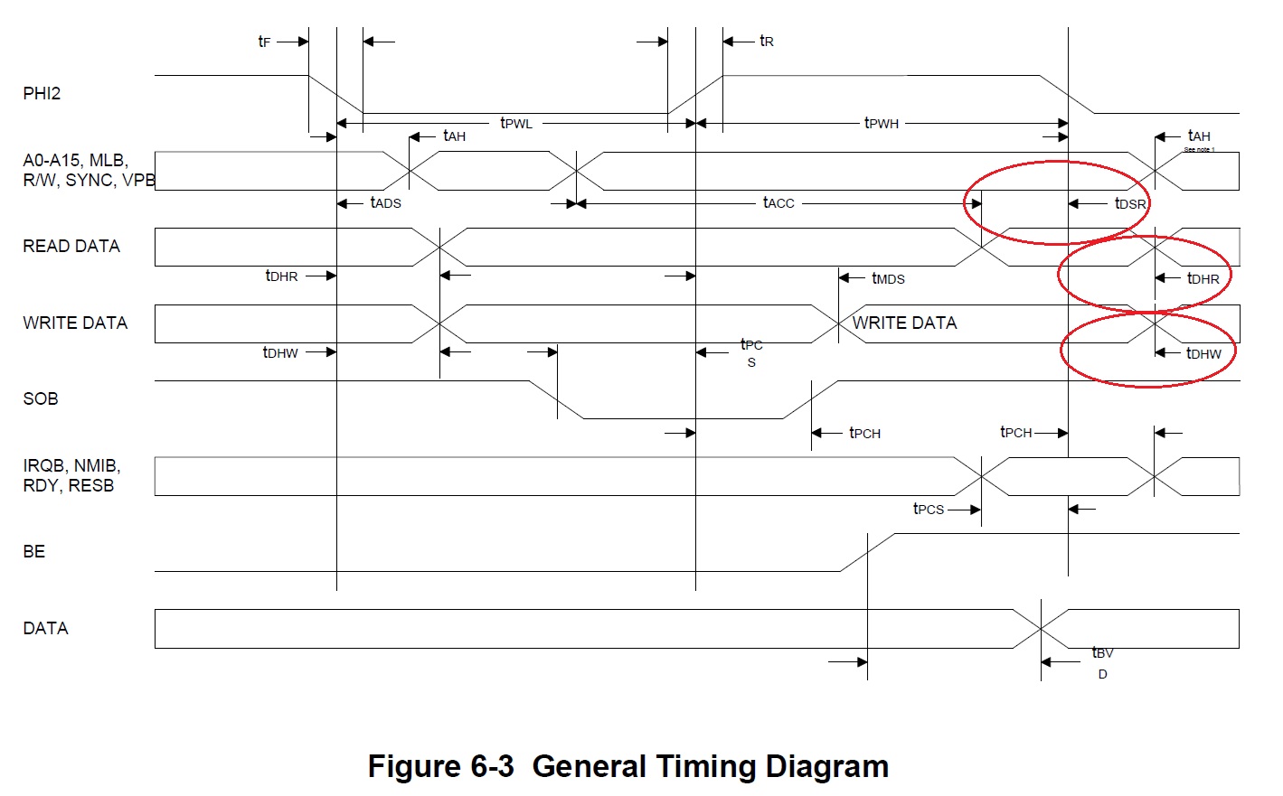

First off, my apologies if my incorrect terminology is messing things up. My question resulted from me trying to digest the 65C02 datasheet, I tried to go through every parameter in the timing sheet, and I saw tDHW which appears to be the time the data is held on the bus after the MPU brings φ2 low.
OK, so that "links" /WE to φ2 (again, not a correct technical term, but it conveys my meaning hopefully).
Please be aware that I am not obsessing over anything. I am trying to figure things out (with excellent help from all of you). I don't have the advantage of having worked in this field for years, so things that seem natural to others on the form are new to me. Several people (also off-forum) have pointed out to me that I need to read the datasheets, so I do. Both you and Garth basically say that yes, it is possible that the SRAM could theoretically latch data after tDHW expires, but in real life that won't be an issue. If that assessment from me of both of your replies is correct, that is fine. I am trying to work out the timing of the various gates and components on my setup to make sure all is OK, and it looked like I needed to make sure I wasn't going out-of-spec on tDHW (and yes, I know, my setup runs at 1MHz so pretty much everything would work, but I wanted to do it correctly and get some experience with this matter).

Re: Glue questions
I'm not offended.  On the contrary, if there's something that needs to be made more clear in the 6502 Primer, I want to know about it and take care of it.  The Primer was written nearly 25 years ago, but I didn't have my own website until 2012, and then I posted the material, and I keep making small improvements, and once in a while someone's posts expose a need for another clarification.  I wonder how many readers were scratching their heads but never let me know.
The main thing you have to make sure of is that the RAM doesn't get orders to write while the address is in flux, as that could result in unintended addresses getting written to.  That's why WE\ is usually qualified with φ2.  (I say "usually" because In many cases SRAM will be faster than anything else on the bus and doesn't need the advance select time before φ2 rises, so there you could qualify the CE\ with φ2 instead.  Qualifying WE\ with φ2 is probably more common and is a good way to do it.  BDD prefers it.)  The address the '02 puts out won't change until at least tAH after the fall of φ2.  Where someone might get in trouble there is if they have too many gate delays in the glue logic, or use logic that's too slow (like 4000 series).  It is common for newcomers to cascade too many gates, as if timingwise they were free.
This actually touches on one of the things that took me a while to grok. Up in this thread, I asked why we needed to get multiple pins to assert before a peripheral is active. BBD explained that ideally the IC needs to wake up first, and then it will react faster when it is asked to do the work. You say here that /WE can be qualified with φ2 to make things work. It doesn't say why doing this guarantees a stable address. What is not spelled out here (probably because it is so obvious to the experts) is that when you examine the timing diagram, you will see that the MPU assures the address is stable after tADS, which for the 65C02 (at 5V and room temperature) is 30ns. If you use a symmetrical clock, this means that for clock cycles below roughly 14MHz, the address is guaranteed to be stable before φ2 goes high. So qualifying /WE with φ2 guarantees that /WE will only be asserted with a valid address. For me, it now makes sense. (It also implies that any setup that asserts /WE after tADS will work, so I could see other setups that don't qualify /WE with φ2.)
Thanks all for turning on the light.
