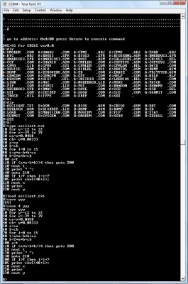

A quick update:
CC65 assembler is quite similar to the version 2 assembly so it was fairly easy to port ver 2 SYSGEN code to CC65 environment. I preserved the CCM and PEM section of codes as they were and added my own SIM to create a complete DOS/65 image in one file. CRC65 has no ROM (other than 64-byte bootstrap in CPLD), so SIM combined hardware-specific BIOS in its code. SIM is quite large right now, about 2300 bytes which includes 1K of allocation maps for four 8-meg disks; compact flash data buffer also eats up 512 bytes, so most of the SIM memory is consumed by data buffers.
DOS/65 ver 2 implementation is very similar to Z80 version of CP/M so that was quite helpful. I structured DOS/65's disk format same as my Z80 CP/M so I can use CF disk formatted for CP/M on DOS/65. This helped me with reading the directory, type out file contents, load, save, erase, and rename files. The 'go' command is very cool; it lets me jump to CRC65 monitor and load/examine/modify memories as needed.
Right now I have the basic DOS/65 functions working. CF write is immediate which is easier to implement than delayed write. Warm boot is only partially implemented. I'm manually loading and running DOS/65 binary but should be able to autoboot with a DOS/65 loader installed in CF's master boot record. I'm in the process of figuring out how to port various DOS/65 application software starting with XMODEM, so I can transfer software to the CF disk and use DOS/65 native assembler to create executable software. Hardware is running at 14.7MHz, but I expect it to run at 29.5MHz.
