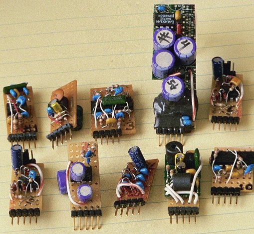

My oscillator is unreliable but the dividing circuitry can be compacted down to an arrangement of 2*3 chips on a 5cm*7cm prototyping board. Indeed, this can be reduced to a module with four wires: power, ground, input, output. It also raises reliability because when it is soldered onto one board, I don't have to worry about loose wires in the holes of a breadboard. There is the consideration of sockets or no sockets. Sockets can be a source of failure. However, if you have terrible soldering, like me, then sockets are an obvious choice. Use of sockets may also be a budget consideration because it eases scavenging of chips from previous projects. To keep wires short, I recommend a serpentine arrangement. I also strongly recommend making a minimum of two debug boards and it is for this reason that I suggest buying a minimum of 20 counter chips: six on breadboard, six on each prototype board plus two spares. This was extremely useful for the next stage.
