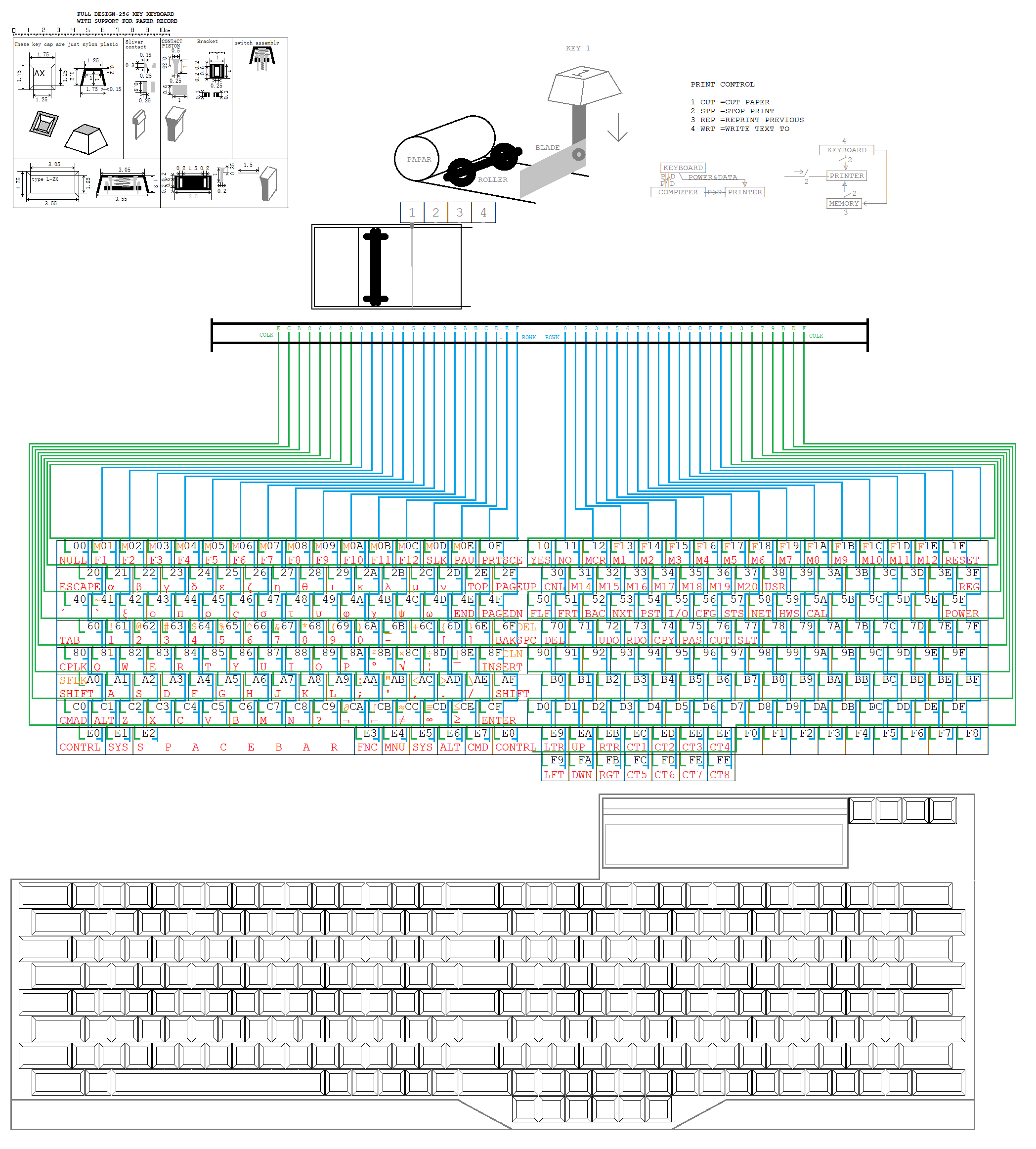

I am slowly appreciating your 16*16 keyboard design. I also had plans for a 16*16 keyboard matrix. However, my design decisions are almost diametrically opposed to yours. Regardless, I can appreciate the consistently of your choices. For example, I greatly appreciate the symmetry you have chosen for backspace and delete.
I explained your design to a friend. Specifically, that it is the main cluster of a PC keyboard design, a mirror image of the main cluster for specialist functions (such as copy and paste) and further keys to the lower right. I presume it would be used with the first space-bar aligned to the user. Indeed, I presume this is primarily a programmer's keyboard or power user's keyboard where 105 keys or so is a limiting factor. In such case, you don't care if your design dislodges the dominant design. You merely want it for your own productivity. Indeed, I may be able to help you and others in this quest.

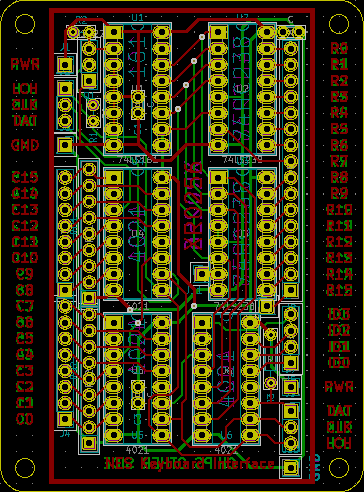

A 4021 requires power and ground. It provides one bit of serial data. It is operated with "latch all bits" followed by repeated application of "clock all bits by one position". A NES (with 6502) or SNES (with 65816) can read three serial channels of data from each of its two joypad ports. In the trivial case, only one channel is used. The second channel is used by a joypad multiplexing unit called the FourScore. (Unfortunately for the puerile among us, the marketing department decided against calling it the FourPlay.) Presumably, the third channel is used to identify extended uses. The FourScore and several other protocol extensions (light gun, Mattel Power Glove) are supported by a subset of games. Actually, full support for the protocol was quite strained. For example, the Mattel Power Glove operates in 22 modes to ensure that it can be used effectively with the broad software catalog; much of which pre-dated the peripheral.
Although I only made a cursory search, I was not able to find technical specifications for the light gun or Mattel Power Glove. In ignorance, I have forked the NES/SNES protocol with the assumption that only the joypads will be supported and that more exotic devices, such as the Mattel Power Glove, will only work in a compatibility mode, if at all.

The counter (typically 74HC161) may be configured to scan any quantity of rows. The negative edge of the "latch all bits" signal is inverted with a 2222A NPN transistor. This is used to advance the 4 bit counter when timing is not critical. The 4 bit count may be fully decoded with two 74HC238 chips. One of these 16 outputs energizes one row of the keyboard. The positive edge of the "latch all bits" signal causes the 4021 chain to retain one row of the keyboard (16 bits), the keyboard device's number (4 bits) and the row number (4 bits). These 24 bits may be shifted up the device chain to the host. This may be used in conjunction with the simplistic "sample twice, act once" technique to overcome switch bounce and bit slip. Unfortunately, this circuitry has the minor energy inefficiency of leaving one keyboard row energized after key sampling. However, this wastes the most energy when keys are depressed on a trivial discrete logic implementation. This is not a consideration when keys are not depressed. Likewise, it is not a consideration when the keyboard uses a one chip microcontroller implementation. Traditionally, 8051 has been used for PS/2 peripherals an small PIC devices (with 512 instruction words) have been used for ADB peripherals. However, you are strongly advised to pursue other options.

Unless you plan to use every position of 16*16 switch matrix, it would be strongly preferable to implement a hidden diode matrix to denote type and subtype. For example, 105 key PC keyboard, US/UK/French/Spanish/German layout. A shocking number of legacy keyboards use the same switch matrix and therefore it may be sufficient to support one physical layout and four keymaps or less.
Musical keyboards should assign row 4, position zero to 440Hz A Major. The remainder of the row should be used for the remainder of the octave. Row 5, position zero should be assigned to 880Hz A Major. If you are unfortunate enough to have a keyboard which works from C Major or similar, a hidden diode matrix may be required to define the skew. Auxiliary switches may vary considerably. Regardless, it should be relatively trivial to bridge a random synthesizer keyboard to SNES protocol (in hardware) and then to MIDI (in software). Furthermore, the result should be fairly portable.
Mouse should use row zero for buttons, row 15 for vertical position, row 14 for horizontal position, optionally use row 13 for vertical scroll and optionally use row 12 for horizontal scroll. This allows a trivial implementation to cycle through three, four or five multiplexed values, although update frequency will be adversely affected by the number of reported values. For compactness, it may be desirable to implement a SNES protocol mouse using CPLD, although current draw may be horrendous. (I believe idle current for ATF1504 is 105mA.) Furthermore, 24 bits of shift register and multiple up/down counters may exceed the available state of a 64 cell CPLD. 128 cells may be required or the resolution of the counters may be reduced. For example, make the least significant four bits always read zero. Actually, just use a microcontroller.

The host interface for one SNES input is trivial. One 6522 shift register may be clocked autonomously from a timer and the 6522 may interrupt after eight bits are collected. This requires three readings per device; typically for a daisy-chain of two or more devices. This is no more onerous than single byte UART at the same data rate. However, each additional input stream may be collected with its own 74HC595 and all ganged units may be handled synchronously in the same interrupt (which may not be the case with UART). Indeed, it is possible to implement eight additional inputs by using nine additional chips. Yes, in this absurd case, all input peripherals may be connected to a long line of 9 pin D connectors, a 3*3 grid of 9 pin D connectors or, perhaps, a two row D of 9 pin D connectors on the front of a computer. Up to the power limit supplied by the host, this covers any permutation of hex keypad, computer keyboard, musical keyboard, mouse, joystick, dance mat or other input peripheral - directly connected or daisy-chained - with no affinity or preference regarding connector position.
My suggested fork of the NES/SNES joypad protocol only covers one channel of clocked serial data from each peripheral. This simplifies daisy-chaining. However, if you want full historical compatibility, it remains possible to implement the triple data stream clocked serial over a lesser number of ports. Understandably, such a device may not daisy-chain. However, it does retain compatibility with the Mattel Power Glove.

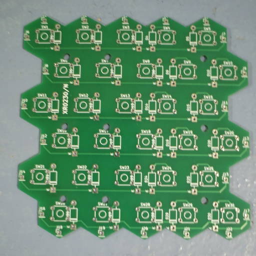

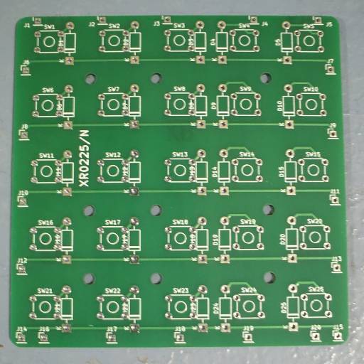

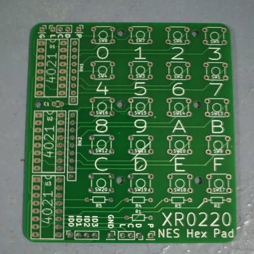

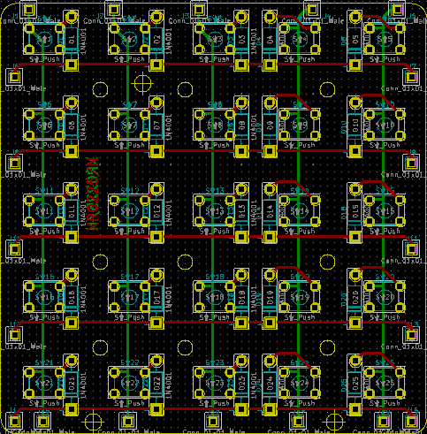

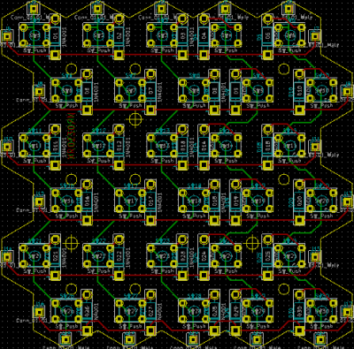

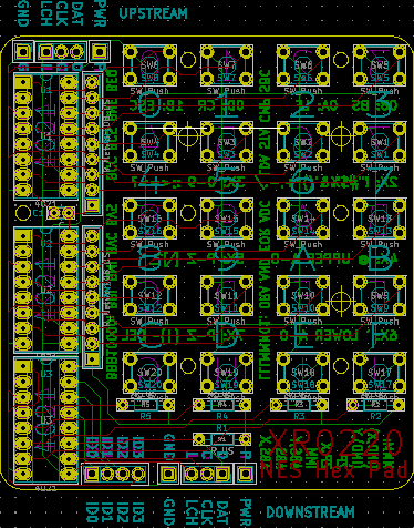

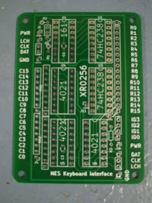

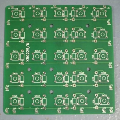

I've been working on input peripheral boards. Now available and in stock:
No charge for hobbyists. Indeed, pay it forward rather than pay it back. If I ever establish a payment mechanism, all boards of 100mm*100mm or less will be USD5 plus a global flat rate of USD5 for shipping. This includes the forthcoming XR2600 Series main boards.
Newbies may be particularly interested in the growing list of giveaway parts which include my 5V, reversible indicator lights.

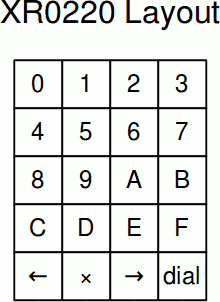

- XR0220 (untested): Possibly the world's first gaming hexpad. 20 button keypad which is compatible with most NES and SNES games.
- XR0256 (untested): 16*16 keyboard matrix controller.

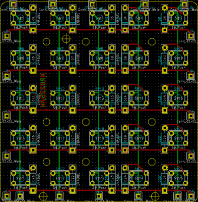

- XR0225/N (untested, but I'd have to be a complete moron to get it wrong): 5*5 straight run keyboard tile. This variant uses Omron switches with 18mm spacing. This is compatible with 2*2 Lego bricks and matches the style of the XR3600 Series desktop enclosures.
- XR0230/N (untested, but I'd have to be a complete moron to get it wrong): 5*6 staggered keyboard tile. This variant also uses Omron switches with 18mm spacing but is not compatible with 2*2 Lego bricks due to the use of triangular packing.

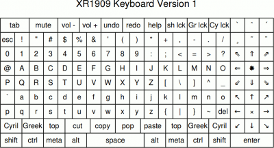

To determine preferred typing layout, I purchased two distinctly different keyboards. One was a Spanish keyboard with "red" clacky keys and a numeric keypad. One was a Russian keyboard with "black" linear keys, without numeric keypad, with tacky back-lighting and with media controls. Sheep20 vastly prefers the clacky keys and I have almost equal misgivings toward both keyboards. Most annoyingly, it is almost impossible to obtain a Russian QWERTY keyboard, as preferred by the cool kids. Instead, the vast majority of Russian keyboards use the official Soviet typewriter layout. If you want to switch between Roman, Greek or Cyrillic, you'd definitely prefer phonetic consistency, especially when typing loan words. The back-lighting appears to flicker below 50Hz and I'd presume this is also the key scan frequency. However, most annoying is the back-lighting for the volume dial. Several key combinations choose which sections of the keyboard are back-lit. This includes fully on, fully off, media playing and six weapon shooting game! (Like Quake?) Unfortunately, these useful key combinations are never forwarded to the host. The only upside is the the circular volume control worked by default with all available operating systems - including 10 year old version of MacOS. Obviously, this protocol extension has been established for many years.
USB keyboards can only send packets which are sufficiently long to represent six key presses. The standard workaround is for each keyboard to register itself as multiple USB devices. This allows multiples of six key presses. However, USB1.x only allows 63 devices. Therefore, a significant proportion of addresses may be consumed by this "helpful" workaround which still has limits. It may also hinder USB1.x bandwidth and keyboard driver latency, especially if caps lock is duplicated across all virtual keyboards. If you aren't collecting packets deterministically and at 60Hz then your keyboard is slower than common designs from the 1970s.

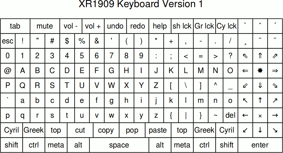

For custom keyboard design, I strongly recommend drawing a proposed layout, printing it on paper and then trying various scenarios. You'll look crazy typing on paper but it will save you considerable expense and effort with an unfavorable design. My preferred arangement is likely to be someone's idea of purgatory. Specifically, I'd like a straight run, six row ASCII chart with seven space cadet meta keys, accent keys and arrows. This requires about 160 keys and is definitely too extreme for many people. However, there are many claims about "programming keyboards" which require one or two meta keys to perform basic functions, such as typing brackets. XR1909 true programing keyboard which may be partially made from XR0225 keyboard tiles. Most importantly for programmers, it allows round brackets, square brackets, curly brackets and angle brackets to be typed without meta keys. The result looks like a Chinese typewriter but it is not intended for general use. I've been careful to ensure that the design only requires keys of six different sizes. This will hopefully reduce the cost of double-shot key molding (or 3D printing equivalent). I've also been careful to ensure rectangular perimeter. Even if you're laser cutting a keyboard enclosure, this will save you time and effort.
Dedicated keys for upper case and lower case will aid programmers, dyslexics and people who do not commonly use Roman script. In particular, it should discourage people typing in caps because the script on their keyboard matches the script on the screen. With alphabetical ASCII arrangement, cut/copy/paste is greatly disrupted. Instead, dedicated keys are provided. For native applications, paste and pop are available. This allows clipboard to operate as a stack rather than a singleton. I don't care if anyone except Forth programmers use this functionality. Remember: this is an optional keyboard for programmers. Meta keys on both sides are symmetrical and care has been taken to ensure that locking keys are not pressed accidentally. To aid correct use of meta keys, suggested textures are:
Admittedly, my requirements are quite specific. For example, I'd like key repeat on arrow keys only. However, arrows in plane, arrows out plane, region selection and media control are grossly inconsistent. I don't like all of the crufty PC keys and I prefer something more like Commodore Amiga keyboard. However, I am particularly irked by systems which selectively ignore Home and End. As an example, GNOME's Character Map works with Home and End but GNOME's gedit ignores them. Stupid, twirly volume dials work but basic functionality, such as navigating a text document, doesn't work. And dozens of parties are quite happy to package this broken software without fixing it or sending any fixes upstream.

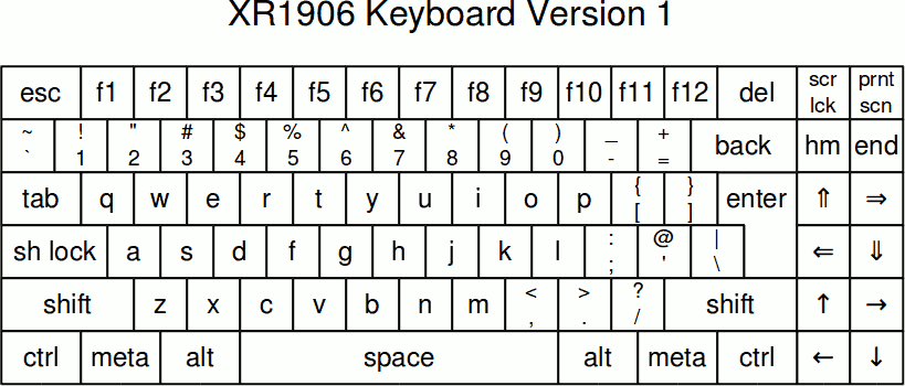

For people who prefer a slightly more conventional keyboard, XR1906 is a psuedo PC keyboard may be partially made from XR0230 keyboard tiles and is a mix of historical 8 bit Commodore and contemporary US layout. It has 12 undefined function keys, reduced cruft and is without numeric keypad. I believe this would be described as 80% keyboard. If function keys are omitted, the quantity of keys is much more similar to 8 bit Commodore hardware, although arrow keys are notably improved. The arrow cluster is splayed such that a hand approaching at a diagonal obtains a logical arrangement of four arrow keys. The relevant strips of keys can be reversed or duplicated such that arrows may be used equally well with left hand, right hand or both. Again, I have ensured that the perimeter is a rectangle, that only six keys sizes are required and that meta keys on both sides are symmetrical. I honestly don't care if the meta keys are textured but some are the same size and may be common to both designs.
For boot-strap, the suggested arrangement for XR0220 hexpad is 16 hexadecimal keys in ascending order, left arrow, select, right arrow and one key to dial any hexadecimal value which is not directly available. The hexadecimal keypad can be used on either side of XR1906 as its hexadecimal keypad, or in preference to any keyboard for media control. Specifically, left and right arrows allow media to be skipped. In general, left, right and select allow menus to be traversed. To allow graceful operation (notably lacking with typical arrow key implementations), the first item of every sub-menu should return to parent menu. It may be desirable for hexpad and LCD to work relatively independently of other peripherals. In particular, hexpad may drive LCD menu independently of full keyboard and video - with the exception that free text fields within the LCD menu obtain precedence for keyboard focus and the media player may obtain precedence for hexpad arrows. This would allow a hexpad and two line LCD system to be expanded to keyboard and video system without discarding resources. It also allows 6502 systems to be used in unusual configurations. For example, a portable, battery powered music player which also captures keyboard input without screen. When connected to screen, it can be used to play games, play video or used for typing or programming.
XR0220 may be partially populated with shift registers and switches, configured with alternate device ID nybble or connected to a dedicated shift register port. This allows XR0220 to provide dedicated functionality, such as media play/pause/stop, skip forward/backward, previous/next track or previous/next index to multiple PCM audio collections or synthesized text to speech sessions. One or more XR0220 may also be daisy-chained and used as a dedicated macro keyboard.
- Vertical stripes for shift.
- Checks for control.
- Horizontal grill for Greek.
- Circles for Cyrillic.
- Triangles for top.
- Mesh for meta.
- Animal for alt. Nominally, a sheep.
