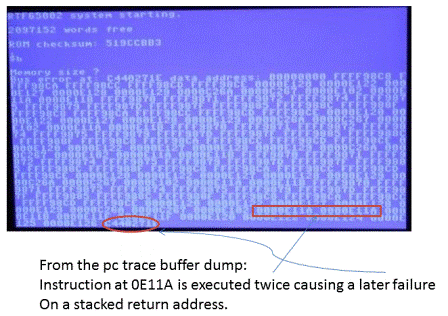

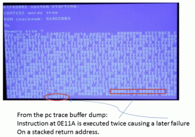

The core failed to increment the pc when it was supposed to, and then it executed the same instruction twice.
The instruction happened to be the mode switch instruction, so the processor didn't switch modes. Then it eventually went crazy executing invalid instructions until it finally got a bus error.
I think this may be timing related, the FPGA being 85% full and running at near max for the core. So the next thing to do is try decreasing the clock frequency to see if that helps. Otherwise I'm stumped because the code is in a loop and executes successfully a number of times before it fails.

Found out it wasn't timing related at all. The core had a bug in it having to do with the emulation flag being set during interrupts.
The set flag caused the core to write out only the upper half of the interrupt return address, if the interrupt occurred while the core was in emulation mode.
It's fixed now. I hope to have the updated code posted shortly.

How did you find it? Are you in simulation or running live? Do you have ChipScope?
Re: The RTF65002 Core
First I tried to change the noise profile by altering timing several different ways. When that didn't work,
I had had finally turned on history capture during interrupts, and saw the return address was screwy. It either had to be the store or the load of the PC. I figured out that the store of the PC wasn't working by back tracking through the code. I had code like this:

I fixed it by cleaning up the code, and having a task accept a parameter for the store.

I found having a history capture valuable enough that I end up including it in the processor I'm working on. I included it in several different processors now. When it's combined with a bus error support, it makes finding some problems easy. I just run the sucker until it hits a bus error at which point the fault address is displayed. then it's possible to refer back to the source code.
It's only a handful of lines of code to include a history capture:
if (hist_capture) begin
history_buf[history_ndx] <= pc;
history_ndx <= history_ndx+7'd1;
end
4'hA: res <= history_buf[index];
