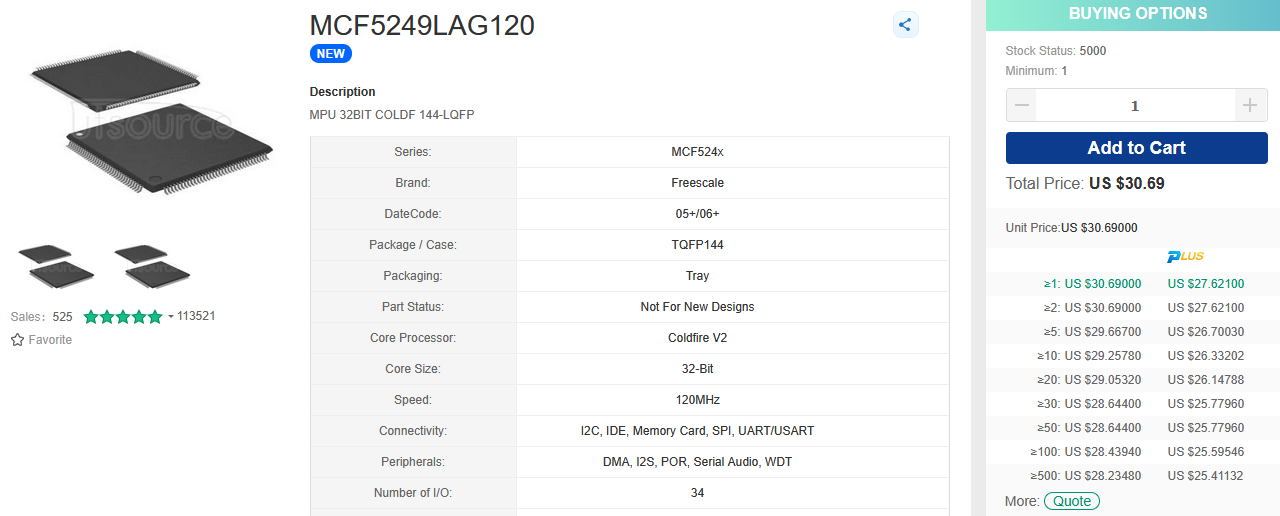

(Interesting - a 68k with a reasonable amount of RAM included. But £25 to £30 - not super expensive as you say, but also not super cheap.)

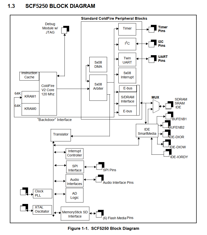

68000 is another option worth considering. There's a lot more software available and you can still get microprocessors. People are building their own 68030 designs without much trouble, and there is a lot of capability there. Plus it's easy to interface with the same I/O chips we are already using.
Specifically the NXP ColdFire V2 in the TQFP package (MCF5249LAG120).
It's a 68000 compatible CPU which can interface with SRAM (although those pins can be programmed to interface with SDRAM instead). I don't know the 68000s well enough to spot the differences with the ColdFire V2 core but it basically looks like a bunch of peripheral modules and and address decode strapped around it. And 128KB of in-chip SRAM.
It's also not in a crazy BGA package and still appears to be available in the 10s of thousands and isn't *that* expensive.
