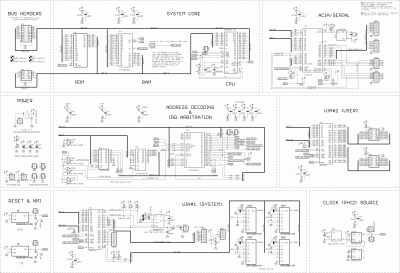

Hi guys
This is my (hopefully) completed 6502GPD v2.5 design. I'm designing the PCB layout at the moment, but want to get some expert opinions before I get it fab'd (if you guys are happy to do this?).
I'm not going to wire-wrap it as it'd probably cost me less to just get to made (mostly due to the cost of wire wrap sockets).
Over all description
It's a general purpose 65c02 board with as much I/O as possible exposed for experimentation and with expanded memory mapping.
Here are the features:
- 65c02s CPU running at 8MHz (dependant on the max speed of the design, especially the memory banking)
- 16 banks of RAM, each bank is 64KB. Not all is used - see banking below
- 24KB ROM - see banking below
- I/O: 2 channel Serial, TTL level, additional general I/O pins available
- I/O: System VIA
- I/O: User VIA
- I/O: 4 bit banking latch
Memor map
The system allows for 16 banks of memory to be selected. Each bank is 64KB in size.
Certain memory ranges may not be "banked" and will always map to a specific memory bank or device.
The following is adjustable in the ATF1504 CPLD
$0000-$0FFF : Zero page, stack, some non-bank OS/user space. This will always map to bank 0 no matter the selected bank
$1000-$8FFF : Main RAM, fully bank switchable.
$9000-$90FF : (no device selected)
$9100-$91FF : I/O / Serial/ACIA, always mapped irresepctive of bank selected
$9200-$92FF : I/O / User VIA, always mapped irresepctive of bank selected
$9300-$93FF : I/O / System VIA, always mapped irresepctive of bank selected
$9400-$9EFF : (no device selected - I may map this to RAM in future)
$9F00-$9FFF : Bank latch
$A000-$DFFF : If in bank 0 then OS ROM selected , otherwise the same as $1000-$8FFF
$E000-$FFFF : OS ROM
Total of accessble RAM:
Bank 0 : 36KB >> ($0000-$8FFF)
Banks 1-15 : 48KB each (48KB x 15 = 720KB) >> ($1000-$8FFF, $A000-$DFFF)
Total : 36KB + 720KB = 756KB
I/O
ACIA/Serial: This was originally going to be a WDC 65C51 but due to a bug in that chip I've gone for a SC28L92. This IC allows 2 serial channels and some general I/O ports.
The serial channels map to 2 headers which provide for TXD, RXD, CTS, RTS and GND, don't use a line driving IC but utilise TTL levels. A TTL to RS232 module map be used with this.
6 outputs pins and 5 input puts are available for user use (OP2-7, IP2-6) and are routed to pin headers.
User VIA: This VIA is dedicated completely to user programs. The pin headers for ports both A & B include their own +5V and GND pins.
System VIA: This is for the OS to use. It gives access to a pin header for 44780 LCD (in 4 bit mode), 4 banks of 128KLB I2C EEPROM and a real time clock (RTC).
Bank latch: Selects the memory bank (0-15). Read/writable. The bank number is the lower 4 bits, the top 4 bits are discarded/set to 0.
User input/output
The user display/keyboard is going to be from an attached PC via serial channel A. An LCD port may be attached to the appropriate System VIA pins. Additionally, a PS2 keyboard could be mapped to the System VIA (Port B pins 2-7 and CB1 are free and route to a pin header).
Diag/expansion
The following signals are routed to pin headers for diag/expansion purposes:
Address bus (16 bits)
Data bus (8 bits)
65C02 signals: IRQB, NMIB, RESB, RWB
IRQ open drain
PHI2 clock
/RD and /RW from the CPLD (used with non-65xx devices)
4 GND pin headers are dotted around the board for use with 'scope probe ground
Reset button and NMI buttons provided.
Device addressing
The ATF1504AS does all device addressing (ACIA, VIAs, RAM, ROM, bank latch)
IRQ arbistration
The ATF1504AS does all IRQ arbitration (ACIA (open drain) and VIAs)
RAM
The RAM consists of two bricklaid SRAM ICs with all pins except the /CE enabled pins soldered together.
The bottom most IC /CE pin is soldered directly to the PCB, where-as the top-most IC /CE pin is connected to a nearby single pin header. This has been done to conserve PCB real estate.
Each IC is 512KB - each seen as 8 banks of 64KB - for a total of 1MB. The bottom-most IC covers banks 0-7 and the top one covers banks 8-15.
The top-most IC can be omitted (and the associated /CE pin header), reducing the memory to 8 banks of 64KB.
Clock
The main PHI2 clock is generated via a crystal oscillator can routed through a D type flip flop. This gives a square-wave signal with a 50/50 duty cycle.
Power
The board has one main power input which expects 5V (reverse polarity protected)
2x Aux +5V power out headers are provided. These don't have any protection (for now).
3x 33uF tantalum capacitors are dotted around the board for power smoothing
Each IC has a 100nF ceramic capacitor across the power pins for smoothing
Circuit Diagram:
Please let me know what you think :).

banedon wrote:
This is my (hopefully) completed 6502GPD v2.5 design...
I see an unused section of a 74HCT132. Why not use that to invert the reset signal and thus free up a pin on the CPlD, as well the logic being used?
A good suggestion. I'll make the change and (for now) route the freed pin to a pin header. Cheers!

Posted: Fri Dec 25, 2020 1:16 am
by floobydust
Beyond what others have already noted:
1- I/O decoding... seems an awful of space wasted for I/O selects. I use a PLD for this and break out page $FE into 32-byte wide I/O selects.
2- RAM setup... why not use a single 1MBx8 SRAM instead? Personally, I don't like piggybacking them, unless it's a modification for testing. But again, that's up to you.
3- ROM usage... as you're using a CPLD, you should be able to bank that if needed as well, and by relocating the I/O upwards, you could easily make a 56KB RAM and 8KB ROM mapping with less than 256 bytes used for I/O.
4- Pull-up/down resistors... I've noticed quite a few of these on signals like /RD and /WR and some other signals. Have you found this necessary?
5- ROM signals... why not use the /RD signal to drive /OE and keep the /CS select separate? If you use an EEPROM, you could also wire the /WR to the EEPROM (via a jumper) and provide insitu programming.
6- Reset signals... I'm using a TL7705B which provides open collector outputs for both negative and positive going reset signals... just a thought.
Re: 6502GPD v2.5 design review
Posted: Fri Dec 25, 2020 2:10 am
by banedon
Hi flooby
Thanks for responding. I've listed my responses as numbered ones just to keep things easier:
1. Indeed. I did it that way as I was trying to keep the decoding in one CPLD (I mostly succeeded - only an extra NAND chip is used on top). This was partly to keep the number of ICs down and also I was told a long while ago about possible timing issues if I used multiple GALs & CPLDs. I could possibly use an 22v10 GAL to decode the IO into a single page?
2. I looked at 8Mbit (1MB x8) RAM. Most of the ones I checked at the time were slower running at 45ns or slower, where-as the CYC1049GN runs at 10ns. I planned to use a circuit to slow down the CPU when the 45ns ROM is accessed, but go faster when accessing RAM. Due to space constraints I dumped that later on in the design process.
3. I was trying to keep some of the ROM always available to cut down in the need for bank switching. I could make it bankable I supposed, but prefer to keep access always available. I did the same with the I/O for the same reason.
4. It was recommended that I add pull-up resistors on the CPLD outputs as the ATF1504AS has TTL level outputs (just about 4v for a 'high'). I was going to leave these off the board if it turned out that they were not needed.
5. No reason not to. However, the CPLD only allows the ROM to be selected in conjunction with RWB being high so there's no problem having it that way and means I don't need to route another line to the ROM.
With regards programming: I'm going to be using a Winbond W27C512-45Z which uses +14V for erasing and +12V for programming. I only have 5v available on the board so not really an option.
6. I did have a look at the TL7705B previously and am still thinking on it - thanks for the suggestion.

banedon wrote:
One thing issue I've noticed is that most SRAMs which have TTL compliant inputs (needed for the ATF1504AS CPLD) also output using TTL levels and I don't think the w65c02s databus is TTL compliant? I had a very quick look through the datasheet this evening but couldn't find anything which mentioned TTL, but some googling seemed to indicated WDC had dropped the TTL level compatibility. I could be wrong and will check again.
As such, I might need to add a pull-up bus resistor on the databus...
We've hashed over this in the past and I've kicked E-mail back and forth with Bill Mensch and David Gray of WDC on this subject. All versions of the 65C02, both those produced by WDC and those second-sourced by Rockwell, etc., have TTL-compatible inputs. The 65C02 in its original form was meant to be a drop-in replacement for the NMOS 6502. Years ago, I swapped in a Rockwell 65C02 into a PET 8032, which had an NMOS 6502 and loads of 74LS logic. It worked without a hitch. Many Apple IIc users replaced their 6502s with 65C02s, which Apple themselves did with the latter IIc models.
Bottom line is the 65C02 retains TTL compatibility.

by banedon
CY62158E (datasheet) MoBL looks interesting. 45ns, TTL compatible I/O, although it says that it's not compatible with CPUs which expect CMOS input levels - which should be fine given the discussion above.
The only downside I can see is that it'=s a fairly large IC: 44-pin TSOP Z44-II.

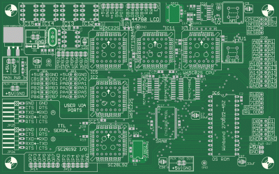

I've got the PCB routed finally. I think I've developed an aversion to routing PLCC ICs :D. Just doing some tidying up, etc. now.
He's a picy of a graphical representaion of the PCB. I'm using EagleCAD (not the Autodesk one) with a PCB limit of 160mm x 100mm so have had to crush everything in a bit:
Top:
Bottom:
One thing which I'd like to implement is video and keyboard. To this end I've routed the following signals (via pin headers) to the right side of the PCB (opposite side of I/O) for potential daughter board(s). Each such daughter board will have pass through headers so more than one can be used:

by floobydust
PCB looks good... agreed on routing around PLCC devices. I probably should have mentioned this before, however....
The 5-pin connectors used for your TTL Serial outputs. You might want to use a 6-pin header with a pin-out that matches one of the FTDI USB-to-Serial interfaces. I've used several of these over the years... one that could be useful for your SBC is the LC-234X (datasheet attached). You don't need to use the power pin, but possibly a jumper in case you decide to run the board from USB power.
DS_LC234X.pdf
(570.48 KiB) Downloaded 78 times
Also, have you found some good pass-thru headers/connectors for stacking the I/O board(s)?
Posted: Tue Dec 29, 2020 7:50 pm
by banedon
A good idea. I could probably make a custom cable, but there's no reason not to make things easier at the design stage :).
Here's the redesign. JP26 represents my original pin header and JP25 represents my new one. The pinout from the datasheet you linked can be found beneath:
Header-wise: I have seen a few solutions, but if it really comes down to it I'll use pin header sockets on the underside of the daughterboards and offset pin headers on the top side.

And here's the above on the PCB :
