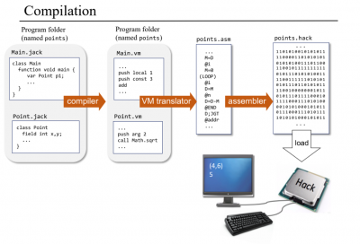

SamCoVT wrote:
The limiting issue I see with this processor is that there is no way to get the current value in the PC onto the data bus. While all of the instructions needed for creating a data stack in RAM are there, there is no way to create a call/return stack.
The nand2tetris course achieves function calls/returns for this processor using a "virtual machine translator" which generates machine code from bytecode. The bytecode for a function call translates to machine code which pushes the correct return address for the call site to the software stack before jumping to the function address. Here's a screenshot from the course material (captured from the material for project 7 here: https://www.nand2tetris.org/course.)
The nandgame (https://nandgame.com/) achieves a similar outcome via a macro assembler and macros which generate the necessary code at function call sites to 'manually' push the return address to a software stack.
Machine code to populate data structures in RAM, similarly can be generated by the virtual machine translator or macro assembler and I woutld think these approaches provide an adequate foundation for creating a Forth interpreter. Of course a true compiler that can run on this architecture, for any language will require some means to move data from RAM into program memory.
