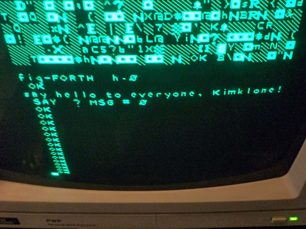

From another post... :)

cheekyfox wrote:
I keep asking why
and get the answer WHY ? MSG # 0
On the TRS-80 Model I Level I the answer was WHAT?
But carefully and slowly repeating the question had no effect. Maybe a more appropriate response would have been DUNNO.
Each time I ask WHY? , I get a different answer! :lol:
