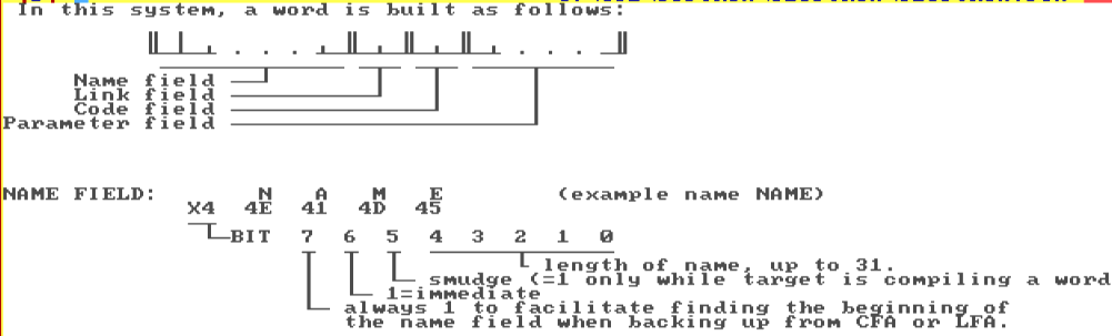

Here's a graphic of the ITC Forth header structure, plus some explanation which should help. I think the only difference between this and FIG is the comment here about the need for aligning 16-bit cells to even addresses. On the NMOS 6502, this had to be done because of the JMP(xxFF) bug (which was fixed in the CMOS 65c02).
After the name, there will be a zero byte if necessary to have the link field
 start on an even-numbered address.  Making the dummy byte a zero makes it
 easier to find the NFA given the LFA when we allow characters above 7F in
 names.  The name field can start on any addr.  [Edit: It especially makes SEE,
 the de-compiling word easier.]
 LINK FIELD:    A two-byte address (low byte first, as usual) of the name
                field of the previous word in the vocabulary.  Link field always
                starts on an even address.
 CODE FIELD     A two-byte address of the code to execute for this word.  For a:
                primitive: it points to the parameter field (its own addr + 2).
                secondary: it points to the CFA of nest.
                constant:  it points to the addr of const runtime routine.
                variable when the word is in RAM:  it points to the addr of
                   create (not CREATE ).
                variable when the word is in ROM:  it works the same as a
                   constant that gives the applicable RAM addr.
                (etc.  Also see explanations of DOES> does ;code etc.)
 PARAMETER FIELD  (body)  This could be machine-language code (in the case of a
                primitive), a string of two-byte Forth code field addresses (in
                the case of a secondary), data (in the case of a constant,
                array, etc) or combinations of these.  Some words may not even
                have a parameter field, as is the case with DROP for example,
                whose code field points to the POP routine, which has no need to
                look back at DROP's parameter field for any information.
If code is compiled without headers, the name field and link field will be
absent.  This saves memory, and if all the code is compiled without headers, it
will be nearly impossible for someone else to look at your compiled program and
figure it out, ie, reverse-engineer it.  Headerless code may be acceptable for
systems where further compilation (requiring searching the dictionary for names)
is not needed.
Note that a runtime routine (or runtime, for short) is not a Forth word per se,
and not only has no header, but no CFA either.  Other words' CFAs will point to
the address where the runtime routine starts.  An example would be const , the
runtime for constants.  const knows how to get the next cell (the only cell in
the parameter field of a word created by CONSTANT ) and put it on the stack.
Code fragments like POP2 and PUSH_FALSE are not particularly runtime routines,
but can be used as such by being called by the CFA of other words.  In this
particular case, the address of POP2 is pointed to by the CFA of 2DROP , and the
address of PUSH_FALSE is pointed to by DUMMYCELL and a couple others.  Usually
primitives will end by jumping to these fragments to save some memory when doing
things that a lot of primitives do at the end.

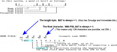

[...] because it made it easier to find the NFA given the LFA when I frequently use the special characters above $7F
Okay, I can see how always including an extra byte (and making that byte =0) gives you a new way to locate the end of a name. In contrast, the FIG method uses less memory but restricts you to only 128 possible characters.
But did you gloss over some details when you mentioned "keeping the alignment" in your 65c02 and '816 Forths? Either I'm missing something or you've evolved the alignment byte into something new and different that isn't really alignment related at all. I say that because aligning to even addresses means the extra byte will be absent about 50% of the time, whereas your end-of-name location scheme will require the extra byte to always be there. (Maybe we don't need to fully resolve this -- I'm okay if we don't.)
Certainly all of this is a LOT more detail than you asked for, noneya! :) Maybe the diagram (below) will help. But as a Forth novice, you needn't feel obliged to immediately master the nuances of names -- especially where non-FIG variations are concerned! Enjoy your Forth experience, and if any other issues come up, feel free to ask!
You're right. Since this was decades ago, I couldn't remember what it was all about (and what I thought I remembered was wrong), so I scoured my notes and code, and come up with this:
    Cells are aligned in this kernel. The ANS decompiling word SEE works out simpler when the first byte of a cell has an even-numbered address. This is the only real reason for the alignment. DOES> compiles a null alignment byte after the JSR _does in the parent word so the CFA following it will be aligned. Interestingly, this also makes _does simpler.
FWIW, I wrote my word SEE before I knew about ANS, or probably before it even came out in '94, but I had called mine VIEW. When I saw that ANS had the same thing but called it SEE, I renamed mine to the standard. SEE is a decompiling word which makes a nice printout of what's in a secondary (ie, colon definition), its NFA, LFA, and CFA, with each cell given the word name if there's a header, the cell number, signed and unsigned value in both hex and decimal in case it's a compiled number, and text if it's a pair of ASCII characters, information might help in certain debugging situations.
