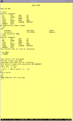

I've just ported Tali forth to my little Ruby 6502 SBC so thought I'd write a few words on it..
But before I do - I'd just like to say (before you get the wrong idea!) I'm not really a Forth enthusiast. I have played with it in the past (Graforth on the Apple II) and been paid to write stuff in it (Porting Suns OBP to new Sparc hardware), but it's not really for me.
However, after chatting to a Forth enthusiast yesterday I thought I'd look at some Forths. I'd already implemented something called Fast-Forth on my system - and looked at some others which were ROMs designed for the Acorn BBC Micro (My system is compatible enough to run some well-behaved software) but I thought I'd have a look at something completely different.
ScotWS's Tali looked interesting, so I got it https://github.com/scotws/TaliForth2 and gave it a go. A couple of false starts later, and with some adaptation for my system and it seems to be working well. At 24K it's 8K larger than the biggest BASIC I've run on it, so another good test.
that's a screenshot of the terminal interface to my system - I load up Tali from the SD card and start it, do the obligatory Hello World and exit. What more could you want :)

I sent Scot a few PMs, but not had anything back, however, in no particular order:
Install the "ophis" assembler which meant installing python. I also changed the Makefile to pick-up the path to the assembler as it seems to use itself and the directory it lives in for it's program segments. I use ca65 normally and can't stand Python, so if that step had not gone well, I'd have given up at that point.
I needed to get the image to 24K. I simply used 'dd' to truncate it to 24K. This didn't initially go well, so had to remove the .advance directives in the platform file. (so the suggestion here is to just generate the 24K image with notes to allow others to bolt-on their own OS bits)
(Also; Linux. Good thing that's what I use... I've no idea how MS Pc/Mac people would cope with a Makefile and Python)
End of line output is NL only, so had to make my putchar routine add a CR. (so again, notes, or an option in the system itself to do the CR+LF thing)
I had to change buffer0 start to higher in RAM for my system ($0E00) I was glad that option was there - and seems to work.
I added some "boilerplate" to the start of the image at $8000 to make it fit better in my system (Gives the application name, copyright in the *help output)
And I think that was it. My initial PM to Scott was essentially "will this break anything" and so-far it doesn't seem to have...
What I would like is some hints to read the input line before forth sees it - the way I do that in Applesoft and ehBasic is to peek at the first character of the input buffer and see if it's a star (*) and if-so, then call my OS, so typing *cat would work, slightly more forth compliant might be star ." cat" but harder to type... The main reason for this is that I then have a means to read text input from a file via the *exec command, so it would make an easy way to get files into the running forth without writing additional words into it to call the filing system.
As my Ruby system is sort-of BBC Micro-like, the binary I've made would probably work on a BBC Micro 6502 2nd processor but I've not had a chance to try it. To make it properly work the start of usable RAM (OSHWM or Page in Acorn terms) ought to be obtained from the OS rather than hard-coding in $E00 but it's not that big a deal here.
I just got some code from another Forth enthusiast to try - failed at a lack of a 'ms' word for some timing - which I understand is going to be very platform dependant anyway, however I may look at the docs to see how to implement it but when I tried to add in the star command stuff it all broke very badly, so I suspect I'm stepping on stack or something else that it didn't like and not being a Forth programmer, some of the acronyms in the source mean nothing to me.
One good point: It seems to only use ZP 0 to < $90 and my OS uses $90 upwards so there was no clash there.
A "nice to have" would be the option to call an operating system routine to get a line of text - my OS supports command-line editing and history and I've changed applesoft and ehBasic to use it (bbc basic and other Acorn languages use it by default) so there is a common-user experience, however I appreciate that the number of users using my system right now is one...
However on the whole, not much harder for me to port than ehBasic.
