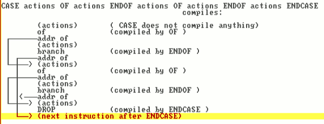

There's some good stuff to think about there. However, I must correct this:
scotws wrote:
though I think under the hood the conditional commenting uses far fewer resources than the CASE, which is really a bunch of IF statements. One way or another, this is a seriously cool trick, and I can't think of another language where you can do something like this. Lisp, maybe?
Here's what my CASE compiles. It's much more efficient than a bunch of IF statements, because of does the comparison and the parameter stack work too, not just the conditional branching.
of, compiled by OF, is a primitive, and the compiled CFA is followed by the address where to go if the test fails. ENDOF compiles branch's CFA, also two bytes, followed by the address to branch to.
I also have RANGE_OF and SET_OF . An example of RANGE_OF would be like "If TOS is in the range of 23 to 51, then do this..." An example of SET_OF would be like "If TOS is in the set of -4, 19, 44, 45, 171, 189, 392, then do..." All these forms can be mixed in any combinations in the same CASE structure.
