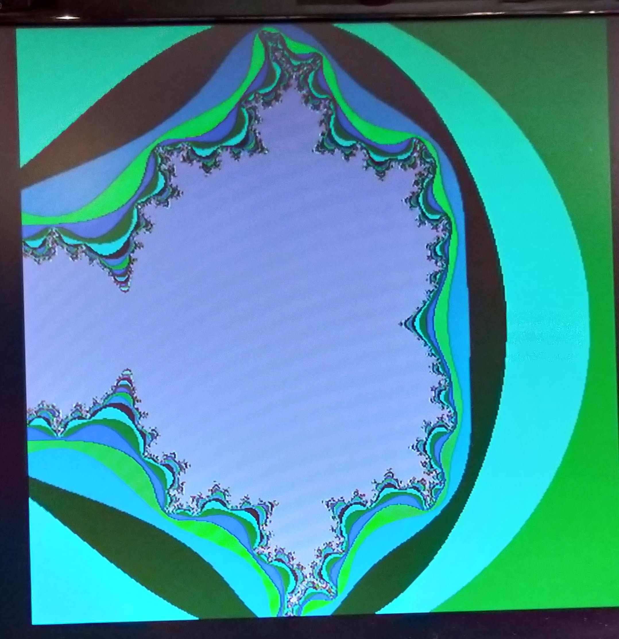

I converted the Mandelbrot routine to output to VGA over a higher resolution on the P2.
TAQOZ
FORGET *MANDELBROT*
: *MANDELBROT*   ;
( NOTE: Adapted from a routine written by Martin H )
20      := #MAXITER
220      := #MAXVAL
-229      := #MINVAL
pub SCALE      5 << ;
20 SCALE   := #RESCALE
\ These variables hold values during the escape calculation.
long CREAL
long CIMAG
long ZREAL
long ZIMAG
long ESCCNT
\ stores the row column values from the stack for the escape calculation.
pri INIT_VARS
  SCALE DUP CREAL ! ZREAL !
  SCALE DUP CIMAG ! ZIMAG !
  1 ESCCNT ! ;
\ Compute squares, but rescale to remove extra scaling factor.
pri ZSQ      @ ABS DUP #RESCALE */ ;
\ Increment ESCCNT and compare to max iterations.
pri COUNT?     ESCCNT ++ ESCCNT @ #MAXITER > ;
\ Performs a single iteration of the escape calculation.
pri DOESCAPE
    ZREAL ZSQ  ZIMAG ZSQ 2DUP +
    #RESCALE 4* > IF
      2DROP TRUE
    ELSE
      - CREAL @ +   ( result )
      ZREAL @ ABS ZIMAG @ ABS #RESCALE 2/ */
--- workaround for */ sign bug
      ZREAL @ ZIMAG @ XOR 31 >> IF NEGATE THEN ( result val )
      CIMAG @ + ZIMAG ! ZREAL !
      COUNT?
    THEN ;
\ Iterates on a single cell to compute its escape factor.
pri DOCELL ( row cell -- )
  INIT_VARS BEGIN DOESCAPE UNTIL
--- expand the color and plot the pixel
  ESCCNT @ 11 W* PIXEL! 1 X+!
\ For each cell in a row.
pri DOROW     #MAXVAL #MINVAL DO DUP I DOCELL LOOP DROP ;
\ For each row in the set.
pub MANDELBROT
  CLRSCR !PALETTE TL
  #MAXVAL #MINVAL DO 1 Y+! 0 x I DOROW LOOP
pub ZOOM ( n -- )      SCALE ' #RESCALE :=! MANDELBROT ;
\ Run the computation with defaults
pub GO         200 ZOOM ;
END

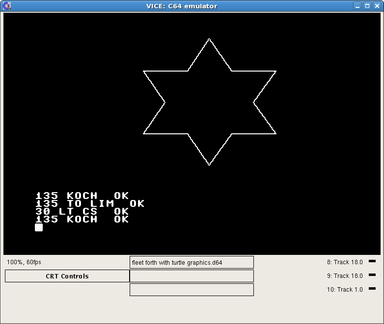

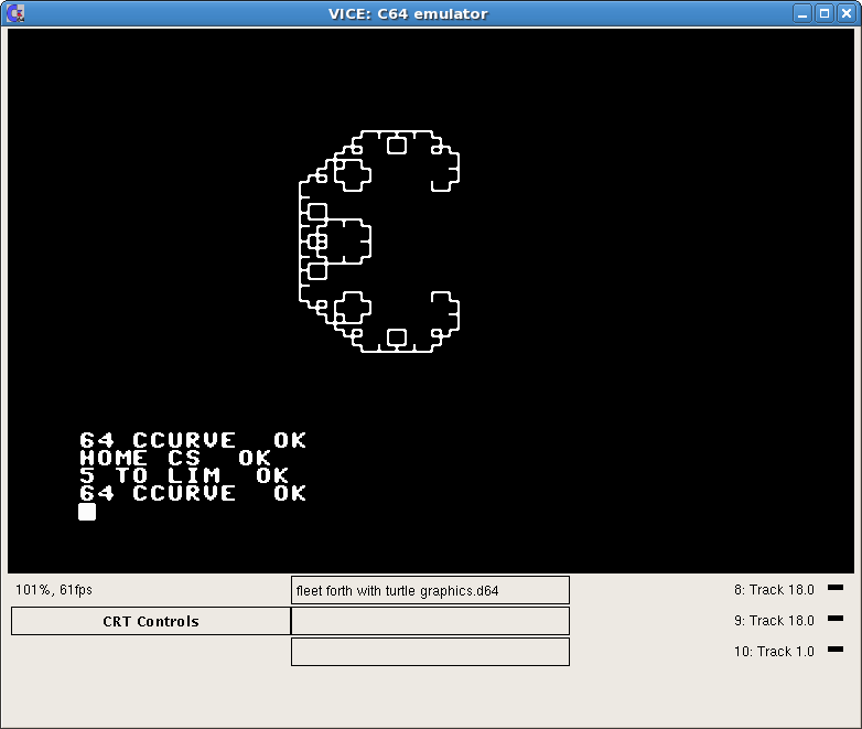

PostPosted: Sat Mar 06, 2021 1:25 am
Posts: 858
The last time I wrote anything with trees was not in Forth or the 65XX family of processors so here are examples of recursion with turtle graphics. The first draws a C curve similar to a Levy C curve but this one skips every other step.
30 VALUE LIM
: CCURVE  ( SIZE -- )
   DUP LIM < IF  FD EXIT  THEN
   90 LT DUP 2/ RECURSE
   90 RT DUP 2/ RECURSE  DUP 2/ RECURSE
   90 RT 2/ RECURSE
   90 LT ;
This version stops the recursion when the line length is less than the value of LIM .
Setting LIM to 5 and executing CCURVE with 64 on the stack produces the following image:
This version limits the recursion based on the depth of recursion:
: CCURVE  ( SIZE DEPTH -- )
   ?DUP
   IF
      1- SWAP 2/ SWAP
      90 LT  2DUP RECURSE
      90 RT  2DUP RECURSE  2DUP RECURSE
      90 RT  RECURSE
      90 LT
      EXIT
   THEN
   FD ;
With this version, the following will produce the same curve:
64 4 CCURVE

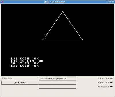

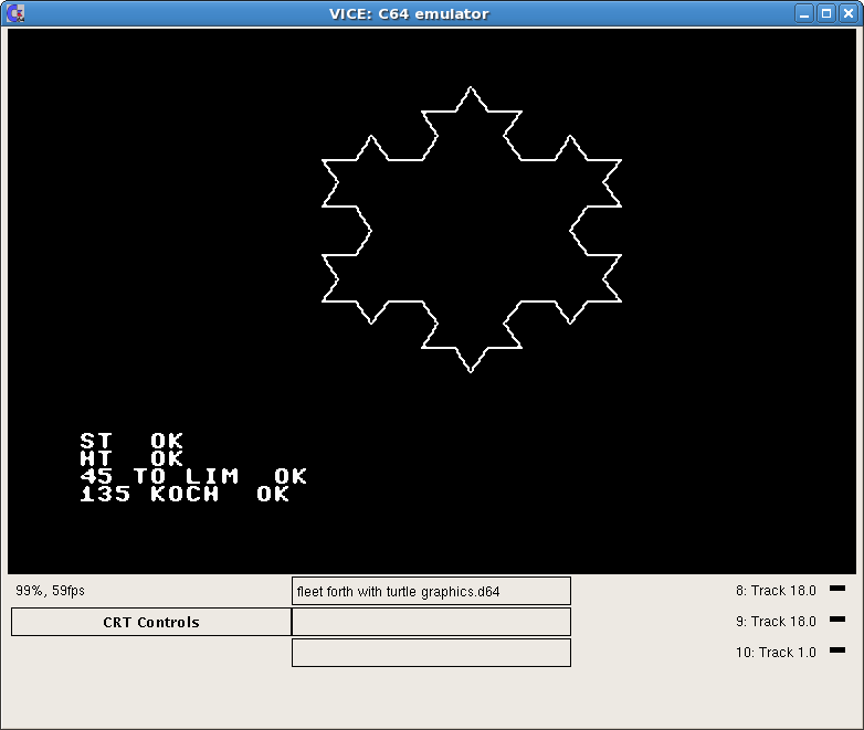

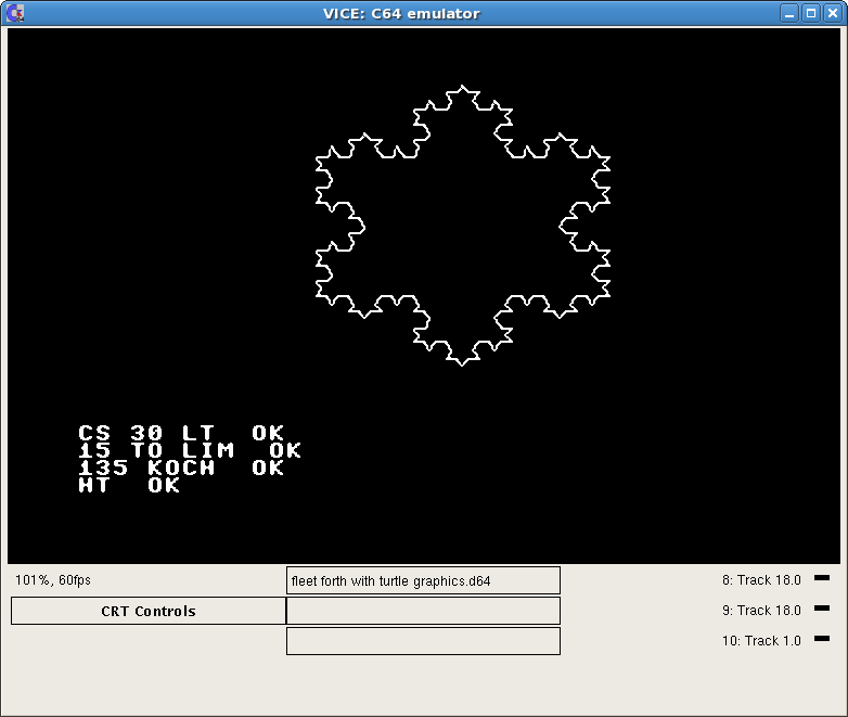

This draws the Koch snowflake:
: KOCH/3
   DUP 3 / RECURSE
   60 LT DUP 3 / RECURSE
   120 RT DUP 3 / RECURSE
   60 LT 3 / RECURSE ;
: KOCH 30 RT
   3 0
   DO
      DUP KOCH/3 120 RT
   LOOP
   DROP 30 LT ;
This example could ( and maybe should) be rewritten to limit recursion by depth. Here are a series of images based on depth of recursion:
Notice the brevity of the code versus the complexity of the images. With a higher video resolution, these words could achieve even more complexity of the image just by setting the recursion depth deeper ( with a larger starting size). With the second version of CCURVE and a system that had much higher video resolution, just think what 1024 8 CCURVE would look like.
