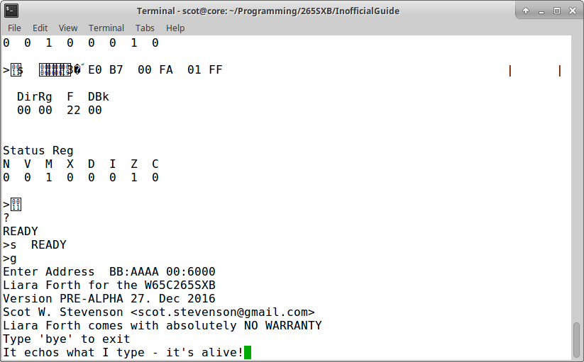

Ha! Milestone: It worked in the emulator, and now it works on the machine.
Now, all it does is print some strings and then echo what is typed, but since that proves the calls to PUT_CHR and GET_CHR work as intended, that takes care of most interface problems with the Mensch Monitor.
(Of course, I could have had this working four hours earlier if I hadn't stupidly forgotten to re-enable interrupts before calling PUT_CHR. What a difference a byte makes, right?)
