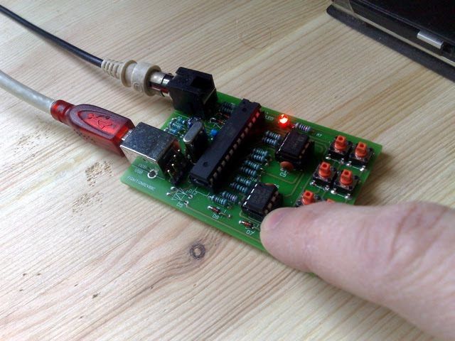

I know this is a liitle outside of 6502-related information, but I think this is a neat package and wanted to share a little obout it.
Figntion uses an AVR microcontroller to run a close derivitave of FIG Forth. It is USB powered and has text video output (PAL right now but the author told me NTSC is easy to provide). Forth code is run from a serial RAM yet the author claims the overall speed is better than most 8-bit computers of the 70's & early 80's.
He will be opening up the source code in the near future, which should be interesting to see as well.

A nice machine, for only 20 pounds, and as he says, it's self-hosted - thanks for the link.
(Could be on-topic, if it runs a 6502 emulator!)
Hmm... that really is an 8-key input device - I'd supposed perhaps a USB keyboard might be usable, but no, it's an ingenious chorded input system:
Reading on, I see you can also save source files to the device by treating it as USB storage.

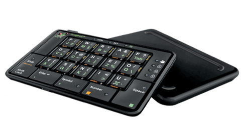

Over the years, I have tried to devise minimal keyboards that could do everything the big ones can, just with a speed-for-size tradeoff, and this may be as good as any. Fignition's description could use some improvement though.
For one-handed typing, and fast--40wpm with practice--there's the patented FrogPad but it's not as small, and it appears that such efficiency depends a lot of having the right shape of keys around the outside and a light touch. It would be nice if it would catch on as a standard.
I guess if you can plug in a standard PC keyboard, you could plug in a FrogPad.

I'm aware of the FrogPad, it's good and I once considered buying one - I wish they still had the tactile one on their website, but the store only seems to show the Magic Frogpad :? . There's quite a history of chordal keypads from the old Xerox alto chordal keypad:

I had a number of design constraints if I wanted to produce a viable one of my own:
    • I couldn't risk falling foul of anyone's patents.
    • I couldn't afford many keys on the keypad (that is, it would add too much to the final product cost IMO).
    • I couldn't afford a full Sinclair-style membrane keypad for the same reason.
    • I wanted to retain some proportionality in the design.
    • I didn't want to use a keyboard protocol, e.g. PS/2, because FIGnition is really about understanding principles and although PS/2 keyboard protocol has a practical value, it embodies no long-term principles outside of serial comms.
    • I wanted to leverage mobile phone layouts to make it easier to learn.
My result, the FIGnition's keypad: let's call it the FIGgyPad, simply extends the concept of applying shift to every key on the keypad combined with a layout reminiscent of mobile phones. Easy to learn, simple to build, simple to write a driver for; cheap, practical and unpatentable. The keypad driver is in the currently released FIGnition source code on GitHub and both the hardware design and software are free to use and always will be (though copying the driver means crediting the author).
I take your point about the description and I'll think about how it can be better described, unless someone beats me to it.
