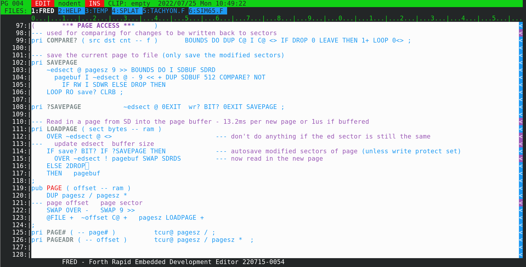

I've have been reading some of these posts and found some of the comments interesting as I had written a screen editor a couple of years ago that used the ANSI terminal. More recently however I enhanced it greatly to allow full ANSI key operation, highlighting, and multiple file tabs etc. At present this version operates with my Tachyon extensions including the filesystem running on top of Mecrisp on the RP2040 chip. I am using this editor to develop a full suite of dev tools to run on any Forth system that has maybe about 8k of RAM or more (the RP2040 has 264kB internally). Power to the Forth!
The editor has become more of an IDE since I can compile and run code and invoke the logic analyzer module etc. I still need to finish a multipass macroassembler which will produce a clean and flat listing and output file. While this is geared for the RP2040 I see no reason why I can't backport it to some of my older 65xx systems including the M37702 etc where I had lots of RAM.
BTW, rather than raw blocks, I handle a standard FAT32 file in pages of 32 lines of 128 characters and terminate each line with a CR. This makes the file compatible with PC text editors but makes it possible to edit the file in 4k pages although the page length can be adjusted up to 64 lines. The clipboard is in RAM but I may make it hybrid with a file to allow for systems to use less RAM. ^F10 will compile code from the clipboard or if empty then from the current page rather than F10 which compiles the whole file. A null terminator(s) marks the logical end of a file.
Normally I use VScode but I am loving the ease of use of this editor with intuitive controls. Plug my board in, type ED and it restores the last multi-tab session complete with cursor position and theme etc.
