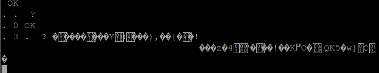

Somewhat related to the stack underflow issue mentioned before... On my system, underflowing the stack with a . results in the following output:

PostPosted: Wed Jul 24, 2013 6:41 pm
Posts: 904
Another weirdness: I can't edit the line being typed. Backspacing looks right, but the interpreter complains. For instance if I type in
10 SPADES and back up to correct it to say 10 SPACES, I get an error. Is that normal behavior or is it something to do with my terminal sending wrong backspace characters?

It does sound like the old backspace vs. delete character problem.. it used to be such a hassle when using terminals on older Unix systems.

PostPosted: Wed Jul 24, 2013 11:47 pm
Posts: 1004
The characters for backspace and enter are actually "hard coded" in the EXPECT routine.

PostPosted: Wed Jul 24, 2013 11:50 pm
Posts: 904
My terminal sends $08 as backspace; FIG-Forth defined it as $7F with a DW at the top... I don't know what words use it, but changing it fixed the problem.

PostPosted: Thu Jul 25, 2013 3:44 am
Posts: 1004
Well, that was my Fig listing, I know I changed to the $0A for end of line due to how my simulator works, being I'm on a Mac. The $08 may have well been a $7F originally as well.
