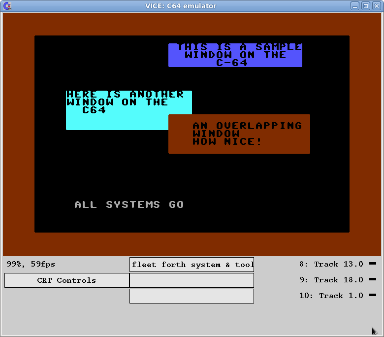

I've only used code page 437, which clearly the C64 doesn't use.  I haven't thought about how I'd use the C64 character set (including function keys), but CP437 is sure nice for the special characters, drawing boxes, and the Greek letters we use all the time in engineering (since that's what I'm always using Forth for).
I remember code page 437. I haven't seen it since my days of using DOS.
The visual appearance of text windows can be created on the C64 using reverse video. Ctrl-R on the C64 selects reverse video and Ctrl-0 ( control zero) selects normal video.
Here is were I selected a black background and white text and played around on the screen by selecting and deselecting reverse video. I typed the text with spaces to achieve the look of windows.
I normally use reverse video on the C64 to highlight important information.
Fleet Forth has the words RON to switch reverse video on and ROFF to switch to normal video. A carriage return also switches reverse video off.
