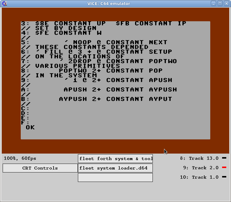

I added more comments to one screen for the assembler. This is what each version of LIST shows.
0 FH LIST
SCR# 2056  1 8
0: // SYSTEM CONSTANTS
1:
2: $85 CONSTANT N   $8D CONSTANT XSAVE  // THESE CONSTANTS WERE
3: $8E CONSTANT UP  $FB CONSTANT IP     // SET BY DESIGN
4: $FE CONSTANT W                       //
5:       ' NOOP @ CONSTANT NEXT         // THESE CONSTANTS DEPENDED
6: ' FILL @ 3 + @ CONSTANT SETUP        // ON THE LOCATIONS OF
7:      ' 2DROP @ CONSTANT POPTWO       // VARIOUS PRIMITIVES
8:      POPTWO 2+ CONSTANT POP          // IN THE SYSTEM
9:       ' 1 @ 2+ CONSTANT APUSH        //
A:       APUSH 2+ CONSTANT AYPUSH       //
B:      AYPUSH 2+ CONSTANT AYPUT        //
C:
D:
E:
F:
 OK

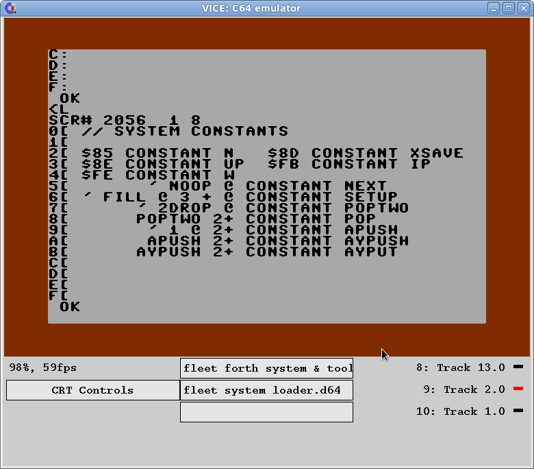

<L
SCR# 2056  1 8
0[ // SYSTEM CONSTANTS
1[
2[ $85 CONSTANT N   $8D CONSTANT XSAVE
3[ $8E CONSTANT UP  $FB CONSTANT IP
4[ $FE CONSTANT W
5[       ' NOOP @ CONSTANT NEXT
6[ ' FILL @ 3 + @ CONSTANT SETUP
7[      ' 2DROP @ CONSTANT POPTWO
8[      POPTWO 2+ CONSTANT POP
9[       ' 1 @ 2+ CONSTANT APUSH
A[       APUSH 2+ CONSTANT AYPUSH
B[      AYPUSH 2+ CONSTANT AYPUT
C[
D[
E[
F[
 OK

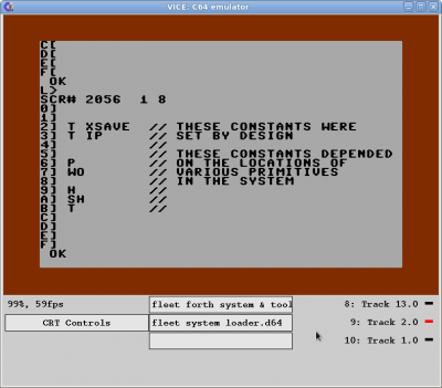

L>
SCR# 2056  1 8
0]
1]
2] T XSAVE  // THESE CONSTANTS WERE
3] T IP     // SET BY DESIGN
4]          //
5]          // THESE CONSTANTS DEPENDED
6] P        // ON THE LOCATIONS OF
7] WO       // VARIOUS PRIMITIVES
8]          // IN THE SYSTEM
9] H        //
A] SH       //
B] T        //
C]
D]
E]
F]
 OK
This is what it looks like on the Commodore 64.
Notice each version of LIST appends a different character to the line number. This is to support the new screen editing words.
The words 0[ through F[ only alter the first 36 characters of a line and the words 0] through F] only alter the last 36 characters of a line.
The original version of LIST which shows everything on each line is acceptable and the version which shows the first 36 characters of each line is acceptable. The version which shows the last 36 characters on a line doesn't show enough of the beginning of each line. It's almost like editing the end of the line blind. The block could initially be displayed with the original LIST and the source typed in using the screen editing words 0: through F: . The other versions of LIST and the screen editing words 0[ through F[ and 0] through F] could be used to edit the existing source.

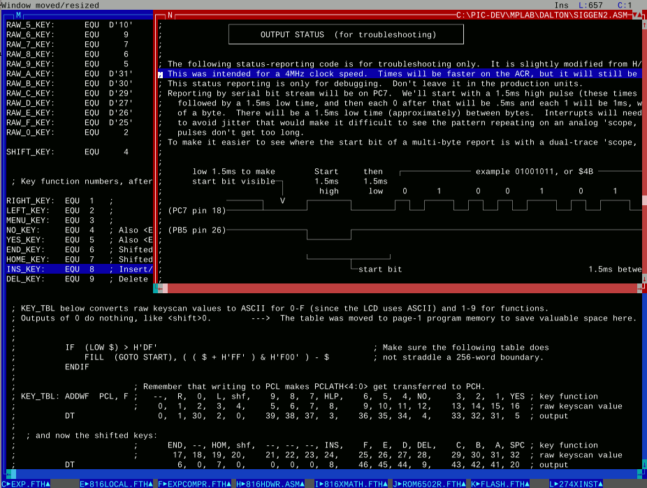

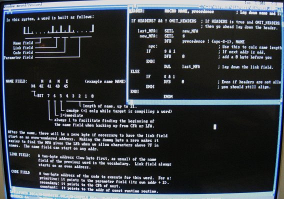

I've only used code page 437, which clearly the C64 doesn't use.  I haven't thought about how I'd use the C64 character set (including function keys), but CP437 is sure nice for the special characters, drawing boxes, and the Greek letters we use all the time in engineering (since that's what I'm always using Forth for).  The Epson dot-matrix impact printers, which Epson is still making about nine models of, use the same character set, so I use it with the workbench computer too, although they don't display correctly in its small LCD unless I make custom characters in the LCD, which I've done before but is kind of a lot of overhead.  My exception to the 437-only use is my HP-71B hand-held computer which defaults to the ROMAN8 set which is kind of similar but has different byte values for the special characters; but after the HP Thinkjet printer I was using with it went down and I started using the Epson printer, I loaded the CP437 character set into the HP71 computer so things would display correctly in its LCD.  Here are a couple of examples of my uses of the box-drawing characters:
(although that last one was for a PIC16 project, not 6502).  CP437 also lets me have Forth word names like ±½°C or 10KΩ or put Φ2 in the comments.
