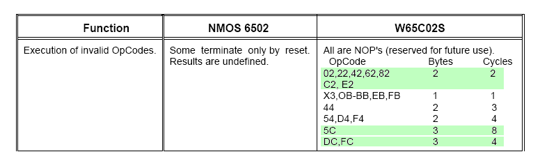

MichaelM wrote:
opcodes that operate as NOPs but also skip two bytes: $5C, $DC, $FC
Yes. On 65c02, $DC and $FC can be used for the skip-two-bytes trick. Unlike $2C (BIT absolute), they have the advantage of leaving the flags unaltered. :) But, unfortunately, the same warning applies. Although the 65c02 bills them as NOPs, opcodes $DC and $FC do produce a memory reference -- a read -- using absolute addressing mode (just as $2C does). They qualify as NOPs only because the result of the read is discarded. I describe the "Load And Discard" operation in more detail on my web site here.
BTW $5C could perhaps be used for the skip-two-bytes trick, but I see no advantage. And $5C is much slower.
cheers,
ETA: On the subject of skipping one byte:
On the 'C02, opcodes $02, $22, $42, $62, $82, $C2, and $E2 all equate to "Load And Discard" but using immediate address mode. Unlike the absolute mode examples above, no extra memory reference is generated, so the caveat doesn't apply -- you may use these freely to skip over one byte of code. For 'C02 you can choose any of these opcodes; they all behave identically. Interestingly, on '816 $42 still has the same behavior, although it's been dubbed "WDM." But the skip one byte trick still works on '816 as long as you choose $42. :)
Formal documentation re the 'C02 NOPs is extremely scarce. The WDC datasheet lists the bytes and cycles but nothing more. In the excerpt below I highlighted the NOPs mentioned in this post.

As usual, Dr Jefyll has some excellent observations.
Since I implement all unused 65C02 opcodes for my 65C02-compatible processor cores as single cycle NOPs, it did not occur to me that the implied cycle to read/write a memory operand would actually be performed. This behavior is not likely to be visible to Klaus' 65C02 functional tests since any effects would be discarded. (Note: my processor core can support these behaviors with some minor updates to the microprogram, but I would not have implemented any read/write memory cycles; it just would not have occurred to me to do so because of the side effects that Jeff describes.)
I have not dug into hoglet's R65Cx2 core to see if it would perform the implied memory cycle; it certainly appears to perform no operation on the CPU registers as would be expected.
