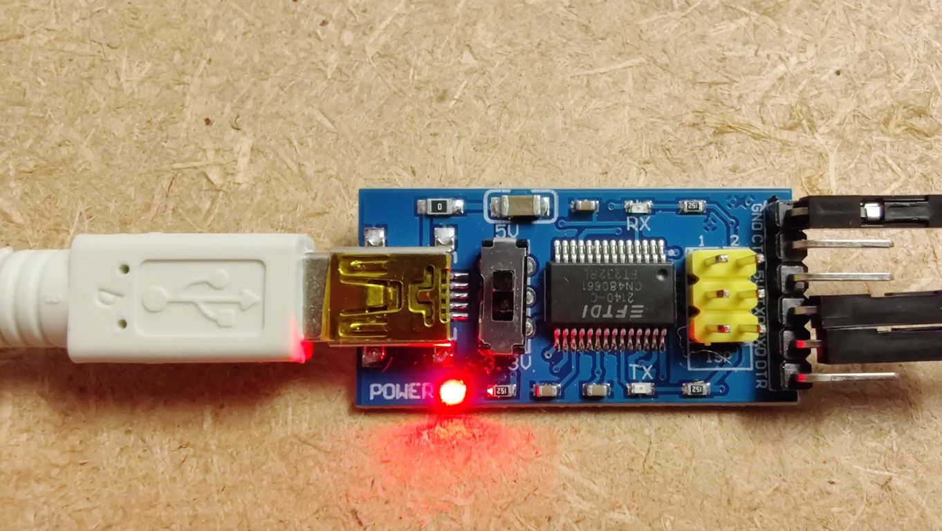

Now, regarding your second post... I have an apology to make. My throwaway comment "I have no handshaking yet. That is my next thing to sort out." should have been qualified. I have all the code ready in another program - I just need to copy and paste it into Tali. What I meant was I don't have the hardware set up to actually use RTS/CTS. So, I am really sorry. You must have spent an age typing all that.
I use a TTL to USB converter - it has RX, TX, DSR and CTS pins. Now, in relation to my SBC, CTS is an input (as far as I understand it - it means "the other end is ready to receive data". What I need is an RTS output, i.e. when the SXB sets RTS false it means stop sending me data. Why then this little converter thing has a pin marked CTS is strange. I perhaps need to buy a different converter.
PostPosted: Tue Nov 29, 2022 6:49 pm
Posts: 255
Regarding the hardware part of the handshaking, you have everything you need. In the same way you had to connect the R65C51's RX to the PCs TX (and vice versa), you also cross the handshaking lines. The RTS (Request To Send) output from the R65C51 ( pin 8 ) connects to the CTS (Clear To Send) input of the PC. That way, when your single board computer requests data the PC knows it's clear to send it right then - and when your single board stops requesting data (because it's buffer is full) the PC knows it's not clear to be sending data at that moment and it will wait until it's clear to send again.
This kind of handshaking can be bidirectional, but it's often used in just one direction for a faster device to talk to a slower device. The older USB->TTL_RS-232 adapters used to bring RTS out on the last pin, but modern ones swapped it with DTR specifically for Arduino boards so that opening the serial port resets the micro into bootloader mode (you used to have to press the reset button yourself on ancient Arduinos when downloading a new firmware). Regardless, you don't need the handshaking in the other direction because your PC will never need to ask the single board computer to slow down on sending serial data. You just need to add one wire to the CTS pin on your USB adapter over to RTS on your single board computer, change your terminal software to use hardware handshaking, and you should be ready for handshaken (handshook?) serial.
One note about FTDI adapters that bit me. They don't stop transmitting immediately after you deassert RTS and can send up to 3 extra characters - that info is buried on their website in an old FAQ: "If CTS# is logic 1 it is indicating the external device cannot accept more data. the FTxxx will stop transmitting within 0~3 characters, depending on what is in the buffer." Garth's buffered reading helped with that, as it asks the PC to stop when there are about 15 characters left in the buffer.

Thank you sir! My handshooken SXB is working perfectly! I don't really know how to thank you more. I'd buy you a beer but I suspect you may be a loooooooooooong way from me!
