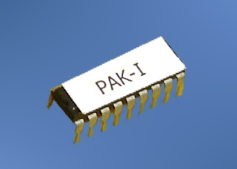

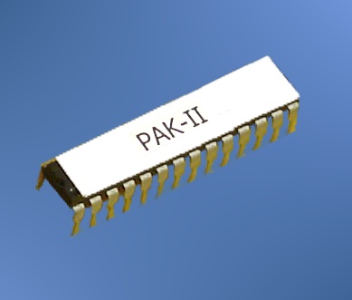

On a semi-related note, I am thinking about implementing a complete suite of floating point, based on the simple expedient of calling the PET ROM math routines and passing things around as 24-bit values on the stack.
I will mention that there are small (18- & 28-pin DIP & SOIC), serially interfaced 32-bit floating-point coprocessors avaiable at http://www.awce.com/pak1.htm .
