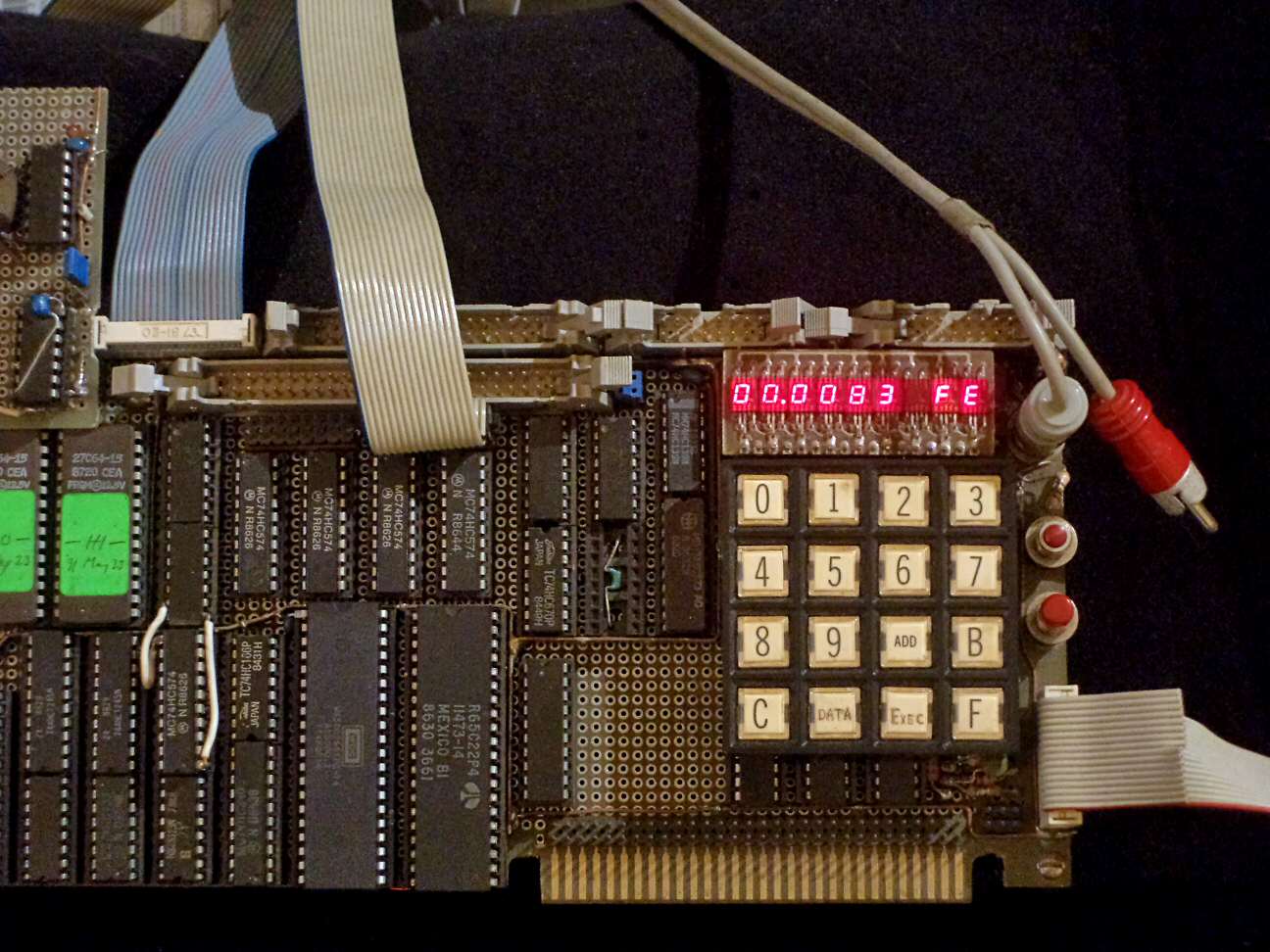

In another thread I mentioned 'C02 undefined instructions, and was speculating on whether the Rockwell and WDC chips treat these "illegal" opcodes the same way. After installing a WDC CPU in the KimKlone I'm convinced they do.
I admit it was a thrill to see this comparatively ancient computer boot up with an updated CPU, and I did a little photo session that day -- a portrait, as it were, of the machine that occupied so much of my time, both in its creation and in the following years as a tool used day-to-day (in the same manner as Garth's Workbench Computer). Today for some Friday-afternoon frivolity I decided to share a few of those shots. (Older pix can be seen here.)
The KK included quite a lot of stuff that was rarely or never used, and the keypad and LED display (above) are definitely in that category. But, on the plus side, I notice the LED display photographs quite nicely! :D In this shot, the machine monitor is running and the address and contents of a zero-page location are displayed. (KK uses six-digit addresses).
Pin 1 of the WDC cpu (VPB) is bent outward so as not to engage the socket. The removable daughterboard at the top left is an RC oscillator, adjustable via trimpot for test purposes. Its output (presently 80 MHz) gets divided down to supply video and CPU clocks.

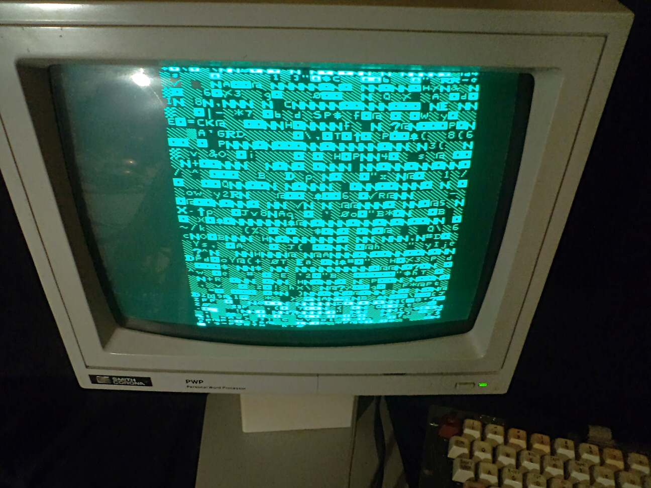

Here's the video display, showing mostly just power-up garbage in RAM. The video format is extremely flexible, but defaults to 16 kilohertz scanning suitable for re-purposed NTSC televisions. That limits us to 32 characters per line -- which I found to be adequate or even preferable when the material viewed is Forth source code!
