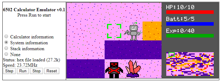

Great. I got everything working. The character data and drawing code is about 1k. It fits into 16k with your cut down version with about 700 bytes to spare. Is the extra 5k of data in addition to the 9k or so of code word lists and stuff?
Just FYI, you *might* want the assembler (you can easily mix assembly and forth words in Tali2) and remove some of the other words instead.
The extra code space might be more valuable for this project. Seems like I could cross assemble instead and store the entry points in a table then use Forth to jump into assembly, but I haven't tried yet.
16K of RAM should be way more than enough for Forth, as most of the dictionary and starting words live in ROM
Hopefully the code and graphics data will both fit. Hmm, could I change the dictionary pointer to compile some words to a different 16k bank and run the code from there that doesn't access the screen which uses the same 16k bank? That worked really well in CC65.

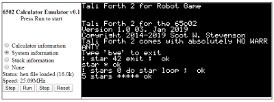

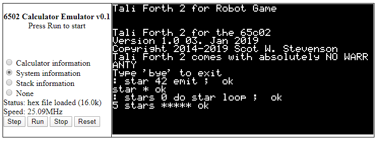

File comment: CC65 version of Robot Game running on JavaScript emulator
File comment: Tali Forth 2 running on JavaScript emulator
Congratulations getting things working! Your robot game looks interesting, but I can see why you need so much space. I can take a look at the bonus 5K (probably tomorrow). I suspect there are some strings that you could do without.
Yes, you should be able to do that. Place an address on the stack and use the word EXECUTE and it will jsr there.
