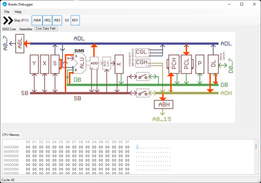

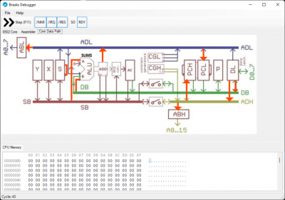

After many years of research and experiments I think it is time to present you the result - the 6502 simulator (or emulator) on the gate level - Breaks Debugger.
https://github.com/emu-russia/breaks/re ... s-debug-17
(If you're interested you can read the development history of previous versions there)
The Debugger consists of two parts - GUI in c# to display the internals of the processor and native code in c++ which contains the actual emulation of the processor. When you click on the "Step" button, the processor performs one half-cycle and the GUI shows you what's there. The debugger also includes a simple assembler that compiles a 64 Kbyte memory blob at once.
The data flow diagram for the lower part with slight modifications is taken from the dissection of 6502 by ttlworks. Thanks ttlworks! :)
It is possible to dump the internals as Markdown with pictures, for this you need to create a folder WikiMarkdown, where results will be stored.
An example of what results can be seen here: https://github.com/emu-russia/breaks/bl ... /ops/A2.md
Source code of the 6502 emulator here: https://github.com/emu-russia/breaks/tr ... /M6502Core

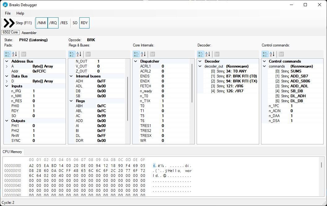

It was a great joy to see how the 6502 uses S as a temporary during JSR!

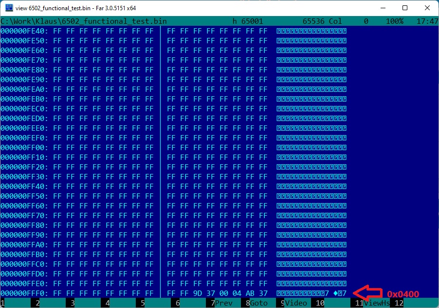

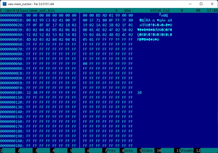

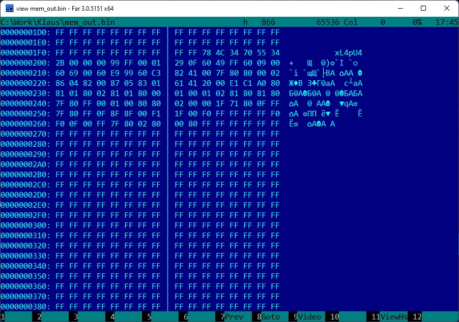

All functional tests of the 6502 by Klaus Dormann are successful.
I ran the unit test with these parameters:
   "CompileFromSource": false,
   "MemDumpInput": "6502_functional_test.bin",
   "AsmSource": "Test.asm",
   "RamStart": "0",
   "RamSize": "0x8000",
   "RomStart": "0xc000",
   "RomSize": "0x4000",
   "RunUntilBrk": false,
   "RunCycleAmount": true,
   "CycleMax": 120000000,
   "RunUntilPC": true,
   "PC": "0x3469",
   "TraceMemOps": false,
   "TraceCLK": true,
   "DumpMem": true,
   "JsonResult": "res.json",
   "MemDumpOutput": "mem_out.bin"
The original image was slightly patched (RESET = 0x0400).
The state of the registers and the CLK on the output:
{"A":"0xF0","X":"0x0E","Y":"0xFF","S":"0xFF","PC":"0x3469","C":1,"Z":0,"I":0,"D":0,"V":1,"N":1,"CLK":96241361}
