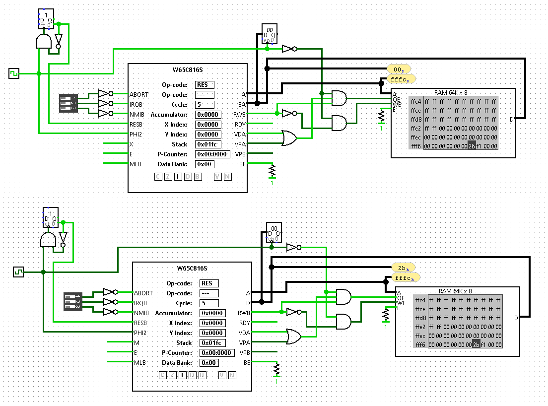

Is anyone familiar with writing Logisim libraries? I've written a (half) cycle accurate 65c816 emulator that I had intended to drop into Logisim but I do not understand how Logisim's port propagation works.
If you take a look at the image below you'll see that the value on the bus port D is 'C9' but the value I read off that port is zero. 'C9' does eventually appear on the port but only after I'm long done ticking the CPU.
I'm guessing it's because it takes a while for the simulation to settle between each clock tick but I'm at a loss as to how to handle it.
Any help would be great! Ta, Andrew

Welcome, Andrew, sorry to say I can't help. Is there a waveform view or similar which will show the time-varying behaviour of the bus?
As the databus is bidirectional it may need special handling of some kind: event driven simulators don't always have a graceful way to handle data propagation in both directions.

Logisim does model propagation delays but only in certain limited circumstances - circumstances I can't find any real documentation on.
However all of that said I think it's a much simpler program bug on my part. I've been using Solra Bizna's 6502 Logisim emulator as an example and, reduced to the simplest possible state of just reading the data bus, his works and mine does not. Even though they look pretty much identical to me. I'm just going keep slogging looking for the difference. It could be worse, I could not have a working example to compare mine to :?

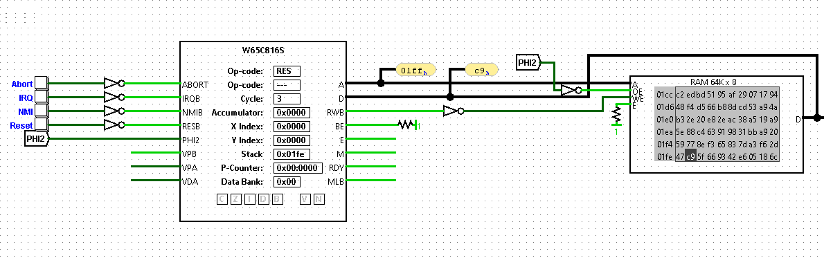

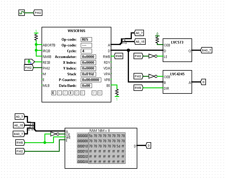

In the end it turned out it was 'just' a Logisim propagation issue. The short of it is that doing a read from memory takes a few steps to settle before the propagation cycle ends. However I only want the CPU to truly tick on the very last cycle once everything has settled. A bit of a problem as Logisim doesn't seem to have hooks for notifying me when a propagation cycle is starting or for when it's done.
Still a small hack and I can tell I've transitioned from a stable state to a new propagation cycle. Built on that is a slightly larger (but pretty robust) hack that only moves the CPU into its new stable state at the start of the next propagation cycle rather than at the end of its actual propagation cycle.
Long story short: WHY DID WDC MULTIPLEX OUT THE BANK ADDRESS ON THE DATA PINS, why not re-use the address pins instead? Gaaaaaa! Writing out the BA on the data pins a half-cycle before a read on those same pins caused Logisim no end of grief. But in the end any complex circuit with half-cycle reads/writes would have been a problem - regardless of the pins multiplexed. It's probably better I discovered that sooner rather than later.
Above you can see a simple circuit that correctly latches in the Bank Address (zero in this case) when the clock is high and also correctly reads 2b out of memory when the clock is low. It happens to be pulling the low byte of the RESET vector in the picture. That was quite an adventure :shock:
The way they did it makes all 24 address bits valid at once, well ahead of the rise of phase 2, for an early start at address decoding, as required by many of the 65xx I/O ICs which must have their chip selects, register selects, and R/W signals all valid well ahead of the rise of phase 2. What I wish they had done is just go to a 48-pin DIP (or better, a PLCC), with no multiplexing.

As Garth said, it is so the entire 24-bit address is presented at the same time and during Ø2 low. Sequentially emitting the address in two parts would result in a timing nightmare of the worst kind.
The historical reason for multiplexing A16-A23 has to do with Apple's desire to stay with the PDIP-40 package. In those days, SMT package forms, such as PLCC and TSOP, were barely in their infancy and there was some resistance to moving away from the DIP format that had long been in use. With 40 pins on the PDIP package, there wasn't any way to make A16-A23 appear as separate outputs. Hence the MUXing.
As Garth noted, it would be nice if the MUXing "feature" were eliminated by offering the 816 in a bigger package. The next size up in PLCC would be PLCC52, which would offer enough pins to bring out A16-A23 on separate connections. It could also be done in PDIP48, although that would make for a bulky package that might also have some subtle electrical issues with ground bounce (the PLCC package has multiple ground pins).

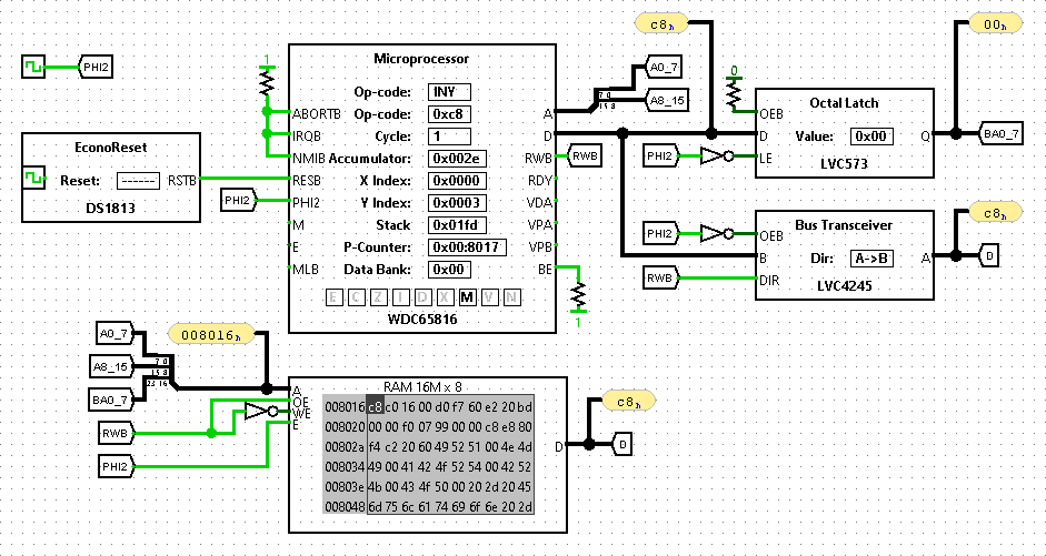

Tiny update I'm using mostly as an excuse to post more pictures.
The pull request I submitted was rejected which I kind of both can and can't be a bit miffed about. I didn't follow their coding guidelines even though I'd followed an existing pattern. That shouldn't have been a problem; I just had to rename the bad method and commit. Except I'd done a bunch of other experimenting in the branch I'd submitted and that would have all gone too. In the end I got into such a tangle of branches trying to get only the commits I wanted that I had to delete and re-fork the whole project. Gah.
On the brighter side I may have found a better work around if my new pull request is also rejected. It's not pretty but seems to be the existing pattern (again) for determining if the simulation has completed a tick.
The EconoReset was a bastard to write. A component without a connected clock does not tick but the EconoReset should be it's own clock and tick internally for however long the reset line needs to be held low. In the end I finally just embedded a clock in the thing and gave up.
