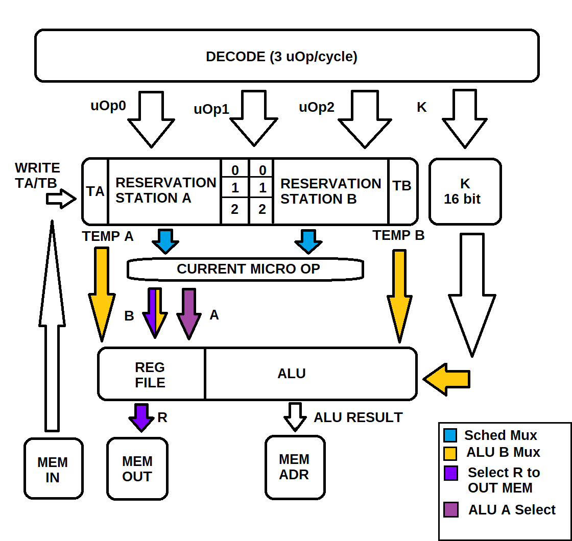

Hello everyone.
As a personal project i am trying to create a fast 6502-like CPU.
This "evolution" (prototype of) of 6502 drop 8 bit opcode scheme. Sorry. Even Intel, when it noticed that 8080 was wasting half of opcode space, decided to recode the whole thing, while keeping it assembly compatible. I am trying to do the same. 99% instruction level compatibility is a goal. Some things are simply too much effort for too little gain. On the good news, for one, RMW instructions are not dropped, only scheduled later. Plus, if i am able to, i will expand RMW with one instruction: DEP (DEC if the memory is not zero) for atomic operations.
Project Goals:
- All addressing modes are preserved, some are merged.
- All implemented features are fast. There is no point on investing time to implement instructions and then recommending against their usage.
- Registers added are already present in past official extensions. The two additions are B (second accumulator) and Z (zero page pointer), Z is conventionally Z, but writable.
- Instructions can operate on bytes or words when memory is involved.

Design:
- Highly regular encoding scheme with 16 bit/32 bit
- 2 State front-end pipeline + 3 stage back end pipeline of fragmented operations (uOP, to say)
- Yes, it is a complex design. In fact i completed the first version of the internal micro core. That i will need to modify further to implement ROR/ROL/DEP/ADC/SBC.
"Completed" here is a placeholder for "Logic Gates for the full implementation are there, but there is no tests yet".
- Logic gates simulation first. Because i am bad at planning projects.
- IF stage fetch and reorder the instruction.
- ID stage translate 16 bit opcode in 1-3 20 bit uOps.
- SCHED stage pick a ready uOP from one of the Reservation Stations and put it in the Scheduled_Instruction_Register. 80 bits of MUX x2, YAY!. At least that's all the work that this stage need to do.
- ALU stage pick A register and a B register, then it select one from B, K or T (temp storage of the RS) for the second input of ALU. B is always forwarded to Mem. ALU can store the register back to the Register File or write the MAR register to start a memory cycle.
- MEM stage start with the address in the MAR register, it wait for RDY signal and then write to TA or TB (Temp RSA or Temp RSB)

First of all: this will not run at 10khz. The Intel Nehalem core run at 500 khz on 4 Virtex FPGA. I think i cannot do worse, so at a minimun this will run at 500 khz.
Second: memory is a bottleneck of any 6502 or 6502-like* CPU, to avoid the inevitable death of the clock frequency i had to make the MEM step as empty as possible, the mem bus see a single 16 bit mux on TA/TB, operated by the Load Flag in front of each Flip Flop. On FPGA this MUX is already here, so MEM has no additional delay at all.
If i stopped there, there would have been a dead cycle after each memory access, so i had to find a way to make good use of this single dead cycle. So i decided to reuse it for address generation of other operations. The reuse rule is:
Called Main (M) the first allocated operation, Next the other allocated operation; u0 is the Main last uOp, uNext is the Next candidate uOp, uMain is the current executing uOP
Provided that:
uMain has written MAR and the end of an ALU stage (beginning a memory access)
Main is not a store (possible memory hazard, Main is a store if one of u0 or uMain write mem)
uNext A register is not u0 D (WAR)
uNext B register is not u0 D (WAR again)
uNext is not the final uOp of Next (If it were, execution would be out of order, a much bigger core and a much better Me is needed for that)
Then
uNext can be executed instead of stalling

Re: Personal 6502 "evolution" project
Update:
i completed the Opcode -> micro-Op decoder. Now i am debugging it and debuggin the Back-End too.
I will update my github once i am almost sure it works, at least for the testbench (testbench being a memcopy implementation).
I also re-read my intro for this topic. I feel i can read it because i am the designer, but it isn't very clear to anyone else.
Just to be sure, i will dive a little more in the details, beginning with the Back End.
Ok, after cores are classified. We need to introduce others, importants terms.
Micro-Operations
A large (Pentium Pro had 118 bits micro-ops) and minimally encoded operation that activate or deactivate functionality of one or more unit inside the core. Cores that are Out Of Order in some way usally break the opcode into multiple micro-ops during the Instruction Decoding phase and discard it. If the number of micro operations that an opcode generate is known or is at least bound (e.g. ARM cores generate 1 to X micro-ops where X is a single digit) the decoding can be done in a single clock. If micro ops number is not bound the decoder must employ a microcoded control store to generate them (e.g. rep movsb x86). Unbound micro-ops generation is also a problem for interrupts. Again, in x86 have all sort of quirks to pause and restart micro-ops generation from microcoded instruction.
Micro-Operations Scheduler
If N micro-operations are in-flight, but there are only M executions units, some circuit is required to select the next M micro-ops to execute. This circuit is called scheduler, it checks which ops are ready and enqueues them in the appropriate EU (adds go to ALUs, xors go to ALUs, divs go to DIVs, loads go to LSUs, vectors go to VPUs and so on). The spot where the micro ops goes to wait for their turn to run is the Reservation Station.
Hello all,
i will be short, because is late.
I leave you with a diagram drawn by myself, the inevitable nightmares you will face after looking at the diagram, and finally a promise of a better explanation of my back end design.
