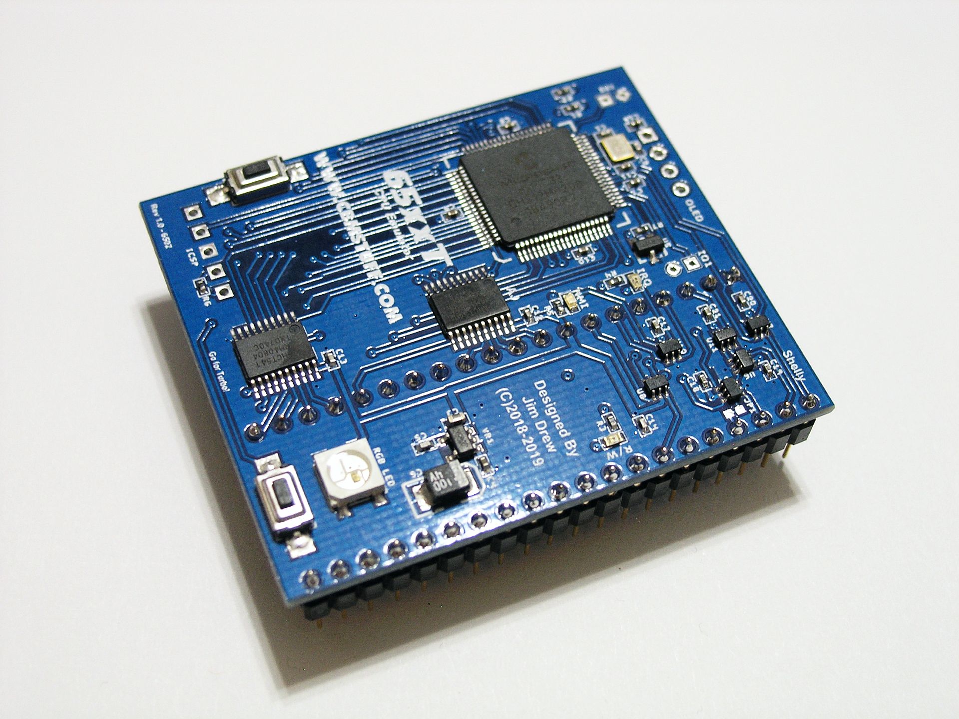

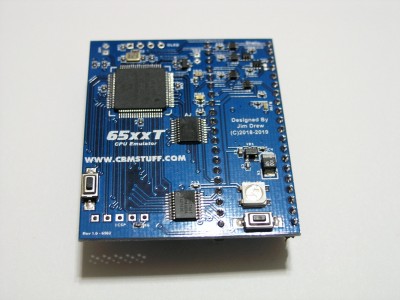

So, here is something that I have been tinkering with for the last 5 years. At first it started out as a board that I could use to test my CPU emulation for a product I am also working on called μDrive. This board (65xxT) emulates a 6502 (currently just the NMOS version, but other versions are planned). It uses a dual core microcontroller running at 90/100MIPS. I have a cache mechanism and variable timing for PHI1/PH2, with PH0 (1MHz) as the reference. I have a memory map table where I can adjust the timing to whatever is needed so that external chips can operate down to 1MHz if needed. You can shadow an external ROM internally (so it is off the bus). Any 6502 code running internally can execute up to 8 instructions per PHI0 cycle. This gives you anywhere from 4x to 48x the performance of a stock 1MHz 6502 and still retains the compatibility with old slow chips. I designed this to just drop in place of a stock 6502 in a Commodore VIC-20, Apple II, BBC, etc. I have been doing all of the development on a simple system - a Commodore 1541 disk drive. RDY and SYNC are not used with that, which made the bring up easier to deal with. I plan on having a 6510 version as well for the C64 (different pin and number of pins, so a different board). The NMOS version has support for all of undocumented opcodes and various bugs and quirks that it has. I could make a '816 version, or even Z80 and other CPU versions at this point - just different pinouts/number of pins.
Currently, the 2nd core is not being used at all and I am wondering if I should ditch it completely. I planned to use it for data manipulation (in the case of the 1541 I was going to use it for realtime GCR encoding/decoding). Can anyone think of any other uses for other systems?

PostPosted: Sun Mar 10, 2019 5:47 pm
SID emulation would be the obvious one. Or a graphics blitter.
PostPosted: Sun Mar 10, 2019 6:13 pm
Yes, something autonomous and asynchronous and complicated: perhaps a graphics output converter from native 6502 system to something modern like VGA. (Probably too difficult to use two cores to implement synchronous subsystems like VIA or CRTC.) Maybe emulate an Acorn-style second processor?

Posts: 107
Hmmm. I never thought about video, but I do have a complete color composite video generator I wrote for the same type of CPU, VGA is even easier. A blitter or some other type of data manipulator would be good. I have 30K of cache memory in one core and 16K of available memory in the other unused core. The 2nd CPU is asynchronous, but can be sync'd to any clock if needed. I don't have an "expansion" port of any kind (well, 2 single pin I/O don't count). I guess I can look at breaking out a few pins in a row for an external port. That way anything in the future could be added (composite, VGA, motor control, etc.) BTW, all of this code is written in assembly and I using literally 3% of the code space. I had to go with a bunch of program memory in order to get enough RAM available.

Thanks! It's been interesting to learn the processor from the inside. I have been programming 6502 in assembly since the late 70's so I knew the quirks from a programmer's stand point, but I didn't know why those quirks existed from a hardware perspective. I forgot to mention that there is a connector for an optional OLED screen. With that and the two push buttons I can single step through the code. The PH0 clock is still used a reference so that PH1/PH2 are correct for the step. One thing I learned with the Apple II is that WOZ used PH1's state as part of the address decoder input so you can't just arbitrarily access the bus without paying attention to the clocks. Some oher systems don't use PHI1 (or even PHI2) to synchronize anything for reads, just for writes.

I was about to mention this sort of thing. Besides doing debugging, you could also maybe collect run-time info -- reference counts and other statistics.

Thanks! Yeah, I have a cycle counter, interrupt counter, etc. Just some basic logging info. One nifty thing that I can do (and have done) is stop the CPU and dump the RAM contents via the serial port. There is a mini OS that lets you communicate through a FTDI interface to a serial console. I have a memory capture/restore function that lets you save/reload a file via serial. When you load the file you can just continue on, much like a PC's hibernate function (or original "snapshot" or "freezer" type cartridges for the C64).
