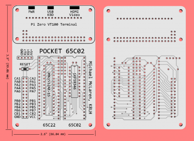

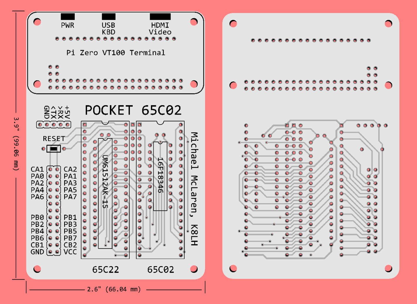

I'd like to include a Pi Zero in a couple of my upcoming projects (preview below)...
Cheerful regards... Mike
