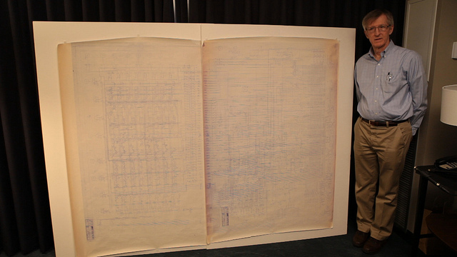

Does there exist a gate-level schematic diagram of the 6502? I was thinking about simulating it in a logic gate simulator, and the most I have found is a block diagram (that I've read may be inaccurate)
I would like to use the 6502 for a class on beginner chip architecture. (Kind of like how C. elegans is used as a model organism for biology)
Pointing me in a good direction would be helpful.

I don't believe a gate-level schematic does exist, although I think at least one gate-level model has been built. There are just a couple of circuit features which need to be finessed, namely the bidirectional pass gates joining the busses, which are not readily handled by normal logic simulation.

I'm going to follow the old dictum that it takes more effort to write something short, so here's a bit of a dump of relevant threads - you'll find pointers to the visual6502 project which should be useful. That project contains the definitive and complete transistor-level description of the 6502, but not in a format that's immediately digestible for other purposes. You will have to roll up your sleeves!
Recently Andrew Holme did some work which is perhaps a very good starting point:
http://www.aholme.co.uk/6502/Main.htm
Check the wiki at visual6502.org - search for hanson, for schematics, and for balazs.
You will find Donald Hanson has got enormous copies of original schematics for the 6502, and has had them scanned, but has not yet published them. Some people do have copies, and there are excerpts on the wiki. These schematics are a mix of transistor level and logic gate level - I would say they are of great historical interest but limited practical use.

Just for fun, here's Dr Donald Hanson with the two sheets (datapath on the left, PLA and random logic on the right):
