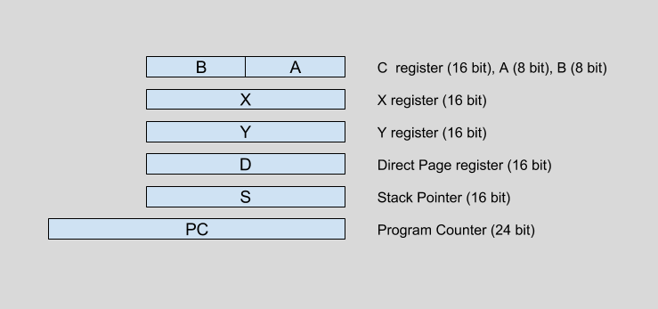

So the thread about how "yucky" the 65816 (and broccoli) is got me thinking: If the problem with this chip is its complexity, maybe we could use an assembler/compiler to create a simpler, cleaner virtual 16 bit CPU on top of it -- a "65V16". Completely hide emulation mode, get rid of decimal mode, make X and Y full-time 16 bit registers, make 16 bit C the default, but expose A and B as ("slow") 8 bit registers. Make the memory seem like it is linear 16 Mb of RAM, with the exception of the reserved "Zero Bank" (so program memory starts at $01:0000). No more PBR or DBR! We would end up with something like this:
We give the C register all the modes we have for A (LDC, PHC, STC, TCX, etc), and reserve a few for A as 8 bit access for I/O chips (LDA, STA, PHA; even LBA, STB, PHB). We can keep an "expert mode" for direct entry of pure 65816 code, for instance for interrupt handling (more on that later). Other than that, those "yucky" details of the chip are hidden. No SEP, REP or XCE, for instance - mode switches are handled unter the hood. The Status Register as exposed to the user is shrunk down to N, V, I, Z, and C.
Obviously the resulting code would be slower, larger, and have less flexibility than native 65816 assembler. We lose the 1:1 of instruction and machine code. However, it would be a lot easier to work with and expecially to code, which means the programmer saves time unterstanding, writing, and debugging the code. I'm guessing that for a lot of us hobbyist types, less complexity might be worth a bit of bloat and slower execution: The limiting factor is the time we can spend at the keyboard.
There are some obvious problems with this scheme, starting with the fact that RESET dumps us in emulation mode again. An assembler/compiler would have to add some boilerplate code to make sure we get back to 16 bit land ASAP. Also, I'm not sure how you would go about converting the virtual linear memory addresses to the hardware segment model, but this can't be a new problem. And I'm sure there are other problems I haven't thought of. I don't think this could be handled with a simple single-pass assembler :D .

scotws wrote:
So the thread about how "yucky" the 65816 (and broccoli) is got me thinking...
What happened to the status register? It would be pretty tough to do anything without SR to tell you what the MPU is doing.
As for getting rid of decimal mode, that would automatically cause me to lose interest.

@BDD, sorry, I just realize I hadn't answered your question: P byte is still there, with the NZVIC flags, but not M or X, and maybe not D (though your objection is noted, so I'm going to leave that open till I have a more clear idea of what this would be). Just forgot it in the graphic.
The D,X and M bits in the status register could be viewed as a kludgy way of extending the instruction register. With a virtual machine why not go the way of other designs and just include additional instructions rather than these control flags ?
Good idea, but I think Scot's goal was to eliminate the extra functionality so as to achieve a simpler, easier-to-understand machine.
Maybe I'm missing something, but it seems the goal could be largely achieved just by inhibiting and then ignoring stuff like Decimal Mode, Emulation Mode and 8-bit modes for index and memory. It would be nice to have 8-bit operations available for string handling, though... :| [Edit:] in the lead post he mentions exposing the 8 bit registers.
That's sort of the idea. A lot of the instructions would be one-to-one, but with the processor stuck on native 16-bit mode, so you don't have to think about x and m and e and whatnot at all.
Actually, I'm wondering if the instruction set wouldn't be almost trivial compared with the problem of how to make the memory banks pretend to be one continuous address space. So far, all I can think of is assembling the code to the point where the bank is about to end, and then insert a bank switch. That pretty much kills the abiliity to use absolute addresses -- everything would have to be labels. Hmm.

Posts: 8505
You would still need the ability to handle data eight bits at a time, especially in I/O. It's the relatively rare I/O device that accepts or dispenses data in multi-byte chunks.
