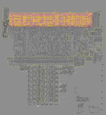

Completed random logic at trans-level :D
Random logic interconnections with other 6502 parts:
Inputs
PHI1,PHI2: timing
Reset0: from RST pin
NMIG: from NMI pin logic
IRQP: from IRQ pin logic
/IR5: from instruction register, to determine CLC/SEC and others
SO: from SO pin, set V-flag
RDY: from RDY pin
BRKDONE, VEC: from interrupt priority logic
2 inputs from predecode logic.
129 lines from PLA.
AVR: overflow out from ALU
ACR: carry out from ALU
Outputs
TRES: reset T-counter
sync: shift T-counter, additionally output to SYNC pin
T0, T1X: first two steps of instruction decoding, to PLA
R/W: Goes to R/W pin and data latch
fetch: Force instruction register to load from Predecode Register
VEC0: to interrupt priority logic, when BRK detected
48 output drivers, to control bottom part.
Also random logic is connected with internal data bus (DB) to exchange status reg (flags).

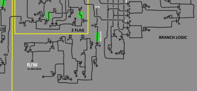

Posts: 201
Added missing R/W distribution tri-state, which goes from random logic to data latch.
(attached)

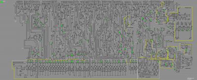

PostPosted: Mon Sep 17, 2012 12:55 pm

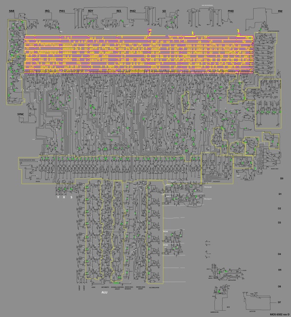

Posts: 201
I have a small break due to HDD failure, but thanks to Google Drive, I quickly restored all data.
Now I can present complete 6502 rev. D schematics. This part of my job is done here:
Image Image
High-resoultion images can be found on google code project.
I uploaded photoshop sources here : http://ogamespec.com/6502/sources.zip (~200 MB)
And updated most interesting parts (ALU and random logic) by recent changes:
http://ogamespec.com/6502/ALU.psd
http://ogamespec.com/6502/LOGIC.psd
(remember, this is not WIP anymore)
6502 addict
PostPosted: Mon Sep 17, 2012 1:31 pm
Posts: 10792
Very nicely done!

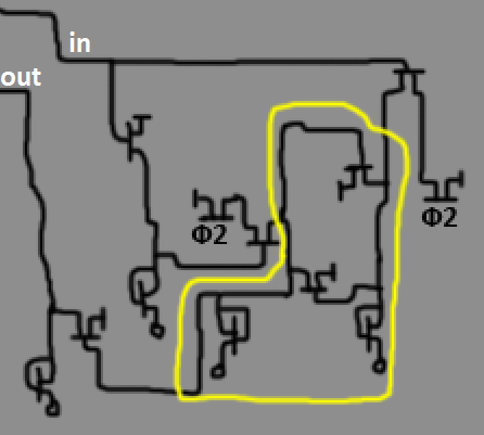

PostPosted: Thu Oct 04, 2012 10:38 am
Posts: 201

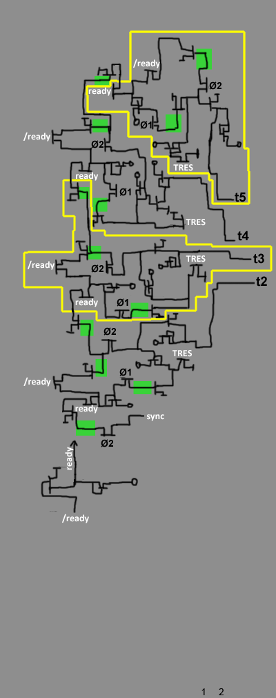

I started to simulate /NMI logic and I have problems, understanding a part of circuit.
Here:
I know, this is called bistable latch, but I dont understand it at all ))
The upper MOSFET is grounded at the same time, as bottom one.. Can you explain me what happen here )
EDIT: I found solution by myself :)
    static nout;
    b = ~(~(in & Ф2) | nout);
    nout = (~(~in & Ф2) | b);
    out = ~nout;
6502 addict
PostPosted: Thu Oct 04, 2012 5:00 pm
Posts: 10792
I agree with the general form: it's a pair of NORs cross-coupled, with a final output inverter.
But I'm not completely sure about all the '~' operators.
I suppose you can see the result in simulation!
PostPosted: Thu Oct 04, 2012 6:14 pm
Posts: 201
Simulation work badly ( And I cannot track the error...
6502 addict
PostPosted: Thu Oct 04, 2012 6:21 pm
Posts: 10792
How about
    static nout;
    b = ~((in & Ф2) | nout);
    nout = ~((~in & Ф2) | b);
    out = ~nout;
