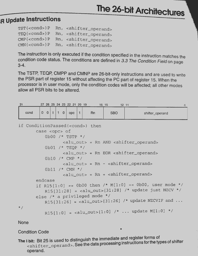

Here's an example, the CPY instruction, where the value of the V flag need to be preserved.
The old 26-bit code was:

I must admit, I struggled to understand how the original code was working. It only makes sense if TEQP r2, pc toggles the appropriate flag bit. I couldn't find a good description of this behaviour in any documentation though.
Can anyone come up with a more efficient pattern?

According to my copy of the ARM ARM (DDI 0100B) the TEQP performs an EOR operation between the operands, and then overwrites the flag bits in the PC with the result, so it would toggle the V bit if it was wrong.

According to http://www.heyrick.co.uk/armwiki/TEQ, the V flag is not affected... and that would also be true if Acorn's code is correct, which it almost certainly is. The Peter Cockerell book at http://www.peter-cockerell.net/aalp/ doesn't mention V as a special case. I wonder if this instruction changed...
This is perhaps something to be checked using VisualARM.

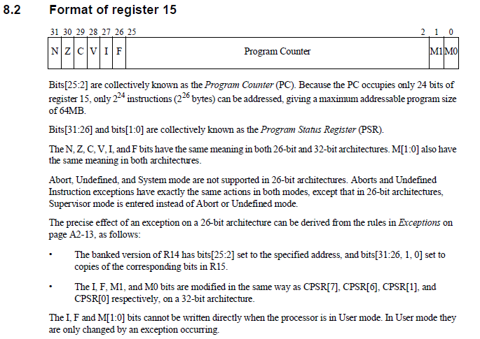

The TEQ instruction does not affect the V flag, but that does not matter here. In this case, the flag bits are copied directly from the ALU output, which is equal to EOR of the two operands (since the TEQ is implemented by EOR).
See also http://morrow.ece.wisc.edu/ECE353/arm_r ... rm_arm.pdf chapter A8.3.
Here's a picture of R15 (PC/flags register).

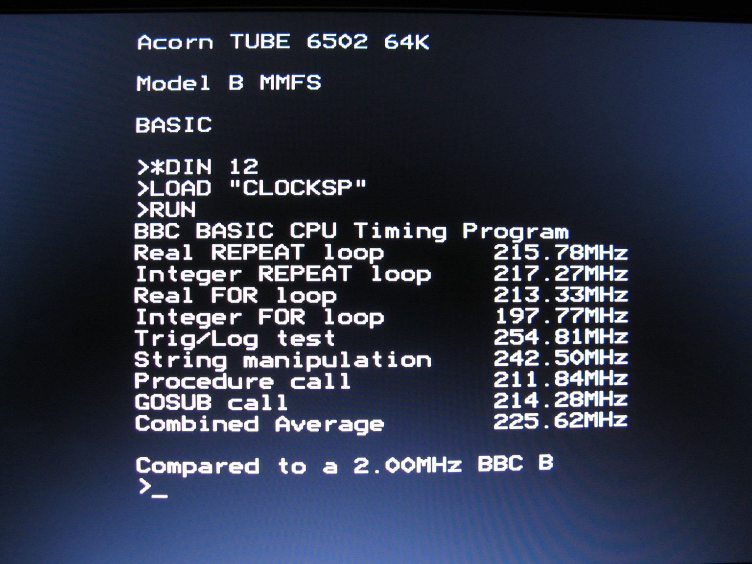

Hi Guys,
Just a quick update to say I've got some updated performance figures for the ARM 65C02 emulation code a few of us have been working on over on the StarDot forums.
The headline figure is now 225MHz on a Pi Zero (1000MHz ARM clock / 250MHz core clock)
