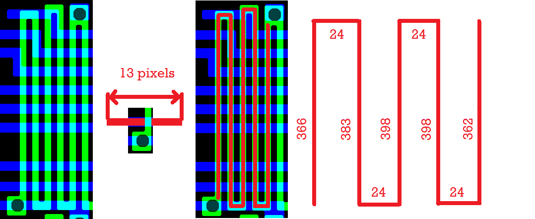

Ok, then. Let's see if I got it right:
DAC resistor picture.
6581R2 > OSC1 waveform DAC > Bit0 > R //not 2R.
Width = 13 pixels
Length ca. 366 + 24 + 383 + 24 + 398 + 24 + 398 +24 + 362 = 2003 pixels.
2003 / 13 = 154.08
15..100 Ohms per square * 154.08 would be 2.311 kOhms .. 15.408 kOhms for that resistor, right ?
PostPosted: Thu Jul 21, 2016 8:08 pm
Yes, 15k Ohms if your poly resistance is towards the high end of the range. Are these circuits designed so that absolute resistances matter, or only resistance ratios?
BTW I remember now that it's traditional to count a corner as half a square, not that it makes a lot of difference.

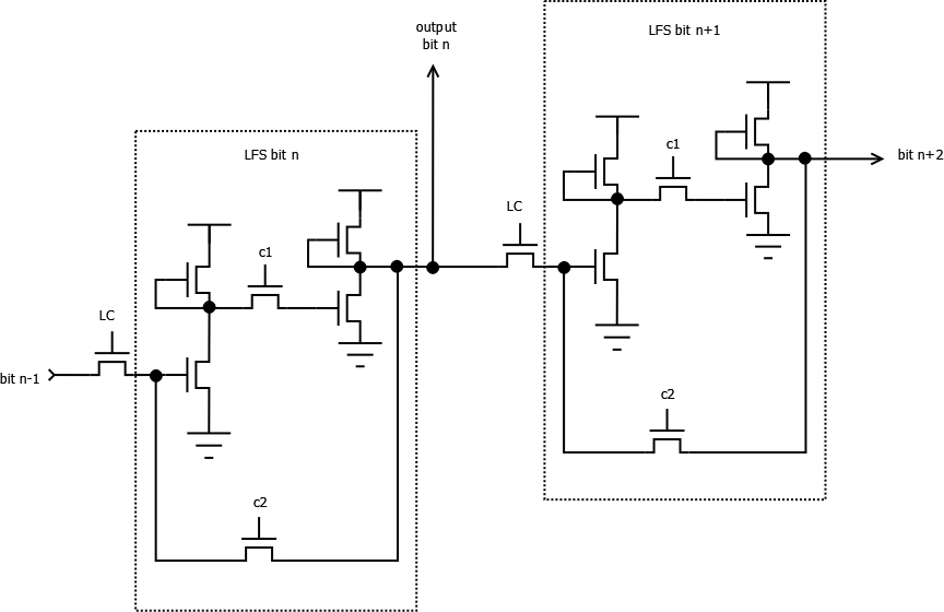

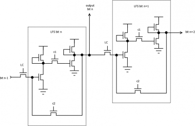

Back to the original question of the noise lockup, I've finally found the answer!
Here's an image depicting two neighbouring bits of the noise register, the first of which is connected to the output.
As we have seen the LFSR gates acts as following:
   | normal | reset/test |  first cycle after
   | cycle  |   shift    | reset/test or shift
c1 |  high  |    low     |         high
c2 |  high  |    low     |         low
LC |  low   |    high    |         low
So this is what happens when the output is driven low by another waveform if it is mixed with noise:
  • during the normal cycles the output is written back to the bit n through the c2 gate, overwriting its value;
  • during shifting and when test or reset line is active the output is buffered into the first inverter of the next bit n+1 through the LC gate, while the second inverter has the input floating;
  • in the first cycle following the shifting or the releasing of the test/reset line the value stored in the first inverter during the previous cycle is passed through the c1 gate to the second inverter and becomes the actual bit output. No write-back is possible during this cycle as the c2 and LC gates are not active.
Thank you for the help :D

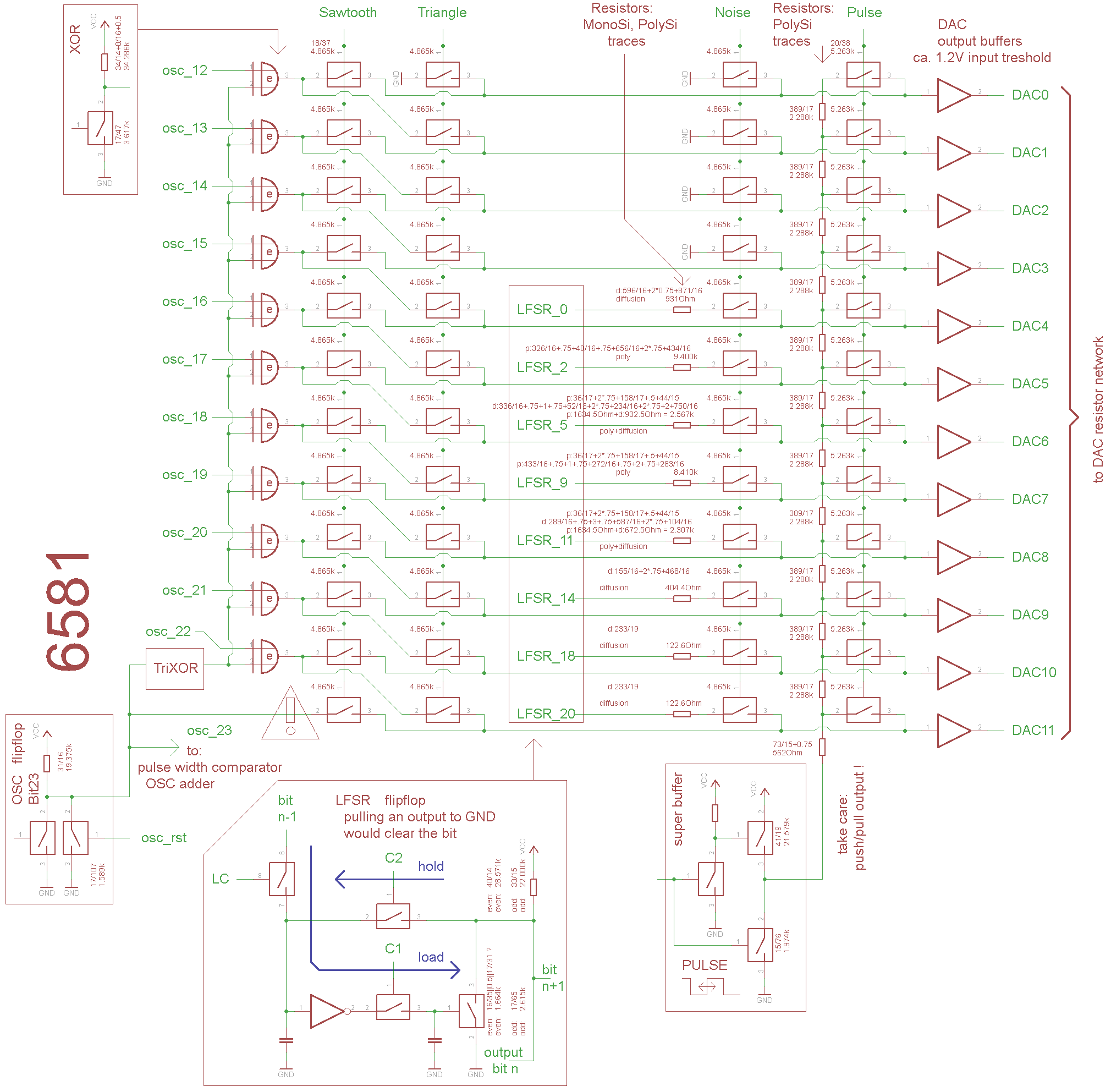

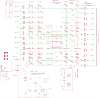

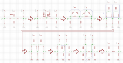

6581 waveform selectors again.

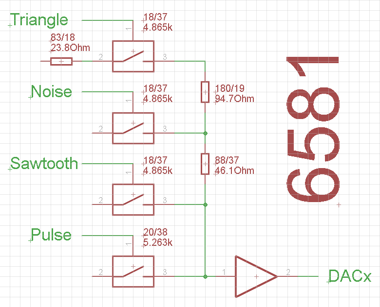

Tried to calculate the resistance values of FETs and traces,
assuming that PolySi has 100 Ohms / square.
From the book:
Metal      ca. 0.1     Ohms / square
Diffusion  ca. 10      Ohms / square
Poly       ca. 15..100 Ohms / square
Transistor ca. 10k     Ohms / square
Omitted the resistance values of the metal traces,
because they would be 4.2 Ohms or less.
Also, I omitted the Diffusion traces between the selector switches,
because having them in the schematic above wouldn't have increased readability...
All the values are roughly estimated "house numbers" for the 6581R2, of course,
and I'm not sure all of those values might be correct. :)
Would suggest that somebody spends some weeks with dissecting the layouts
of the other 6581 revisions and the 8580 to extract the exact resistance values.
BTW:
When comparing different 6581s, there might be some tolerance in the resistance values.
Tolerance might be bigger when comparing 6581R2s from different batches.
And it still might get bigger when comparing different 6581 revisions.

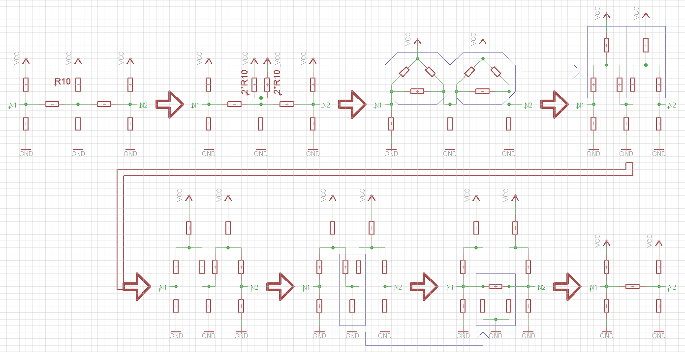

But I think that for an initial simulation of the waveform mixing effects in a 6581,
the stuff above might do.
Basically, when mixing waveforms, we have resistors to GND and resistors to +5V
(the FET transistors at the outputs of a gate or a flipflop),
and resistors in between (the traces on Poly and Diffusion layer etc.).
For the DAC buffers and the LFSR flipflop inputs, threshold voltage
(turning point from logic level low to logic level high)
is supposed to be ca. 1.2V.
What voltage really is there depends on the resistance values...
but we could suppose, that the bigger the resistance of the traces,
the less good mixing the waveforms may work...

Posts: 1431
About calculating the effects of those resistances in and around the waveform selector switches:

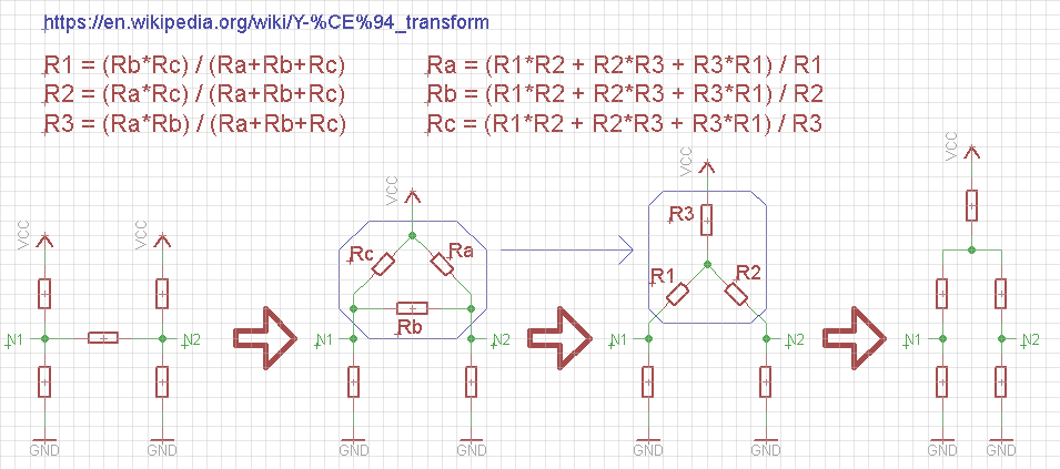

I'm not an engineer... but maybe a "star-mesh transform" could help:
https://en.wikipedia.org/wiki/Y-%CE%94_transform
Maybe this works:
If we happen to have any electrical engineers or a mathematicians in the forum,
maybe they could come up with a better idea of how to do this... :)
