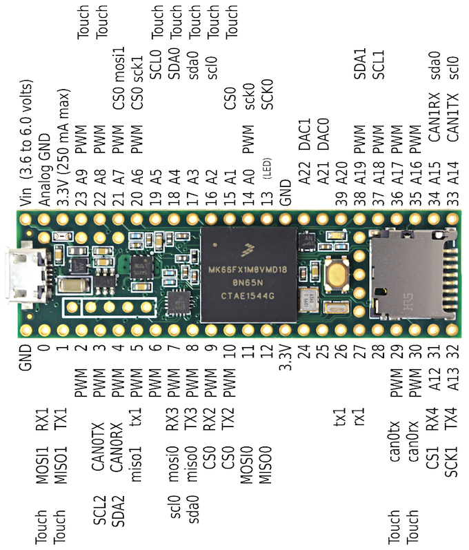

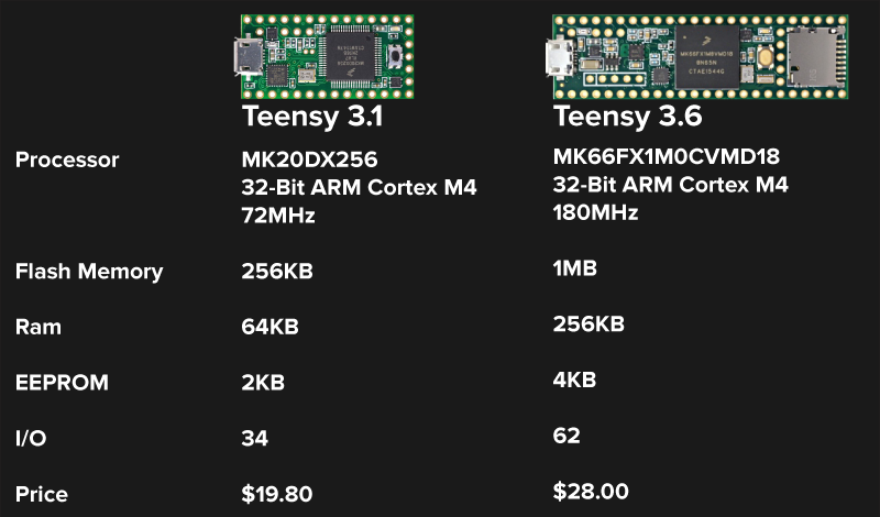

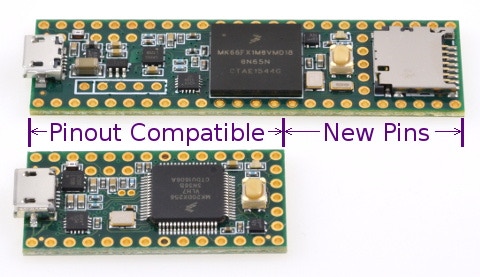

I'm not sure if we have a topic for listing dev boards which are suitable for embedded 6502 simulation, so I'll put this here: there's a pair of new versions of the Teensy boards being kickstarted now, so for under $30 you get a 48 pin DIL-format ARM board with 5V tolerance at 120MHz, or without 5V tolerance and running at 180MHz. Lots of I/Os, lots of RAM, lots of performance, and on-board SD card too. And USB, and ethernet MAC.
Comparing to previous Teensy boards:
As Teensy is now a long-running and viable product family, I see no special risk in this kickstarter.

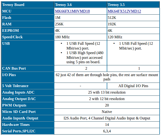

I see the Teensy boards are now a stock item, although they do seem to sell out quickly! The 3.5 is the 5V-tolerant one; the 3.6 has the faster CPU and costs a little more:
https://www.pjrc.com/store/teensy35.html
https://www.sparkfun.com/categories/267
http://www.hobbytronics.co.uk/teensy-boards
https://shop.pimoroni.com/products/teensy-3-5-3-6
