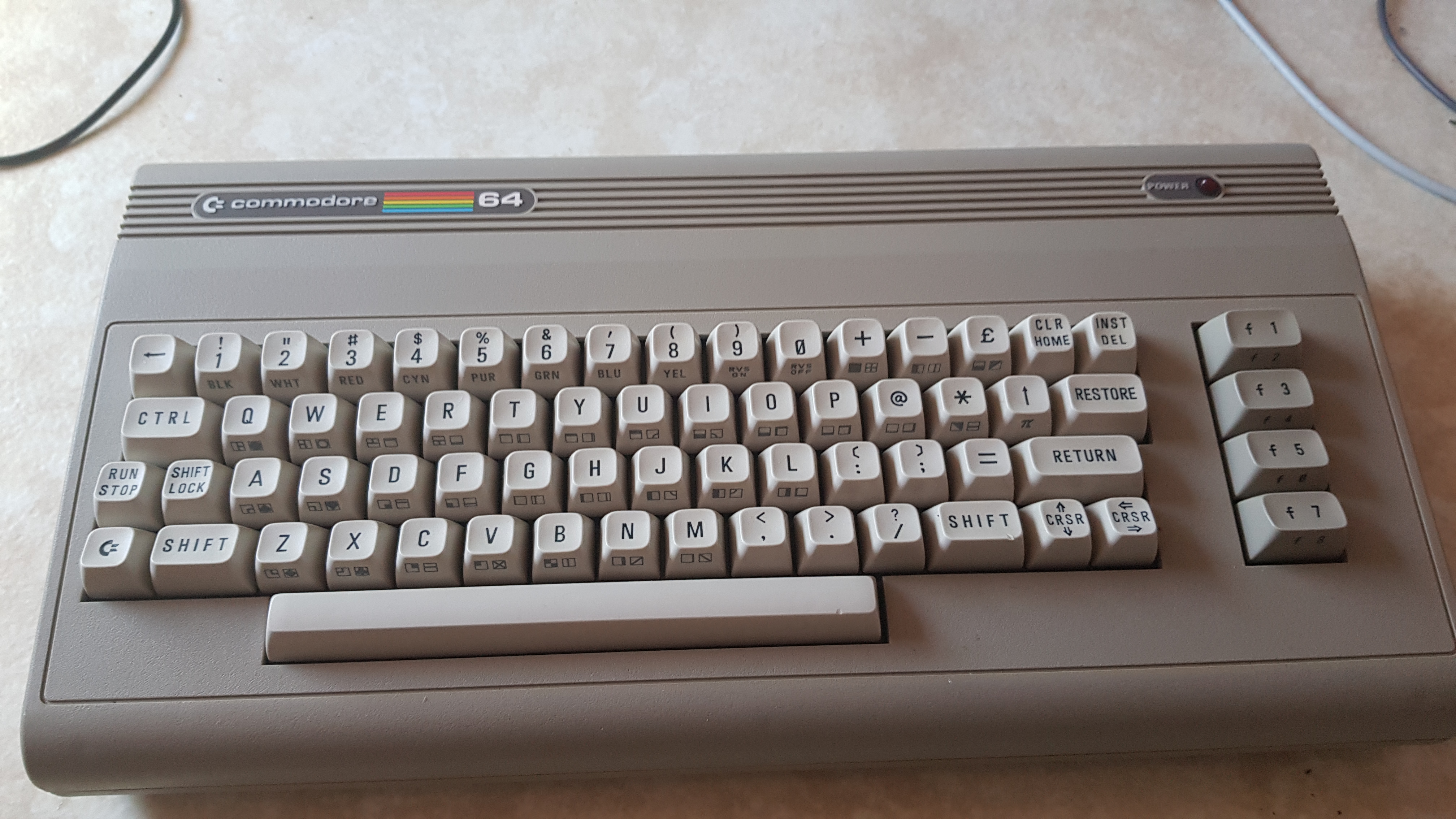

but today wasn't really productive because of something that just arrived in the mail:
it's really clean, but I need a power supply for it so i'll have to look into buying one of those new ones.
but there are many sites and i don't know which are trust worthy/quality.
anyways i don't want to derail this thread into a Noob-C64 thread...
but it could seem like a good testing ground for a 6502 rework... or a Co-Processor. maybe DOOM would run better with that as well.

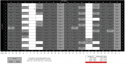

Alright, i have finished all 6502 Instructions and put all of them with their cycle counts in this neat little Opcode table.
The image should be self-explanatory, but i can still say a few things.
I don't have a 65C02V yet, which is why the Average CPI and MIPS are colored red and have "WIP!" next to it.
Also since this CPU is slightly faster than a 65CE02 running at the same clock speed it should mean this would be >25% faster than the regular 6502,
but if you do the math the difference between the Average MIPS/CPI of the 6502 and 6502V is around 19.1%. so i have no idea how they did their math to get to 25%.
anyways, while I have manually tested the function of a lot of the instructions i still wanted to do a full test, so I tried to use this test program but i'm having some problems.
how are you supposed to identify what instruction failed? the Source file says there is a listing to check what failed, but i couldn't find anything helpful...
I'm obviously missing something, but i don't know what.
PostPosted: Sat May 16, 2020 9:44 am
Klaus' test suite stops (well, goes into a tight loop) with a PC value that gives a big clue. You do then need to refer to a listing. See for example the *.lst files in this subdir:
https://github.com/Klaus2m5/6502_65C02_ ... /bin_files
