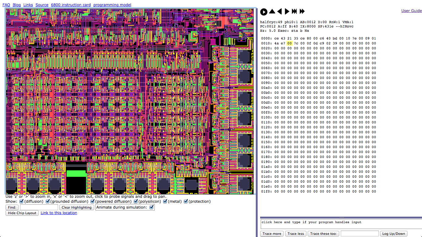

PostPosted: Tue Apr 05, 2011 9:52 pm
... interested in the 6800, because I'd like to see what similarities and differences exist ...
And the answer is... [rather similar looking floorplans] ...much less than I expected! I'm shocked!
I'm now rather less shocked - courtesy of a lot of work by Ijor, we now have a transistor-level simulation of the 6800 and we can begin to see all sorts of differences in detail between it and its kind-of successor the 6502 (and 6501)
See here for the simulation
File comment: Visual6800 online simulator

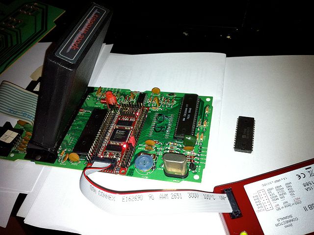

I've posted some pictures on the visual6502 wiki, of the transistor netlist running on FPGA in some vintage hardware: atari 2600, apple IIe clone, vic20, c64.
(Well, partly the transistor level netlist: Peter Monta has written tools to convert much of the netlist to logic gates, and the rest is simulated. Ingo Korb did some clever fine-tuning of the clock delays. The FPGA is on an OHO module which fits directly into the vacant 6502 socket.)
This idea is good running up to about 1MHz so far. It's also passed the Wolfgang Lorenz test suite, with the exception of some unsupported opcodes. (There's more detail on the wiki page.)
