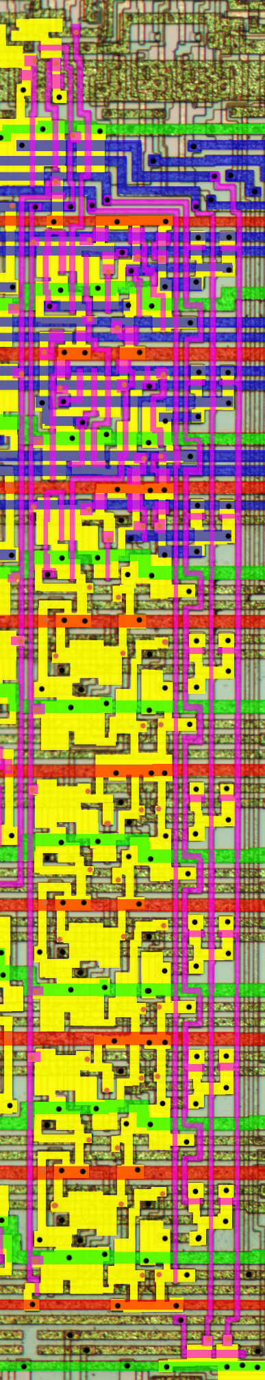

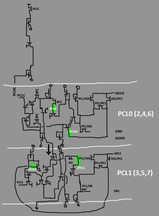

Todays speccy : Program Counter Low part (PCL)
Image Image
I do not know (yet) why these regular structures are different between PCL0/2/4/6 and PCL1/3/5/7.
Also PCL1/3/5/7 saved in latch in inverted form.
Input driver signal is IPC (increment PC).
Output goes from PCLn latch and optionally feed back to PCLSn latch, if PCL/PCL is driven high.
The difference is due to inverters in the path of alternate data bits (eg: PCL1/3/5/7). This is part of a logic optimization that results in a faster incrementer. The incrementer's most critical path is not the individual data bits but the Carry chain that cascades from one stage to the next -- a total of 8 levels. In order to build the fastest incrementer, all efforts must focus on speeding up the Carry chain. To this end it proves advantageous to operate each alternate incrementer stage with active-low logic (where logic low represents a 1). That means adding inverters around the incrementer stage of each alternate data bit, but it effectively allows the elimination of eight inverters from the Carry chain. (I'll try to rustle up a diagram illustrating this.)
edit: "allows the elimination of eight inverters from the Carry chain" (not four)

Thanks for explanation Jeff, I understood - this trick is need to reduce propagation delay.

To reduce propagation delay, yes. In case anyone else is wondering, here's the diagram -- which hopefully is an improvement over my verbal description! The diagram shows the incrementer (just the first four stages) before and after optimization. The optimized version (on the right) uses active-low logic in alternate stages. (I've drawn bits 1/3/5/7 as being the ones that are inverted but in fact it may be bits 0/2/4/6 instead; I don't know.)
The two versions produce identical results, but the unoptimized version is slower because it's obliged to employ inverters in the Carry path. That's because an AND function is required, which must be implemented as NAND followed by an inverter. Of course the optimized version also features inverters, but they don't result in a cumulative delay because they're not part of the eight-level Carry chain.

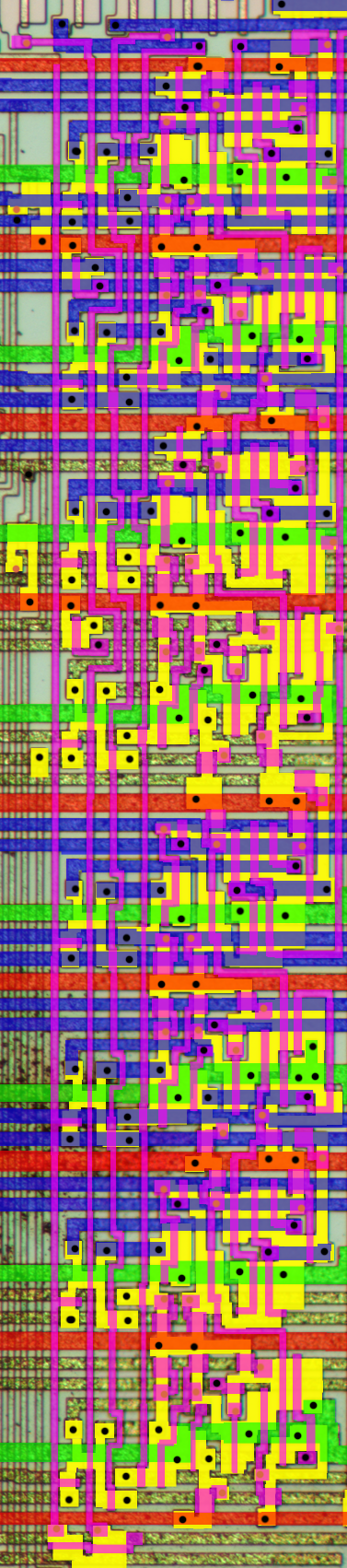

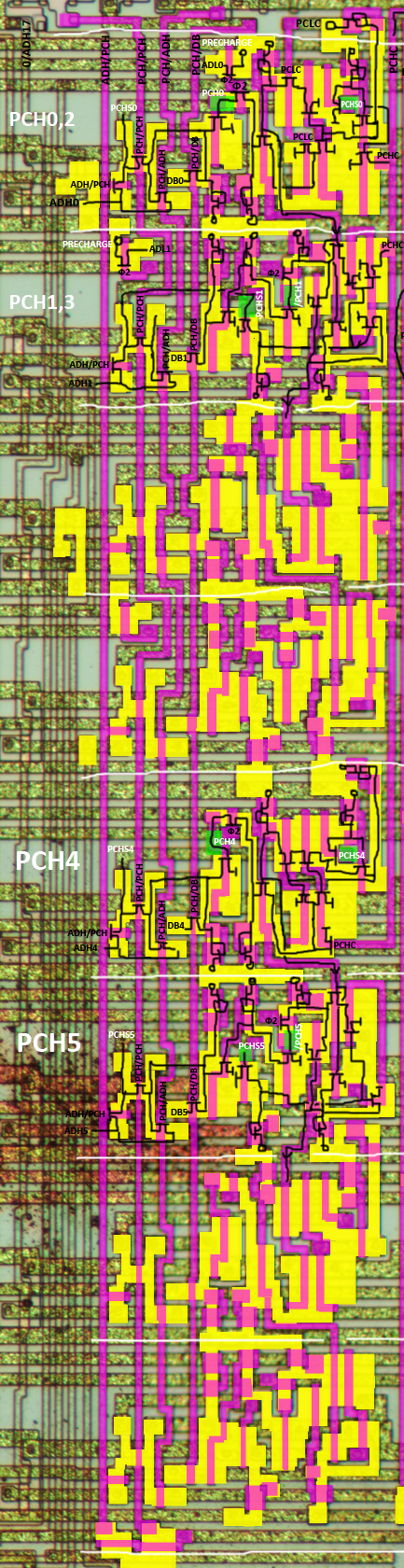

Meanwhile, todays speccy : Program Counter High part (PCH)
Image Image
Nothing unusual here ) Same optimized incrementer, but there is separated increment logic for PCH0-3 and PCH-4-7.
PCH0-3 feeds PCLC and output PCHC, which is routed to PCH4-7.

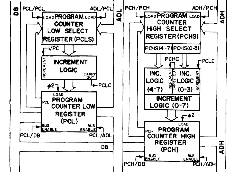

Both schematics perfectly fit in D.Hanson diagram :
PHI1:
if (PCL/PCL) PCLS = PCL;
if (ADL/PCL) PCLS = ADL;
if (PCL/PCL && ADL/PCL) PCLS = PCL & ADL;
if (PCH/PCH) PCHS = PCH;
if (ADH/PCH) PCHS = ADH;
if (PCH/PCH && ADH/PCH) PCHS = PCH & ADH;
if (IPC) PCLS++;
if (PCLS == 0) PCHS++;
if (PCL/DB) DB = PCL;
if (PCL/ADL) ADL = PCL;
if (PCH/DB) DB = PCH;
if (PCH/ADH) ADH = PCH;
PHI2:
PCL = PCLS;
PCH = PCHS;
ADH = ADL = DB = 0xFF
6502 addict

Do you need to invert every other output bit?
Inverting both inputs to an exclusive OR gate leaves the output unchanged.
Lee.
PostPosted: Sun Jul 08, 2012 10:10 pm
D'oh! You're right. In negative logic the XOR function is accomplished by an XNOR gate. So for bits 1,3,5,7 I should've drawn XNOR... followed by an inverter because the output is supposed to drive circuitry using positive logic. Of course XNOR followed by an inverter is the same as simply XOR. I'll fix the diagram. Thanks, Lee.

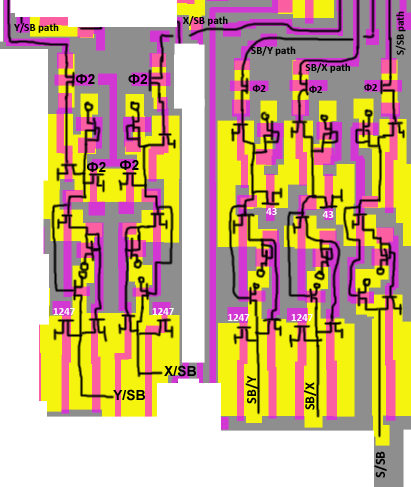

More progress on crazy logic :
I began to understand how it works in general :)
PLA outputs are joined in "groups".
Groups on the left works with X,Y and S registers (resided underneath).
Groups on the middle are ALU related, which feed its inputs.
Groups on the right are branch/flag/compare and (possibly) interrupt/reset logic; instructions related to program counter (PC is resided on the bottom right side of the 6502).
Also there is intense metall layer crosspassing from the left to the right, for addressing calculations purposes.

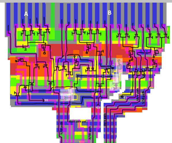

Todays speccy: Random logic A/B groups.
I separated PLA outputs on groups A,B,C,D,E,F,G,H and K.
Here is preview of below schematics :
Top part:
Bottom part:

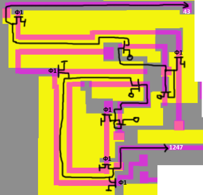

Also there is small logic to generate internal 43 and 1247 lines, which are used on bottom part:
(I do not understand wtf is it... some kind of /Ф1 power-up?)
I labeled interconnections between groups by white text.
