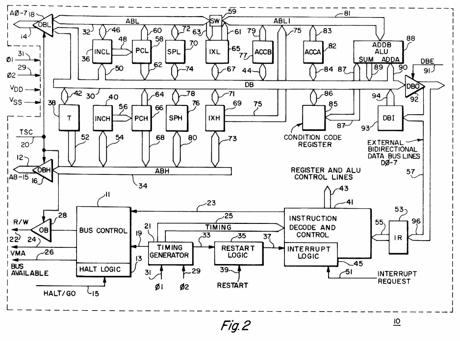

First of all: this is an amazing project. All my congratulations. Concerning the 6800, I found a patent which explains some of the internals of this processor. Have a look for patent 4090236 (e.g. http://www.freepatentsonline.com/4090236.pdf)
Do you think it would be possible to create a readable schematic diagram from the netlists?

Hi - thanks for the pointer to that patent! They are often interesting but not always easy to find. I've uploaded the 6800 block diagram - see below.
We'd like to construct a schematic, and ideally animate it. We might be able to adapt Balazs' giant schematic - there are a few errors and also maybe differences between the two chips. (See 4004.com for some animated schematics.) I'm thinking it's more a question of writing a program to compare the schematic with the layout, and correct the schematic, not a process of deriving schematics from the layout. But I might be wrong about which approach is more practical.

But why the netlist and/or the die image is not public? I realize you don't have a "standard" SPICE, or Verilog netlist. But the netlist in whatever format would be nice to have. What about the die image matrix?
... interested in the 6800, because I'd like to see what similarities and differences exist ... And the answer is...
much less than I expected! I'm shocked!
Actually the difference is expected (or you meant that they loook rather similar?). MOS intentionally made a design from scratch, they knew that otherwise they would be in legal troubles (more than what they eventually were). Also, the original 6800 was enhancement load, not depletion load like the 6502.
