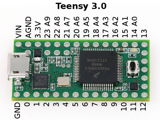

be quick to catch this Kickstarter: from $22 for 48MHz ARM dev board
(will be available commercially in due course.)
Edit: just 16kByte RAM

Teensy it sure is! :o I'm not sure an old dinosaur with claws instead of fingers could even pick up this thing, let alone connect it to anything. :lol:

(As I understand it, there are more GPIOs on the underside. Also, overclocking to 96MHz is possible if you want to live dangerously.)
Now, you're not saying you can't confidently handle a 28-pin DIP are you??!

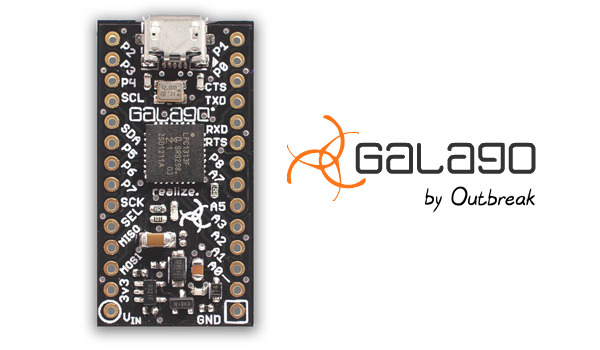

Or, $19 for 72MHz ARM dev board in DIP format (this fellow may have less of a track record, I'm not sure)
Kickstarter open for 13 more days: http://www.kickstarter.com/projects/kuy ... ngs-better
Commercial site (price is $29 here): http://outbreak.co/galago
Edit: only 8kByte RAM
