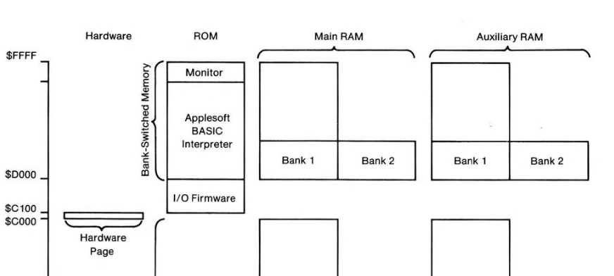

65f02 wrote:
For the Apple, switching in the RAM is mostly a one-way street to my knowledge; it never goes back to the ROM after e.g. you boot up UCSD Pascal.
Going back and forth is quite common. For example, Integer BASIC (i.e., the old II-not-plus ROM image) is often loaded into the language card and DOS provides an `INT` command to switch to that image in RAM, and an `FP` command to switch back to the ROM image. IIRC, it will switch automatically to the correct one when you `RUN` a program from diskette, depending on whether it's an Integer BASIC or Applesoft program.
It's also not just a single 16K bank: the bank switched area is the 12K of motherboard ROM, $D000-$FFFF, so they swap between ROM and one bank of RAM for the top 8K $E000-$FFFF, but the bottom 4K $D000-$DFFF can be mapped to ROM or either of two 4K RAM banks, so you can use the full 16K of the language card. I would not be surprised at all if large systems like Apple Pascal used both the 4K RAM banks at $D000-$DFFF, switching between them frequently.
The IIc gets even more complex. It started with the usual ROM plus two 64 KB banks of RAM, "main" and "auxiliary." This gives you essentially two language cards, with ROM and two RAM banks at $E000-$FFFF and ROM and four RAM banks at $D000-$DFFF. (The attached diagram from the Apple IIc Technical Reference Manual may help to make this arrangement more clear.)
But then it gets even better. The above version of the ROM was the original "255" version which was only 16K; the next version, "0" was 32K and now also bank-switches the ROM (now at $C100-$FFFF in the IIc) when switching between main and auxiliary banks. This happens very frequently during normal operation.
I present all this just as a data point for the kinds of things you'll need to deal with for certain systems; I hope the information can help you in your design.
The Spartan-6 maxes out at 64 kByte RAM on chip (in the 225-pad BGA I am using, the largest I can fit onto the PCB). I have been tempted by its Spartan-7 cousin, which is available in the same package with up to 180 kByte of RAM.
Given that the IIc already has a total of 160 KB of memory without further RAM expansion, and that this sort of design and memory capacity is not unusual for mid-80s 8-bit systems, it seems to me that even the Spartan-7 is likely to have to little capacity for the entire RAM and ROM of some hardware. I guess you need to give some serious consideration to some sort of LRU caching system if you want really wide compatibility.
I do intend to deal with the Apple II disk controller though. No special hardware features there, just heavy (and clever) use of exactly timed code, which needs to be executed at the original speed. I have my "Beneath Apple DOS" book ready to define the required address ranges for the 65F02 memory map.
You may also find Jim Sather's Understanding the Apple II to be handy for this work. The chapter on the floppy controller is the best explanation around, though it may go a bit beyond what you need, and the book is full of good information on other stuff as well.

PostPosted: Sat Jul 04, 2020 7:20 am
Hmm, sounds to me like the IIc, like the BBC Master, would be well out of scope. Not only is there a lot to do, but it's a relatively small audience. (And in the case of the Master, the CPU is soldered in, so it's also a more invasive upgrade.)
It might be interesting to see how much benefit remains if the device has a cache, but has to invalidate it when the memory map changes. But that's even more work.
