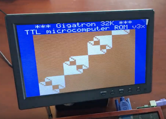

First tests indicate an 8 times slowdown compared to the original NMOS. Not bad for half the transistors, and doing video and sound as well. Video link here: https://youtu.be/9jHlEjr7xJk
More than 2 times faster than the MOnSter 6502 (and that one doesn't do VGA and 4 channels of sound at the same time) :shock:

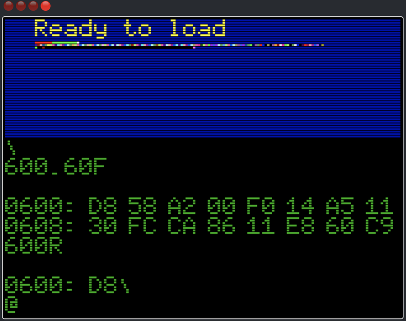

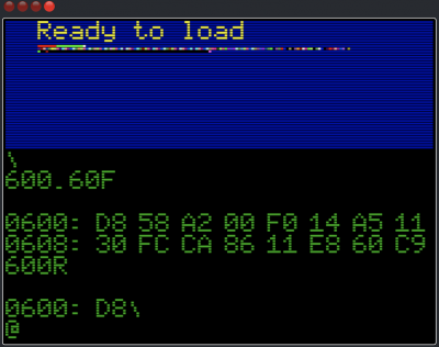

Anyway, after fixing some inevitable bugs I managed to run the original wozmon on the Gigatron. The computer already comes with a built-in WozMon, but that's a rewrite in its own instruction set with extra features (such as backspace).
This is the real Apple-1 wozmon, running in 6502 land. This means you can also stuff 6502 opcodes in memory and run them with R.
Of course I needed to patch the memory mapped I/O. Source here. Changes I made are:
  1. Relocate page because $FF00/$7F00 map in screen memory
  2. Relocate zero page variables
  3. Replace KBD with some 6502 instructions that peek at the serial input register instead
  4. Replace DSP with vCPU code that can draw characters and scroll the screen
  5. Replace the `Blank' separators with a small shift, so that output doesn't wrap around the small screen
Basically, it is an Apple1 clone now.
P.S. I really didn't emulate the `@' cursor (yet?). For the screenshot I typed one...

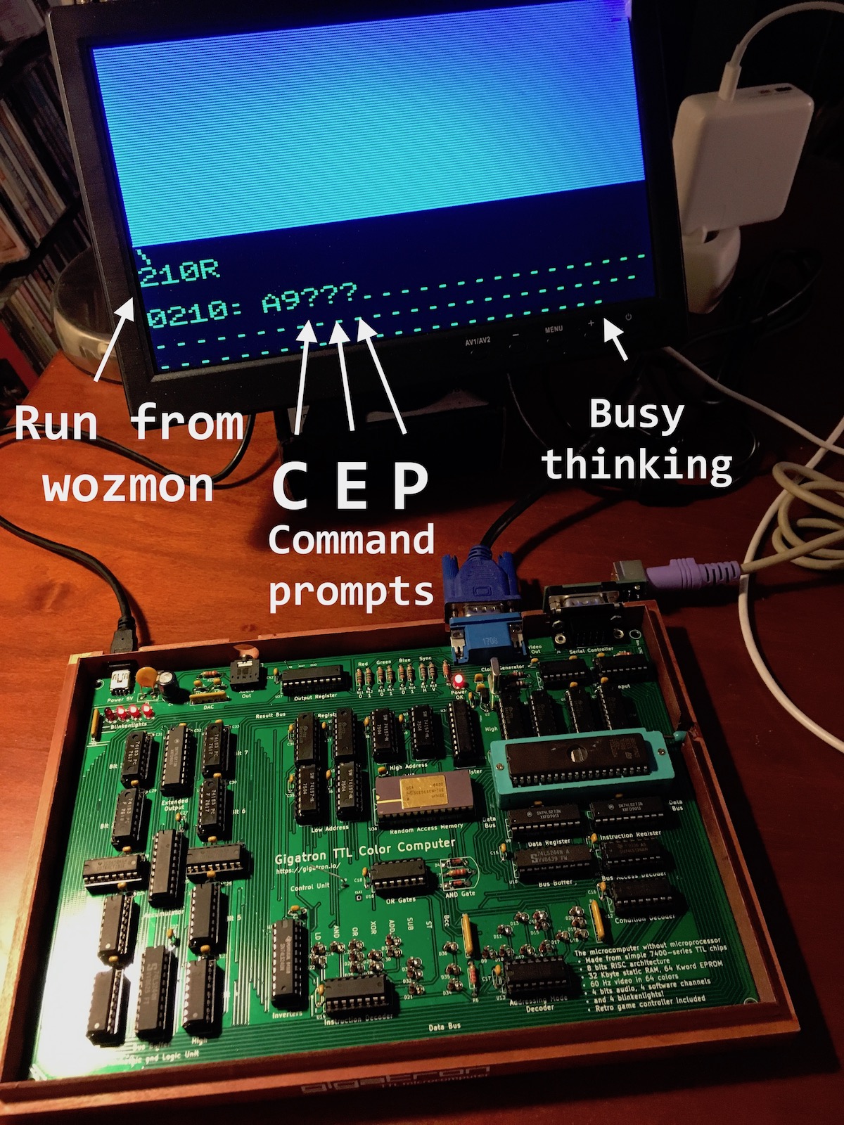

oscarv (KIM Uno) visited tonight, and as a result we have Microchess code running on the "Apple-1" replicated with 34 TTL chips.

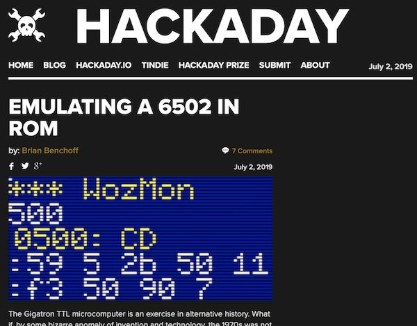

Somebody took notice :-)
