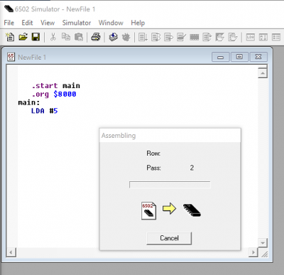

PostPosted: Fri Dec 28, 2018 6:11 am
Posts: 365
I'm back with more complaints :( The following short program reliably crashes on my installation (1.2.14):
     .start main
     .org $8000
main:
     LDA #5
It freezes on this screen for about 3 seconds then exits silently.
PostPosted: Fri Dec 28, 2018 3:42 pm
Posts: 1004
Now, I don't know anything about the Kowalski Simulator. But, what happens to be the values of the RAM at address $8002?
Your program isn't like a C program, that has a defined start and stop point.
Yours loads the accumulator with a 5, and then goes off and does whatever follows it in RAM.
So, it may be no surprise that the program just goes out to lunch after executing your LDA instruction.
For example the memory may all default to 0. And the opcode that has the value of $00 is the BRK instruction. That means your program that's actually executing is this:
8000 LDA #5
8002 BRK
Well, BRK jumps through the BRK vector in the CPU which, perhaps, is ALSO $0000.
Which directs the CPU to address $0000, where we find:
0000 BRK
Which simply goes in to an endless loop, crushing the stack.

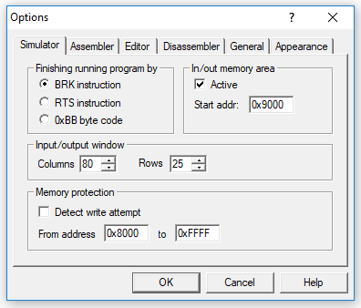

PostPosted: Fri Dec 28, 2018 4:56 pm
Posts: 1748
Location: Sacramento, CA
I could not get that code to crash. Can you send me screen shots of all the options tabs? Might be a specific setup causing it.
Daryl
PostPosted: Fri Dec 28, 2018 6:14 pm
Posts: 8504
     .start main
     .org $8000
main:
     LDA #5
Like Daryl, I tried this and didn't see any problem.
Incidentally, in the Kowalski assembler, a label does not have to be followed by a colon and an instruction can be on the same line as the label. These changes will have a small but definite effect on how quickly the assembler can parse the source code of a large program.

Actually, the program does have defined start and stop points. The .start main pseudo-op sets the starting point for execution and there is an implied BRK following the last instruction. Executing BRK in the Kowalski simulator terminates the program and returns control to the user.
However, the problem being reported by Druzyek is one that is occurring during assembly of the program, not execution.
PostPosted: Mon Jan 14, 2019 1:51 am
Posts: 365
8BIT, you were right. The listing output was pointing to a folder I had moved. It stopped crashing when I changed it. Thanks for the help.
