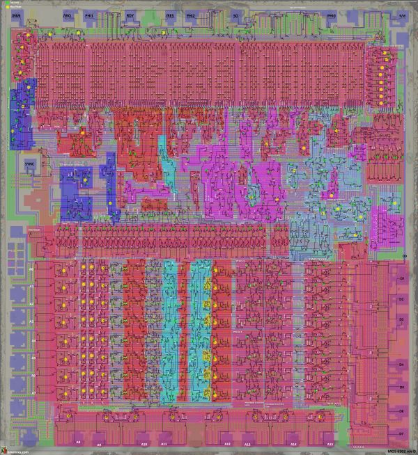

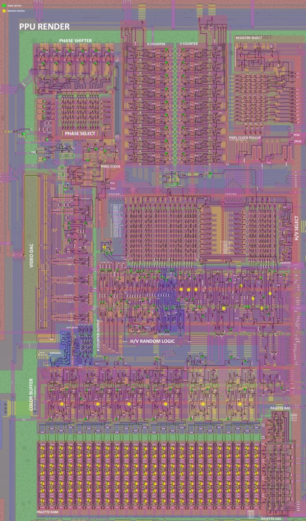

I already simulated some parts of random logic, but attracted by NES PPU :mrgreen:
Technically I understand whole random logic, just need to simulate it carefully step by step.
The reason I turned my attention to the PPU : I want to see some visuals :D Because you can effectively ignore most of custom NES CPU hardware and get some picture just from 6502+PPU bundle.
Here is my new circuit drawing style (transistors over dim background + highlighted regions), to demonstrate complexity of reverse engineering circuits I do :)
I gonna restitch 6502 circuit by the same way.

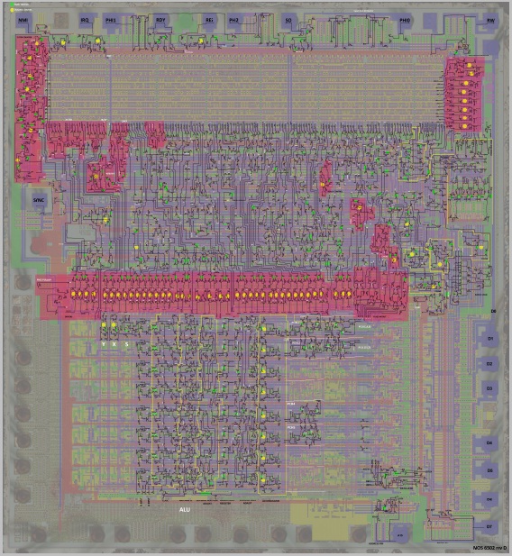

PostPosted: Wed Nov 21, 2012 10:12 pm
Posts: 201
I'm again with you :)
(clickable)
By removing interconnection wires I improved circuit readbility A LOT :)
Also I found and marked many interesting regions :)
Green-square latches are D-triggers, while yellow hexagons are RS-triggers. Random logic output has many of them, as well as flags, intruction register and cycle counter.
6502 addict
PostPosted: Wed Nov 21, 2012 10:25 pm
That's visually very helpful!
A note on terminology: I'd say D-type [transparent] latch and RS-flop (or RS-flip-flop) - but I think often in the 6502 we see a master-slave flop rather than an RS. Having said that, I may be using the wrong terms, and other variations may exist!

PostPosted: Wed Nov 21, 2012 10:46 pm
Is that the other way around? A DRAM cell is a single transistor, which is your green one (a D-type latch) whereas an SRAM has two re-inforcing inverters (usually) which is quite like the yellow one, except I think the yellow ones are clocked - certainly some of them are. In fact, you'll see a difference between the cells of the stack pointer S and the cells of the X and Y registers.

PostPosted: Fri Nov 23, 2012 10:56 am
Posts: 201
Todays speccy: random logic propagation map.
It helps me to construct propagation priority table, to simulate different parts of random logic in correct order.
6502 addict
PostPosted: Fri Nov 23, 2012 12:54 pm
Very nice - and the first time I've seen anything like this!
Does this mean you will also be able to tell us which paths are the longest? That would be after you've sorted out the program counter, I suppose.
(The longest in terms of gate count is not necessarily the slowest, of course.)
PostPosted: Fri Nov 23, 2012 3:09 pm
Posts: 201
If you look down to "driver" outputs, you may notice, that output lines are buffered by PHI2.
So, during PHI2 they are loaded by new values, and during PHI1 they are simultaneously outputs.
Also, most of flip-flops has PHI2 cutoff at the output, so those lines are effectively disabled.
But some lines has except (example is S/ADL), which has valid output during both PHI-stages.
I think, you can assume, that all lines are fired simultaneously and those weird undocumented opcode behavior depends on bus conflict issues.
