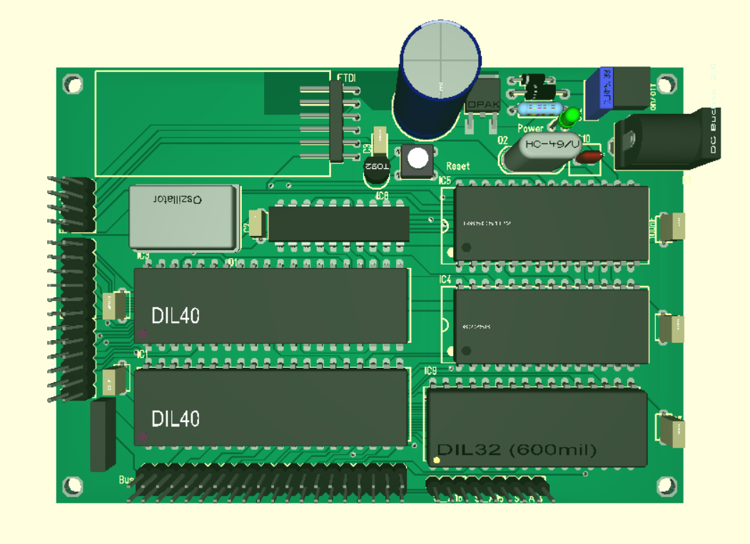

PostPosted: Thu Aug 04, 2022 12:13 pm
Joined: Wed Jul 27, 2022 6:14 am
Posts: 54
to describe the current status,
here is the circuit diagram,
File comment: schematic V1
a 3d version of the board.
File comment: pcb 3d

PostPosted: Thu Aug 04, 2022 12:49 pm
Posts: 1373
First, Welcome and thanks for posting info on your SBC plans. Not sure where you are in Germany, but I used to travel there extensively during the 90's and 2000's... and lived for a couple years in Reutlingen.
So, I've looked at your schematic and browsed your PLD code... here's come comments in no particular order:
- Power supply: as you're using an input diode for blocking reverse voltage, why not replace it with a full-wave bridge? This would allow any polarity on the input and always power the SBC.
- 16V8 PLD: I would recommend using the 22V10 instead. It has more lines and would be a better glue chip. I used one in my C02 Pocket SBC and my Github page has the schematic and code for it.
- R65C51: This is a very old design, really for modems. Note that the older Rockwell parts are not easily found, much less in the higher 4MHz versions. Also note that the recent WDC W65C02 part has a defect with the transmit bit in the status register - there's a long post on the forum here that covers that in gory detail. Using a newer UART/DUART would be a better choice. I (and several others) have switched to NXP chips, mostly the SC28L92 DUART which has two serial ports and a counter/timer.
Also, when coding the PLD, it's best to keep the chip select lines decoded only using the address lines from the CPU. You do need to qualify the Write (and Read) signals for memory and other device to Ph2 clock. Using the 22V10, you can have qualified Read and Write signals, RAM and ROM select lines and 5- I/O selects that are 32-bytes wide.
Note: If you switch to a NXP DUART, you will need an inverted Reset line for that chip. I used a TL7705 which generates both Reset and /Reset and use a DS1813 as an NMI trigger with a momentary switch to trigger a Panic routine.
If you use a larger RAM chip, you can easily change your memory map (just recode the PLD) to get more contiguous RAM memory if needed. Also, where you decode your I/O can make a difference in how you can manage your memory mapping. I always use Page $FE for hardware I/O. This allows a more flexible memory map for contiguous memory.
FInally, best of luck on getting your SBC up and running... there's lots of expertise out here... just ask if you have any questions... and have FUN!
Thanks for the welcome. I live in Hattingen, near Bochum, Ruhrgebiet.
It's only a insurance against reverse polarity. I have always an 9v or 12V dc power supply with the right plug polarity availble. So no need for a full bridge design.
I have a couple of 22V10 and 18V8 here. So i can change this any time. But this is my first cpld aproach. I like KISS.
SC28L92 is only avaible in non DIL packages...
i had a some R65xxx already in stock, so i would like to use them.
i got the idea from Garth 6502 primer. http://wilsonminesco.com/6502primer/addr_decoding.html
All the /CS lines there are qualified with Phi2. I simply put this in CPLD code.
...use a DS1813 as an NMI trigger with a momentary switch to trigger a Panic routine.
thats a nice idea.
In the first designs my io page was located at dxxx, like the c64. But i switched to the actual layout, because i have 128MB Flash (SST39SF010SA), which i want to use as ROM. Than i can have 8 different pages for Kernel ROM. And i have another 12KB addressspace for some kind of interpreter or programming.
I will do that. Thanks for your feedback.

PostPosted: Thu Aug 04, 2022 8:16 pm
Posts: 8433
willie68 wrote:
I had a some R65xxx already in stock, so I would like to use them.
I've used a few different non-WDC brands of 65c51 and never had any trouble with them. In BillO's tests of several different brands all marked 2MHz and 4MHz, they all worked at 8MHz and some at 14MHz and even 19MHz. The only thing I don't like about the 65c51 design is that there are functions that ideally would have been separated, rather than merged, in their controls. It has never been a problem in my uses though. Separating them would have required another register, which would not fit in the scheme with only two register-select lines. I use the '51 regularly up to 115,200bps. The 6551 (non-CMOS) does have one thing I consider to be either a bug or a really idiotic design. I describe these things in my RS-232 (TIA-232) primer here and in the last have of the 6502 primer's page on I/O ICs here. I'm planning on using the SPI-interfaced MAX3100 UART for one I'm slowly working on now. I mention it since you're planning on having an SPI anyway for possible use with keyboard and display. There are tons of ICs on the market that use SPI and I²C.
I got the idea from Garth's 6502 primer. http://wilsonminesco.com/6502primer/addr_decoding.html
Make sure the 65xx I/O ICs' chip-select lines are not qualified by Φ2, and that whichever way you do the RAM, you cannot write to it while Φ2 is down.
Unless you already have something to plug into your expansion port, let me recommend distributing the power and ground connections along the length, for better AC performance, so any given signal's return current path is closer, rather than having to go clear to the end of the connector. The even distribution is all benefits, no disadvantages. I'll put a diagram about that in the 6502 primer. It's also good to arrange the power and ground connections such that if a board gets plugged in backwards, the power and ground still come out correctly so you're less likely to damage things.
Yes, thats part of the CPLD. Only RAM /CS will have Φ2 involved.
Unless you already have something to plug into your expansion port, let me recommend distributing the power and ground connections along the length, for better AC performance, so any given signal's return current path is closer, rather than having to go clear to the end of the connector. The even distribution is all benefits, no disadvantages. I'll put a diagram about that in the 6502 primer. It's also good to arrange the power and ground connections such that if a board gets plugged in backwards, the power and ground still come out correctly so you're less likely to damage things.[/color]

PostPosted: Fri Aug 05, 2022 10:22 am
Posts: 10800
(I've a feeling qualifying the RAM's write enable with phi2 might be preferable. But if so, maybe only when pushing the clock speed, and to do that you need also fast peripheral chips, so it might be out of scope.)

But what you mean is, /CS for RAM without Phi2 involved and the R/W is with Phi2 or should i combine /OE with Phi2 (only for the RAM)?

PostPosted: Fri Aug 05, 2022 2:26 pm
Posts: 54
So, you mean something like this?
header:
Name     W6502SBC_16 ;
PartNo   01 ;
Date     05.08.2022 ;
Revision 01 ;
Designer wkla ;
Company  nn ;
Assembly None ;
Location  ;
Device   G22V10 ;
pld:
PIN 1   =  PHI2;
PIN 2   =  A15;
PIN 3   =  A14;
PIN 4   =  A13;
PIN 5    =  A12;
PIN 6    =  A11;
PIN 7    =  A10;
PIN 8    =  A9;
PIN 9   =  A8;
//PIN 10  =  nn;
PIN 11  =  RW;
//PIN 13    = nn;
PIN 23   =  CSRAM;
PIN 22   =  CSHIROM;
PIN 21   =  CSEXTROM;
PIN 20   =  CSIO;
PIN 19   =  CSIO0;
PIN 18   =  CSIO1;
PIN 17   =  CSIO2;
PIN 16   =  CSIO3;
PIN 15   =  MWR; // /WR only for RAM
PIN 14   =  MRD; // goes to all /OE of ROM and RAM
FIELD Addr = [A15..A8];
CSRAM = ! (Addr:[0000..7FFF]); // 32KB
CSIO = ! (Addr:[B000..BFFF]); // 4KB
CSIO0 = ! (Addr:[B000..B0FF]);
CSIO1 = ! (Addr:[B100..B1FF]);
CSIO2 = ! (Addr:[B200..B2FF]);
CSIO3 = ! (Addr:[B300..B3FF]);
CSEXTROM = ! (Addr:[8000..AFFF]); // 12KB
CSROM = ! (Addr:[C000..FFFF]);  // 16KB
MWR = ! (PHI2 & !RW);
MRD = ! (PHI2 & RW);
simulator:
ORDER: A15, A14, A13, A12, A11, A10, A9, A8, RW, PHI2, CSRAM, CSIO, CSIO0, CSIO1, CSIO2, CSIO3, CSEXTROM, CSHIROM, MWR, MRD;
VECTORS:
/* RAM */
0 X X X X X X X 0 0 L H H H H H H H H H
0 X X X X X X X 0 1 L H H H H H H H L H
/* IO */
1 0 1 1 0 0 0 0 X X H L L H H H H H X X
1 0 1 1 0 0 0 1 X X H L H L H H H H X X
1 0 1 1 0 0 1 0 X X H L H H L H H H X X
1 0 1 1 0 0 1 1 X X H L H H H L H H X X
1 0 1 1 0 1 X X X X H L H H H H H H X X
1 0 1 1 1 X X X X X H L H H H H H H X X
/* 8000-AFFF external Rom */
1 0 0 0 X X X X X X H H H H H H L H X X
1 0 0 1 X X X X X X H H H H H H L H X X
1 0 1 0 X X X X X X H H H H H H L H X X
/* ROM */
1 1 X X X X X X 1 0 H H H H H H H L H H
1 1 X X X X X X 1 1 H H H H H H H L H L
1 1 X X X X X X 0 0 H H H H H H H L H H
1 1 X X X X X X 0 1 H H H H H H H L L H
