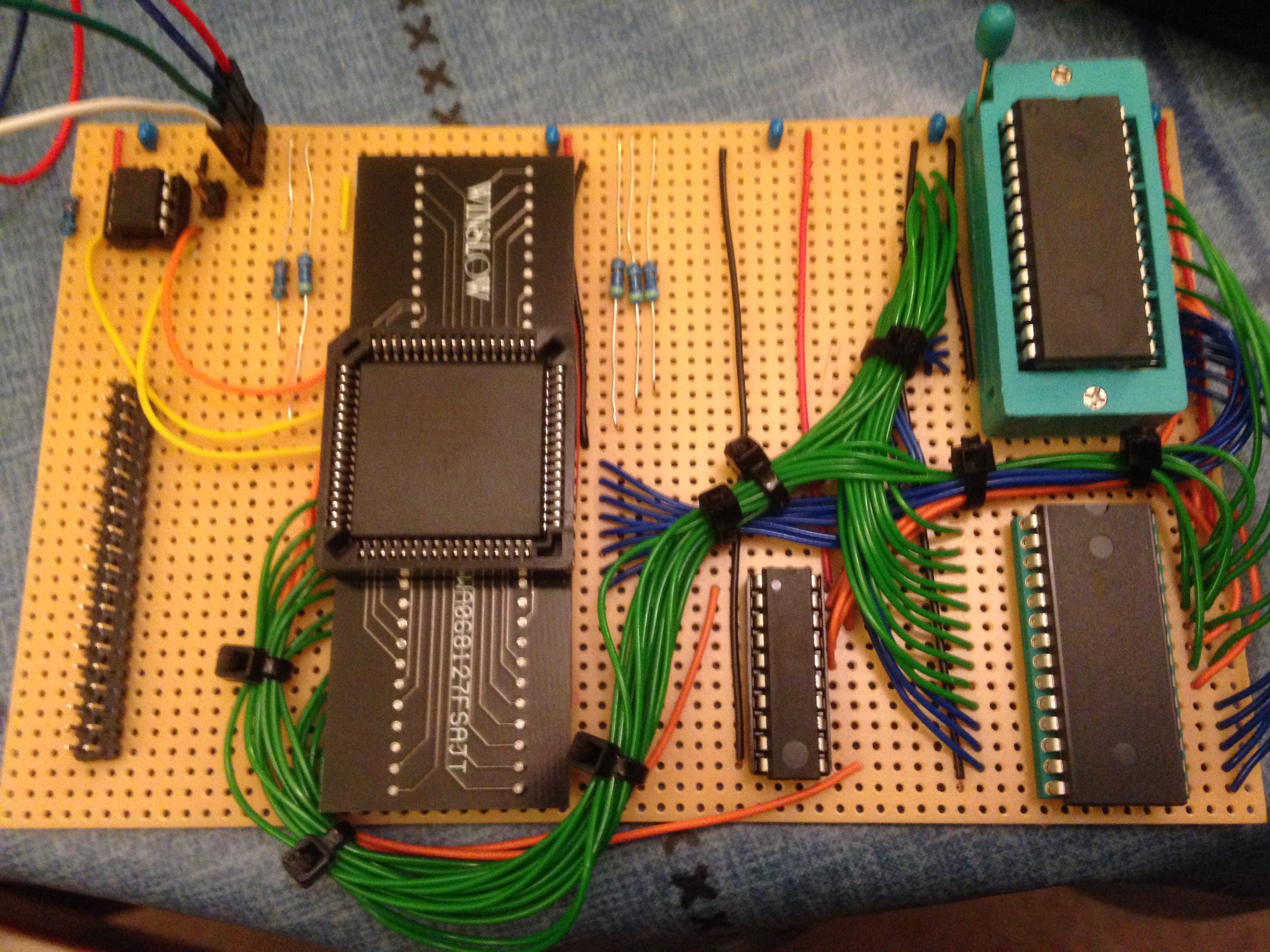

Using my PIC based clock generator/reset monitor (and a some pull up resistors for the IRQ and NMI pins I forgot to install) I managed to get my W65C134 SBC to boot the WDC monitor application.
The board has 32K SRAM and 32K EEPROM (in the ZIF) which it can self write. I need to add a jumper somewhere to disable the self write to stop accidental damage.

Haven't tested the 8Mhz mode yet - needs a jumper on the header beside the PIC.

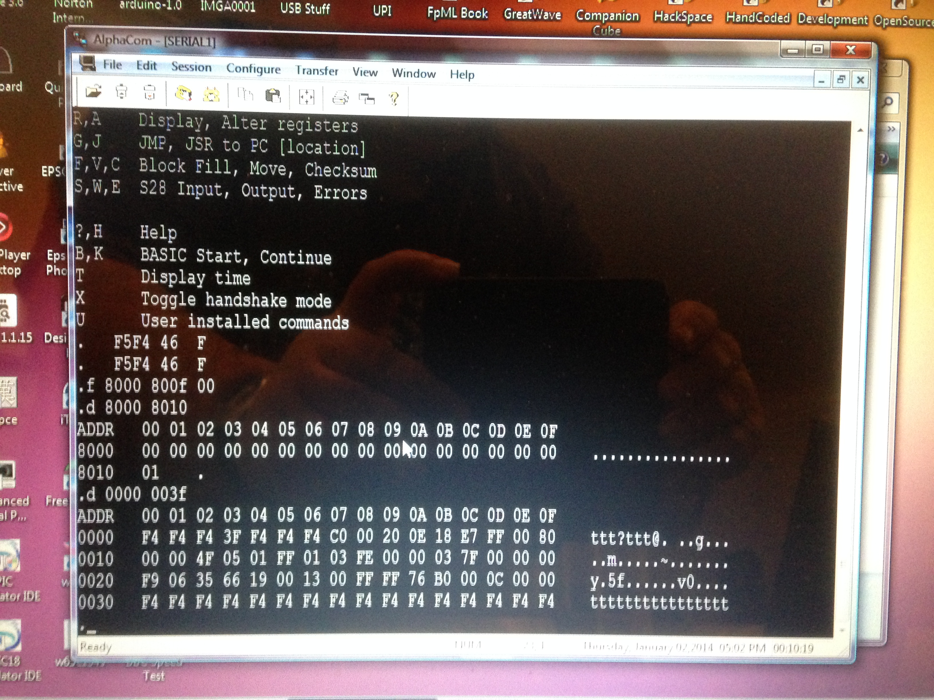

Boots into the WDC monitor as the EEPROM contains random garbage.
File comment: The WDC monitor connected thru a Windows USB terminal.

I am also interested in this device from WDC but I'm thinking of putting a 64KBx16 Ferromagnetic SRAM or nvSRAM as the memory components. Are you using a 3V power rail? Are you using their SIB for the USB? I see a 4 pin plug in the upper left of the Proto Board. Also, it looks like you aren't using the FPGA that their Designer Board uses so I assume you decoded the memory space differently - can you post your schematic? Thanks, Dave Colglazier 8)
The 4-pin connector at the top connects to a PL2303 USB Serial adapter which provides logic level RXD/TXD signals along with power (currently I'm using 5V). Not tried it at 3V3 yet. Need to check the data sheets for the RAM and EEPROM.
An ATF16V8C GAL takes all the chip select outputs from the 65C134 along with PHI2 and WEB to produce /OE, /WE and a /CE for RAM and EEPROM.

Thanks for the quick reply. My purpose for using the F-SRAM x 16 would be to bring the 65C134 up in a preliminary mode to set up the hardware decoding, language loading and then switch to the other 8 bits to run it in one of 4 emulation modes...specifically, AIM/SYM/KIM & custom memory maps. I'm not sure the internal monitor mode has a real use in my product but it's interesting that it is there and actually works...I like the idea of a serial interface.

The WDC monitor can write to any memory location including the EEPROM but you need to poll the chip to see when the page write has completed or use a timed delay so you can't load S19 records directly. I tested it by putting a few bytes at $8000 manually.
There's nothing to stop you loading a larger amount of data into RAM and then copying into the EEPROM under the control of a program that manages the page writing delays.
The monitor commands and source are available on the WDC download page at the bottom I seem to remember.

The chip has an internal boot ROM at $F000-$FFFF but changing a bit in the BCR register disables this and the region is read from the external bus. The boot ROM looks for the string 'WDC' at locations $8000 and $0200 and if found jumps into the code at $8004 or $0204. Once in your own code you can desable the internal ROM to take control of the full memory area.
I thought my EEPROM was working but I'm not so sure at the moment. I'm not seeing any active low chip select pulses on its pins. More testing is required to see what I've done wrong.
My design uses the chip select outputs (CSx) to determine RAM vs ROM but access but I'm going add a connect to A15 and an input for write protection. As all my decoding is done in a GAL I just need to connect a new inputs, change the CUPL and reprogram the GAL.
WDC list the verilog for thier CPLD in the W65C134 Development board manual and they seem to be using the address buffer to derive chip selects rather than the chip select bits.

Reprogrammed the GAL to use A15 for RAM/ROM select and added a write protect input. I can now reliably access the EEPROM and have started writing code to replace the monitor. Currently I'm fighting with the UART which is transmitting garbage.

Nothing special. RXD and TXD are just connected to the four pin header with (5V,TXD,RXD,GND) which connects to the PL2303 adapter.
Mine did not run until I had memory installed and pull ups on NMI/IRQ1/IRQ2, The attached PDF shows the effective state of my board. The connections to my GAL are a bit different - I was using the chip select outputs but I don't think they work very well so now I use address lines (as WDC do in on thier development board) instead.
