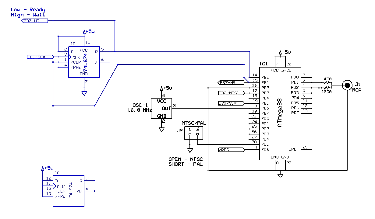

I finally got around to updating my website with the Text Video V2 information. Sorry it was so late. I included an optional Flip-flop that will help with the handshaking issues discovered and discussed previously.
File comment: Schematic
Here's a link to my page:
http://sbc.rictor.org/vid2c.html
This uses a 6522 serial shift register and PB7 for handshaking. Other forms of IO can be used as well, including RS-232, parallel, and SPI. Contact me if you have any questions.
thanks!
Daryl

Has anyone tried to run Daryl's Text Video Display on an Atmega328p? I'm trying to port this over and I'm not having much luck. The source code assembles fine with the m328Pdef.inc file replacing the m88PAdef.inc file, however no signal on PD1 and PD2. I'm guessing these chips are different enough that the source code will not work as is, however, given that Grant Searle used the same code as the starting point for his display (which runs on a 328p), I figure this should be possible. I don't have a lot of experience with assembly on the AVR chips, so if anyone has actually done this already, that would make life so much easier.
 Post subject: Re: Text Video Display
PostPosted: Sun Jan 07, 2024 4:00 pm
Posts: 1685
Location: Sacramento, CA
The ATMega328P can be used to replace the ATMega88 as it also has the USART in SPI mode feature.
Be sure the set the fuses for an external oscillator. Also, the interrupt jump table is different and uses JMP vs. RJMP opcodes.
I don't have a 328P to test on and no time to research it more, so I'm not sure if there is anything else that would need to be changed.
Good luck with your project.
