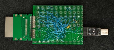

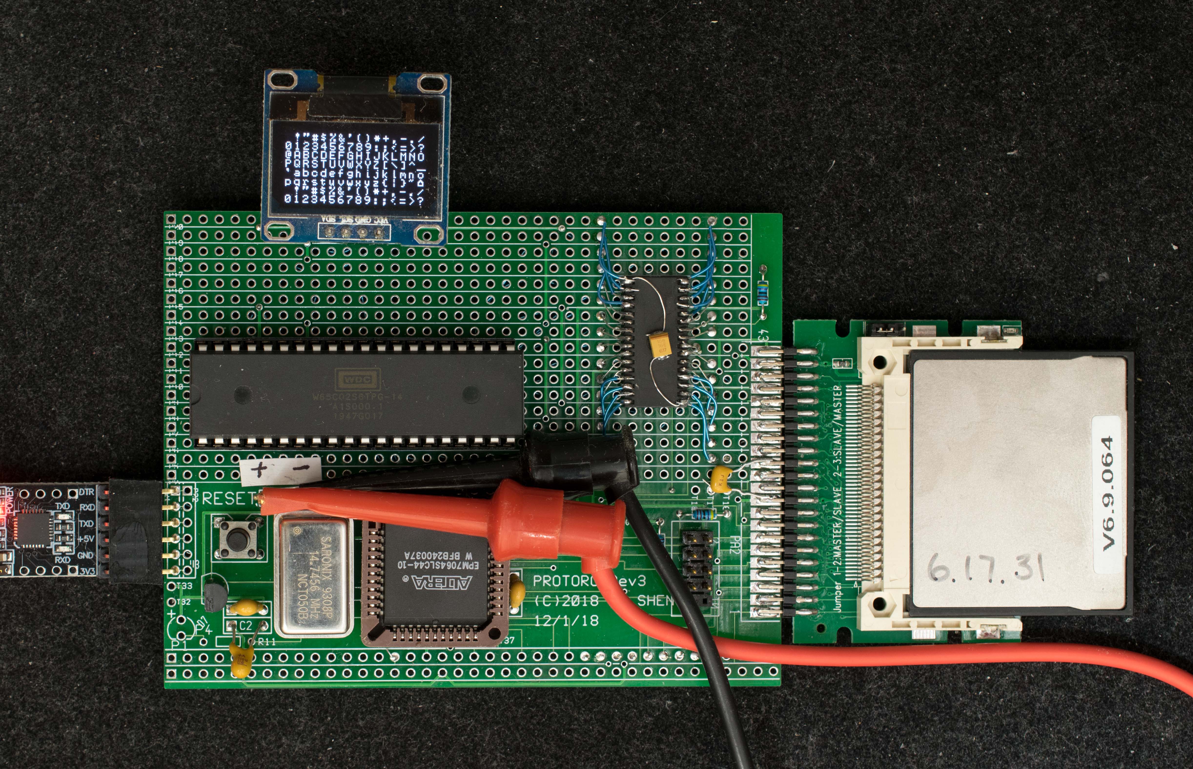

Finished wiring between RAM, CPLD, and 6502. This should allow me to power up and serially load program into RAM and execute. First I'm going to walk away for few hours to screw up enough courage to power it up.
Attached are schematic of the prototype board as well as the schematic of the CPLD.
CRC65_CPLD_top.pdf [42.24 KiB]
Downloaded 71 times
CRC65_prototype_schematic.pdf [25.47 KiB]
Downloaded 74 times
PostPosted: Fri Jan 08, 2021 1:08 am
Posts: 1110
After a nice lunch followed by a nap and puttering around in the garden, I decided to start out with a very simple program in ROM that just write an incrementing value to the transmit bit-bang register. Because data bit0 goes to the transmit output, I should see the output toggle every loop. This is just between CPLD and 6502, nobody else is involved.

And it works! With 7.37MHz clock I see a 409KHz square wave, 1.22uS high and 1.22 us low. 1.22uS is 9 7.37MHz clocks which is how long it takes to execute a loop. Current consumption is about 80mA.
Now a more complicated ROM program that reads a serial input, use it as the seed to run RAM diagnostic and toggles the serial transmit output when RAM diagnostic is completed correctly.

That works, too. So that means the wirings between 6502, CPLD, and RAM are correct.
This is also a good time to check the design margin. 14.7MHz clock works; 18.432MHz works; 20.28MHz works; but 22MHz failed, so the results are very similar to Proto65. I will now run the CRC65 at 14.7MHz
Now I need to go back to the bench and finish wiring up the compact flash interface and work on the bit-bang transmitter software. A good day!

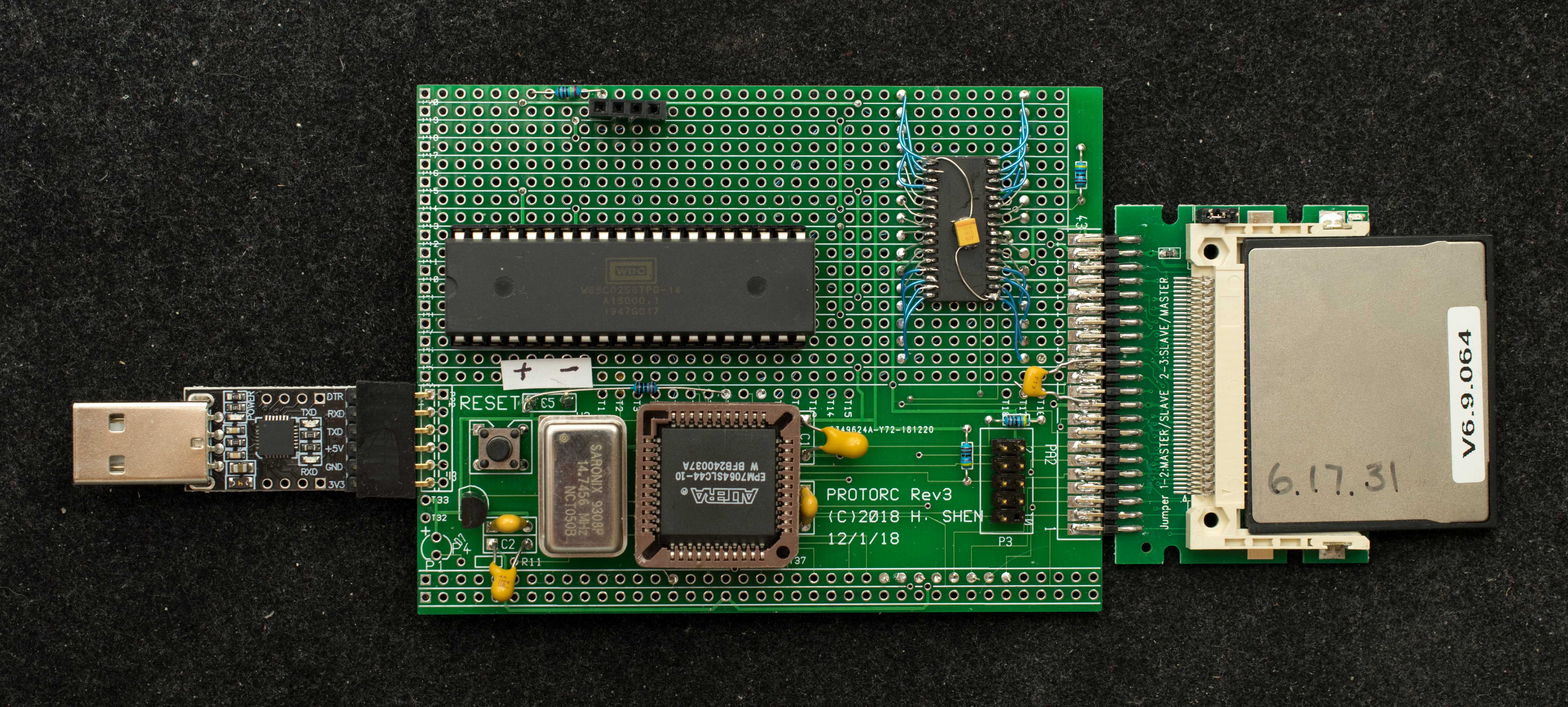

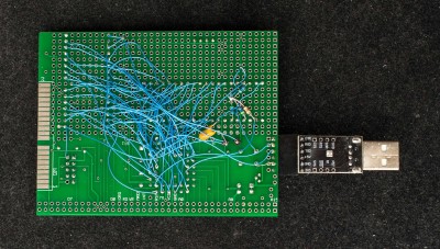

Wiring on the CRC65 prototype is now completed. The attached photos show the component and solder sides of the completed CRC65 prototype. Now testings begin.
The first order of business is to write the bit-bang transmitter. The CPU clock is 14.7456MHz; each bit of 115200 is 128 clocks. Here is my attempt at creating 128 clocks delay for each bit of the data transmitted.

When writing to the bit-bang address, data bit 0 goes to the transmitter output. So the basic idea is putting value to be transmitted in the accumulator and write to the bit-bang address; the least significant bit will go out (serial transmit is least significant bit first, most significant bit last), rotate right, wait the appropriate time and write to the bit-bang address again. Do this 8 times to transmit the serial data. But wait, I also need to do the start bit and stop bit. Start bit is always 0, so I clear the carry flag and rotate left so carry is now data bit 0 (bit 7 is now in the carry flag). I can do the above algorithm 9 times to transmit start bit and 8 data bit. I then finish off by transmitting the stop bit and wait 1 bit time before exiting. I measured the serial transmit with a scope and it looks right. I do have to make sure the branch instruction does not cross page boundary.
With the bit-bang transmitter working, I wrote a little program to examine the Master Boot Record of the compact flash. Below is what it read. It looks right; bootstrap loader in first 14 lines; partition entry at 0x1BE and boot signiture of 0x55AA at the end.
Another good day.

Once the CF interface and bit-bang transmitter are working, the rest fall in place quickly.

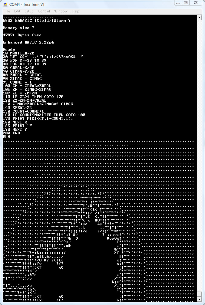

EhBASIC is updated with bit-bang transmit algorithm so is the 256-byte Intel Hex file loader. So now EhBASIC can be loaded and run. An utility to write bootstrap program to CF's master boot record is also updated so now it can save EhBASIC in CF disk and retrieve it on next power cycle. The first picture shows that after a reset EhBASIC is copied from CF to memory (each dot represents a 512-byte sector copied), and EhBASIC running. I copy-paste the mandelbrot program and it ran in 77 seconds.
I measured the CF file transfer rate: EhBASIC resides on 21 sectors (10.5KB) and it took 17.3mS to transfer it from CF to memory. So that's about 600KB/sec. This is CF operating in PIO mode.
Last but not least is the I2C interface. It is working.
There are more testings to do, but I'm ready for pc board layout.

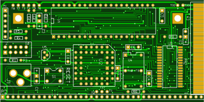

I layout the pc board for CRC65 and sent it off to JLCPCB yesterday. JLCPCB must be working the weekend because this morning I received their production notification and the picture of my board. This design meets my goal of 50mm X 100mm 2-layer pc board so I can step & repeat the Gerber artworks and produce 2 boards per 100mm X 100mm panel thus driving the board price to $0.5 each. But of course, the shipping cost will probably triple that.
I'm doing speed test of the prototype CRC65 and verify it can still run to 20.28MHz. However, the CPLD is already fully utilized so some functions have to be sacrificed to enable the additional logic needed for 20.28MHz operation. So while I do have the speed margin for higher clock, CRC65 design in current form is locked to 14.7MHz clock.
I'll look into Klaus' 6502 function test and work on a monitor for CRC65 while waiting for the pc board. Homepage for CRC65 is under construction here: https://www.retrobrewcomputers.org/doku ... asmo:crc65

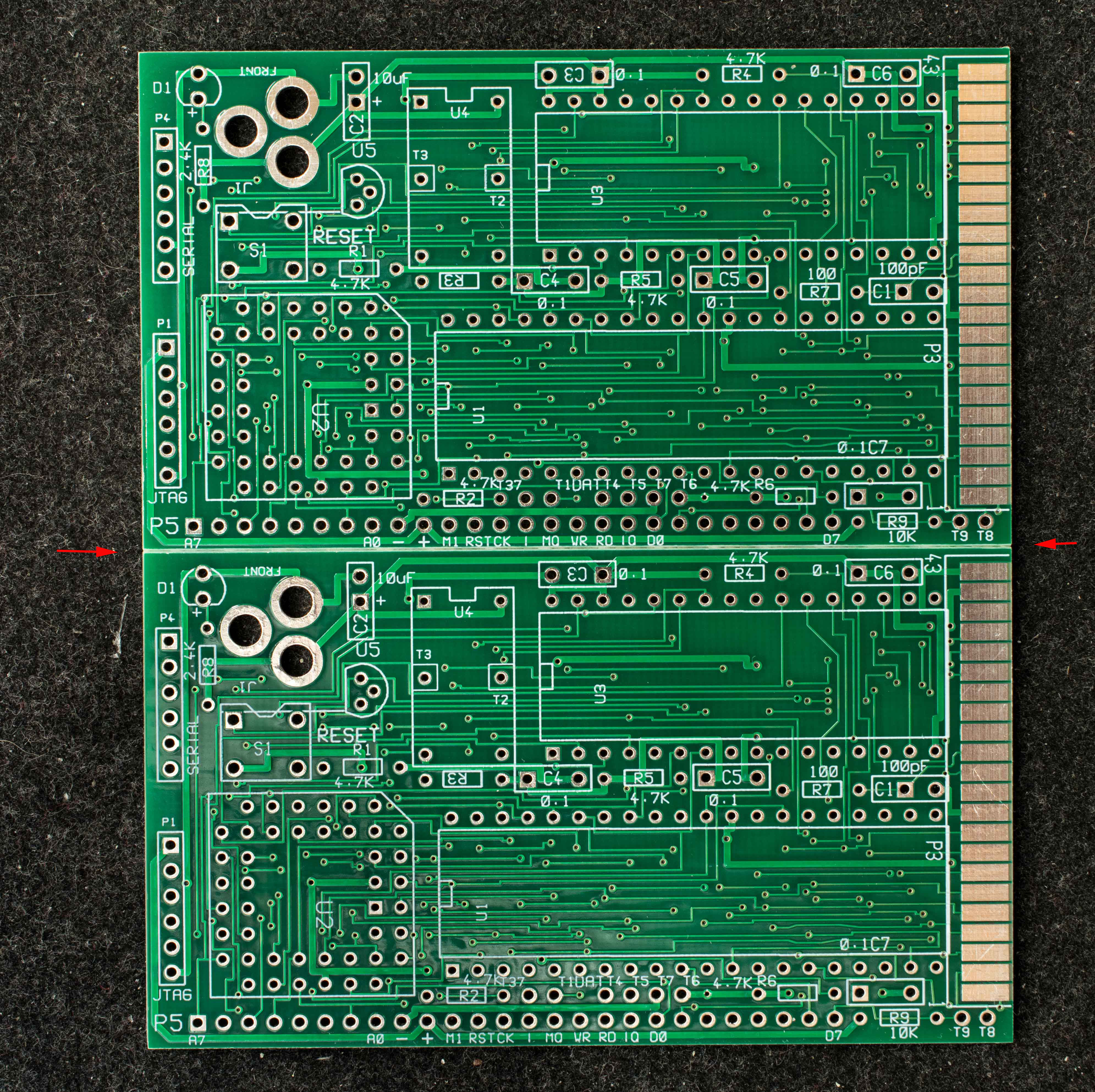

I layout the pc board for CRC65 and sent it off to JLCPCB yesterday.... This design meets my goal of 50mm X 100mm 2-layer pc board so I can step & repeat the Gerber artworks and produce 2 boards per 100mm X 100mm panel thus driving the board price to $0.5 each. But of course, the shipping cost will probably triple that.
Given that they do five 10×10 boards for $2, doesn't the price per board come down to $0.20 each? They also do an almost-as good price of $5 for ten 10×10 boards, which seems to increase shipping by only about 25%, so there's some savings there, too.
But how do you separate the boards when you do this? Is there a way to specify some sort of "crease" on these panels when you make the doubled-up Gerber files, or do you just leave a bit of space and saw them apart very carefully?
Unfortunately, JLCPCB charges "engineering fee" for making V-cut. The last time (about a year ago) the engineering fee was $8, so it makes no sense to go with JLCPCB for multiple designs on a panel. I use SeeedStudio instead. Seeed charges $4.90 for 10 panels up to 100mm x 100mm and does not charge extra for v-cut, but SeeedStudio is quite a bit slower than JLCPCB so I only send them designs that have been proven and pick the cheapest shipping. Even in that case shipping is still more expensive than pc boards.
V-cut is shallow cut with a V-shape router bit on both sides of a pc board. The router bit cut about 20% into the board, weaken it so a steady bending pressure will snap the board cleanly in half. Zoom in around the red arrows and you can see the v-shape groove. V-cut is also quite thin and can be precisely placed right next to circuitry. In the picture the thick traces next to v-cut is 0.025", there is not much clearance between V-cut and trace.
